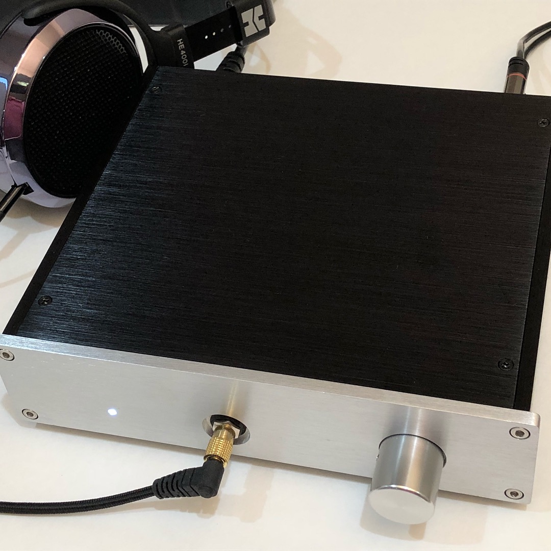

Edit April 5, 2019: Beautiful example of this amp in finished case by Avtech23 on post 425.

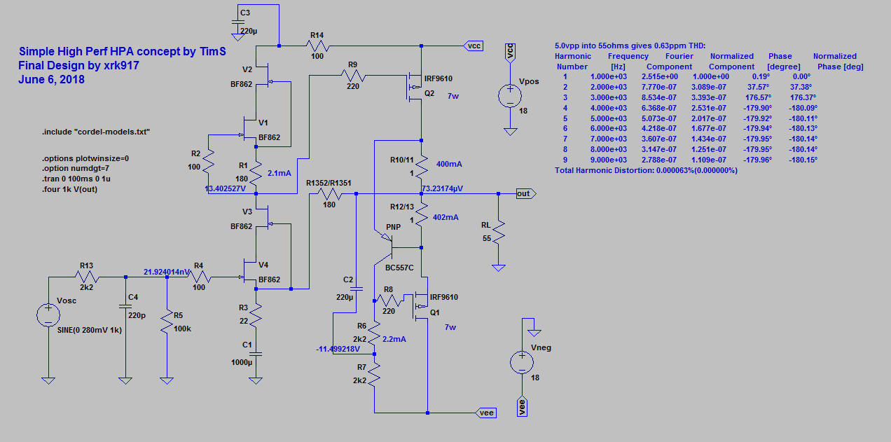

This is a simple DC-coupled high performance SE Class A headphone amplifier design by member TimS who has approved this GB. The design uses four cascoded BF862 JFETs on the input stage. They provide compensation for DC drift and the amp has stable DC offset of less than 5mV. The design has a dynamic CCS, reminiscent of an Aleph to provide good efficiency and low distortion from two P-channel MOSFETs in the output stage. Simulations show very low THD in the sub 1 part per million (PPM) range for 5vpp into 55ohms for a 400mA bias current. At this bias, the heat output is about 14w per channel and allows it to be used as fleawatt speaker amp and able to drive 8ohm speakers to 1.5w with 0.004% THD. Increasing the main source/drain resistors to 2.7ohms sets the bias current at about 115mA and this has very good performance. I built a hand etched prototype and measurements and listening shows a very powerful, dynamic, and clean sounding amplifier. The GB boards will be high quality 1.6mm thick with 1oz copper and ENIG gold finish with blue solder mask.
Here is LTSpice schematic and DC setpoints for simulation:
685372d1528348988-simple-performance-dc-coupled-class-hpa-sub-ppm-thd-tims-simuation-schematic-v3-png

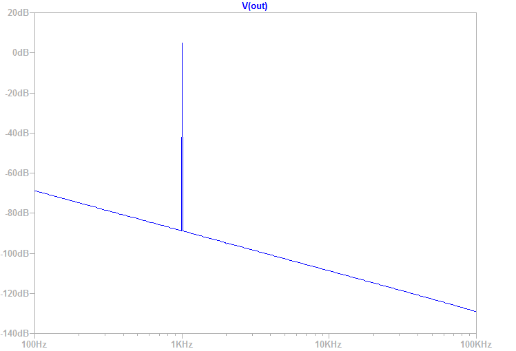

Predicted FFT for 5vpp into 55ohms with 400mA bias:
685377d1528349430-simple-performance-dc-coupled-class-hpa-sub-ppm-thd-tims-simuation-400ma-5vpp-42ohms-fft-png

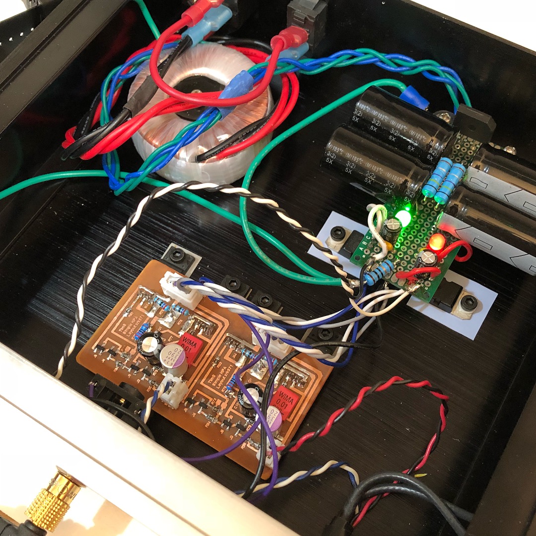

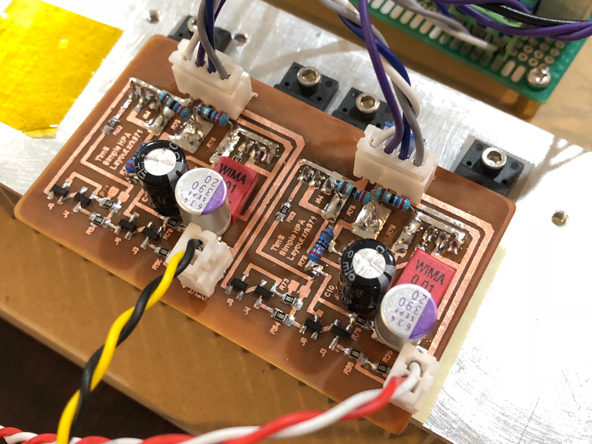

Here is hand etched prototype:
685071d1528188075-simple-performing-headphone-amp-img_1820-jpg

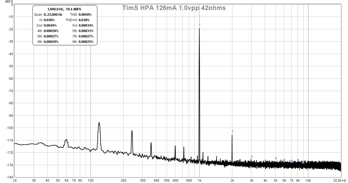

Measured FFT for 115mA bias 1vpp into 42ohms - note that elevated H2 distortion peak is probably a component choice of the lwo cost prototype (cheap steel leads on resistor, etc). I am quite sure that a proper amp using a real PCB and all high quality resistors and MOSFETs will be superior:

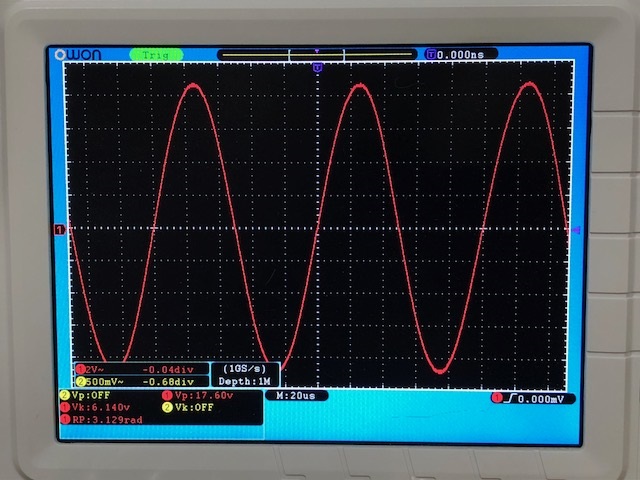

Measured 1kHz sine wave at 17.6vpp for 115mA bias and +/-15v rails for almost 1wrms into 42ohm load
685358d1528329940-simple-performing-headphone-amp-tims-prototype-test-1khz-sine-clip-jpg

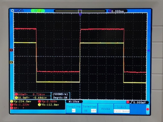

10kHz 2.5vpp square wave - nearly perfect performance with no overshoot, or ringing:
685359d1528329940-simple-performing-headphone-amp-tims-prototype-test-10khz-sq-wave-jpg

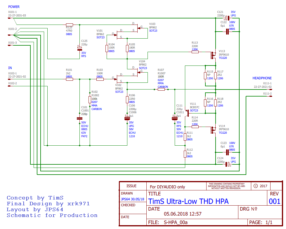

This is the schematic for production PCB:
685373d1528348988-simple-performance-dc-coupled-class-hpa-sub-ppm-thd-timss-final-schematic-prod-png

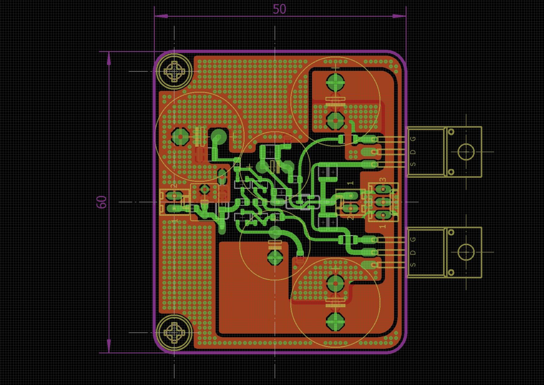

Here is the layout by JPS64:
684977d1528123994-simple-performing-headphone-amp-5b1e1d98-a607-4bd7-bf35-7935a0f78e8d-jpg

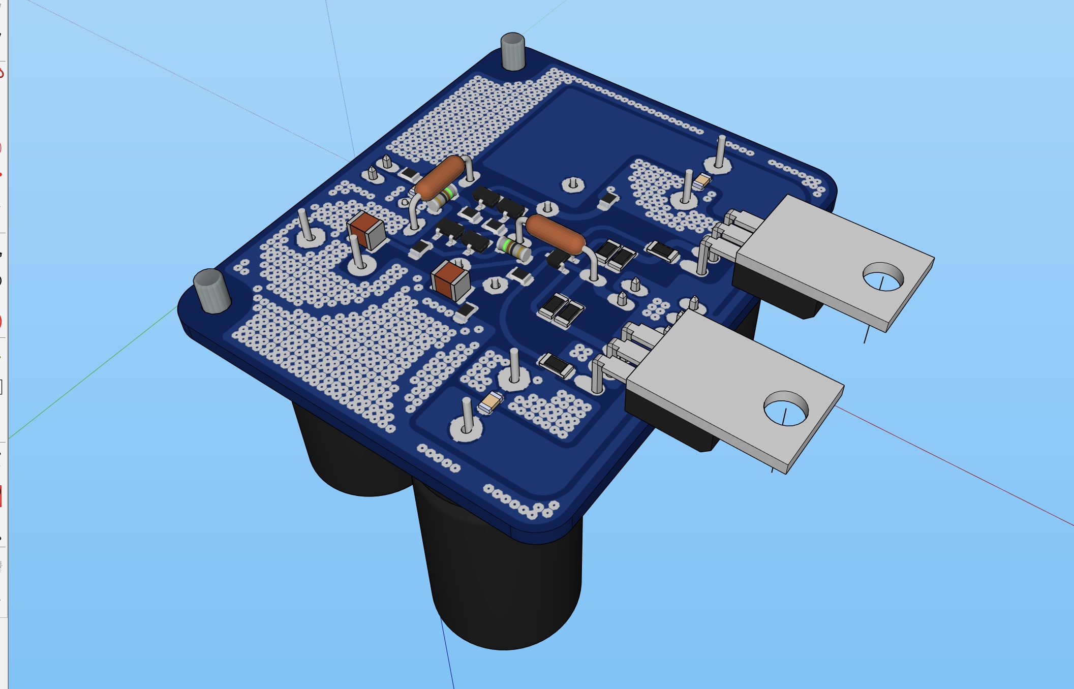

Here is 3d render of PCB with components (bottom side):
684975d1528123994-simple-performing-headphone-amp-c96ec7c8-2f08-47ac-9ea1-90d82ccd56d6-jpeg

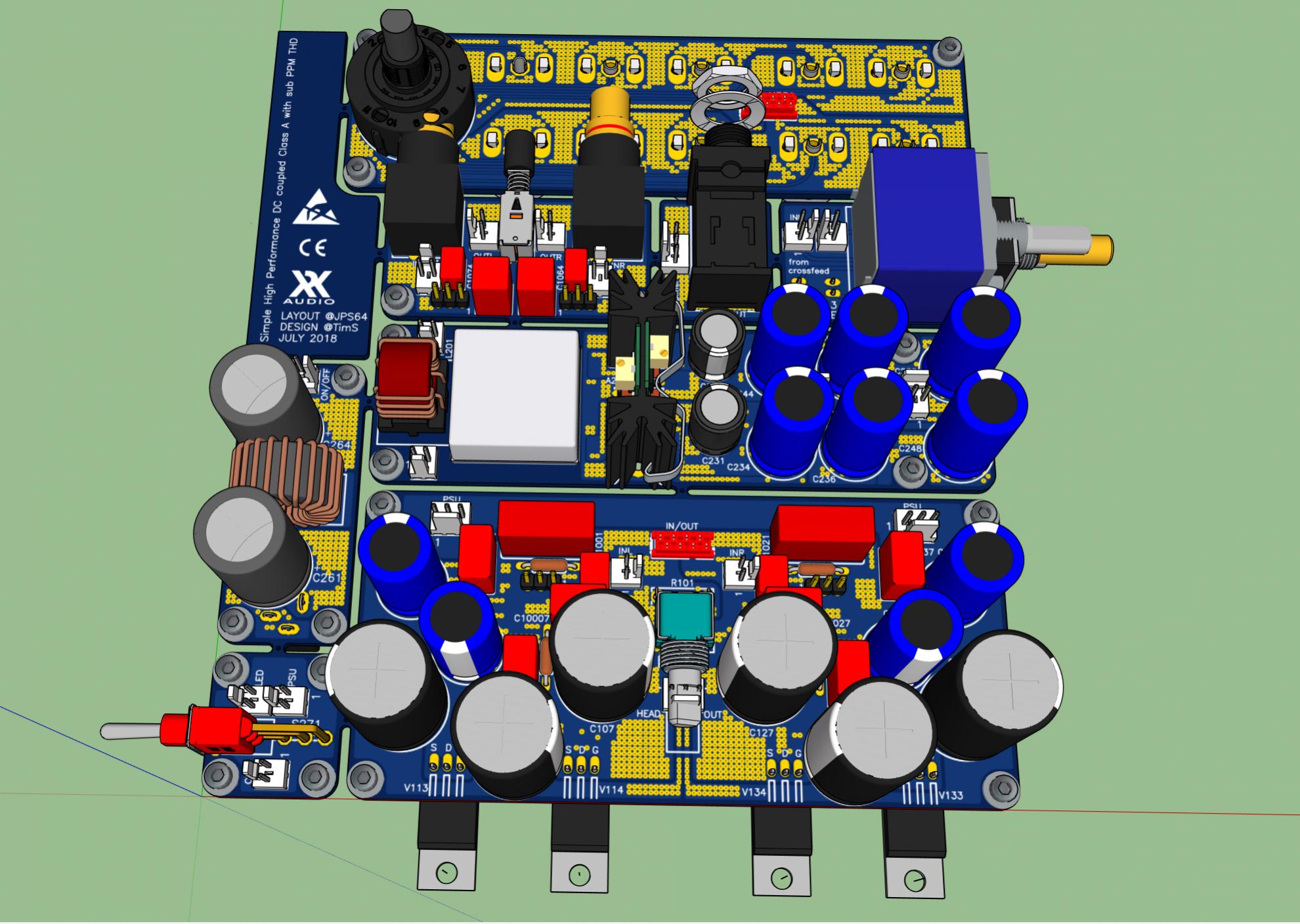

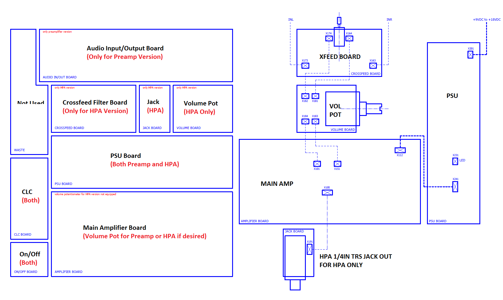

Here is the final design for production, and it is an 8 panel board that contains:
  • input and source switch board (only preamplifier version)
  • crossfeed board (with defeat Xfeed ON/OFF switch)
  • headphone jack output board (6.35mm stere TRS output jack)
  • volume potentiometer board (with the possibility of three different types of pots)
  • PSU (includes CLC, DC-DC dual rail step up, cap Mx, CRCRC filter to produce battery-like rails from simple 12v wall-wart)
  • CLC filter board (in case you want to use your own PSU)
  • ON/OFF switch board
  • amplifier board

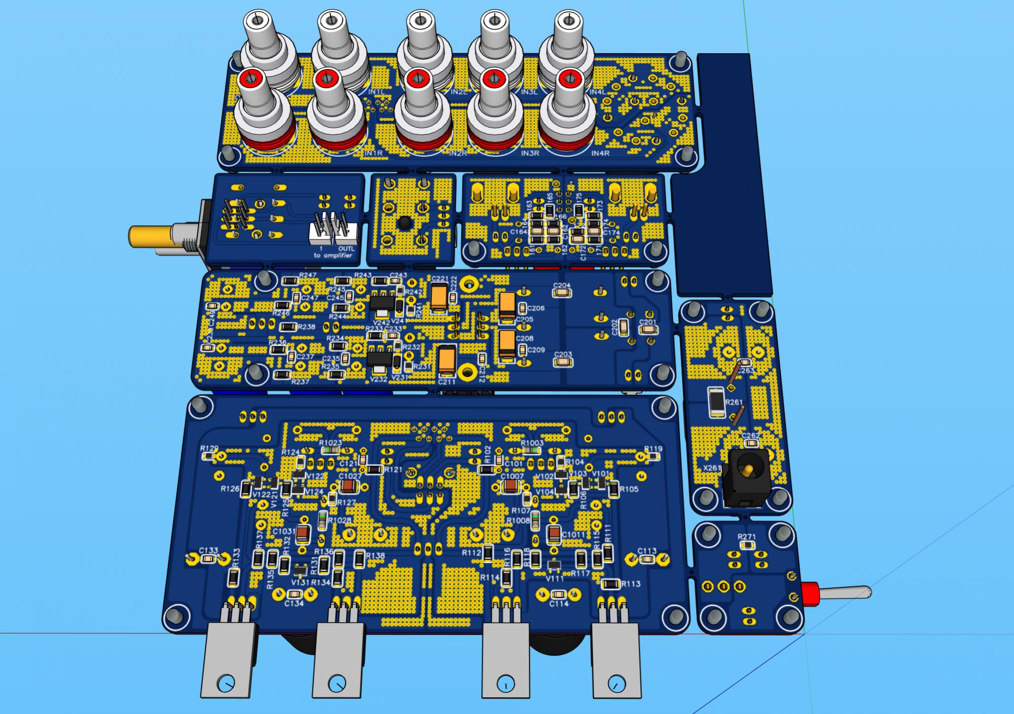

The above boards can be mixed and matched and connected for either an HPA or a preamp following this diagram:
689951d1530589553-simple-performance-dc-coupled-class-hpa-sub-ppm-thd-simple-hpa-block-diagram-png
Schematics and other data here:
Simple High Performance DC Coupled Class A HPA with sub PPM THD - Page 10 - diyAudio
Top side:
689952d1530589553-simple-performance-dc-coupled-class-hpa-sub-ppm-thd-shpa-pba-top-2-jpg
Other side:
689953d1530589553-simple-performance-dc-coupled-class-hpa-sub-ppm-thd-shpa-pba-bot-2-jpg

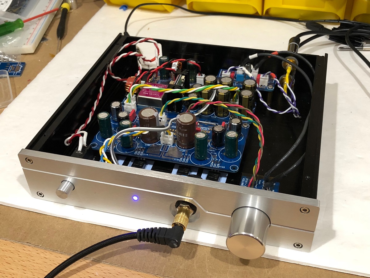

Mounted in a popular all CNC'd $36 Aliexpress case as a HPA, it looks like this:
689422d1530307921-simple-performance-dc-coupled-class-hpa-sub-ppm-thd-hpa_front_2-png

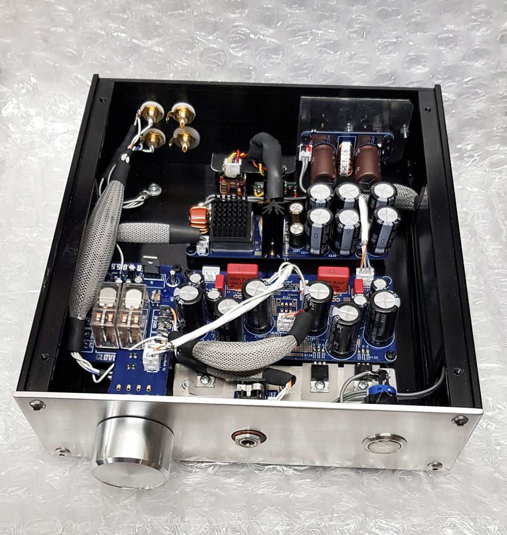

As a preamp with your own machined panels, it looks like this:
689375d1530286481-simple-performance-dc-coupled-class-hpa-sub-ppm-thd-tims-preamp_open-jpg
Rear view of preamp:
689374d1530286481-simple-performance-dc-coupled-class-hpa-sub-ppm-thd-tims-preamp_rear-png

Update Aug. 4, 2018: Schematic Update! Please use this schematic for the PSU as the original has a few typos.
Update Aug. 5, 2018: Silkscreen on PSU PCB has error: Diode V241 has cathode and anode flipped.. Mount diode with Anode towards Drain of P channel MOSFET on cap Mx.
Update Aug. 27, 2018: verification build of GB boards completed. Amp sounds superb and measures very well. Here is FFT for 1vpp into 51ohms - very similar to earlier measurement but much lower distortion.
699591d1535270403-simple-performance-dc-coupled-class-hpa-sub-ppm-thd-shpa-gb-build-01-jpg
699790d1535317831-simple-performance-dc-coupled-class-hpa-sub-ppm-thd-shpa-gb-verif-build-fft-1-03vpp-51ohms-png

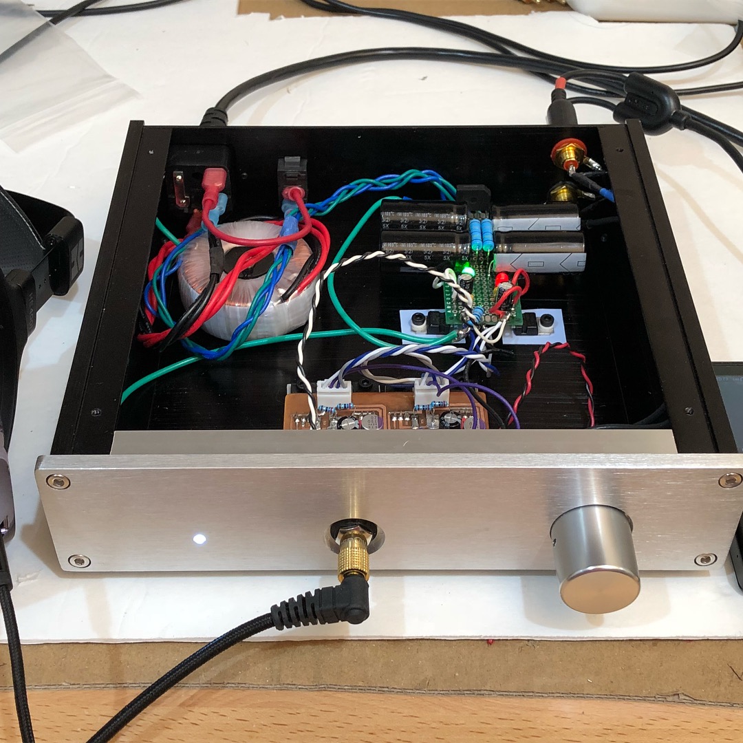

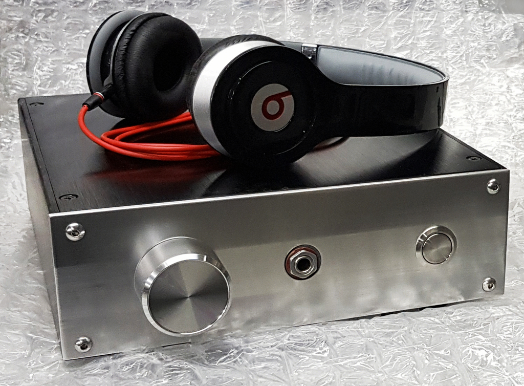

I got the amp all boxed up. This one was actually easy to work with as IEC, power switch, RCA, 1/4in headphone jack out, volume known, and LED hole were all predrilled. I just had to mount the amp MOSFETs and PSU and trafo.

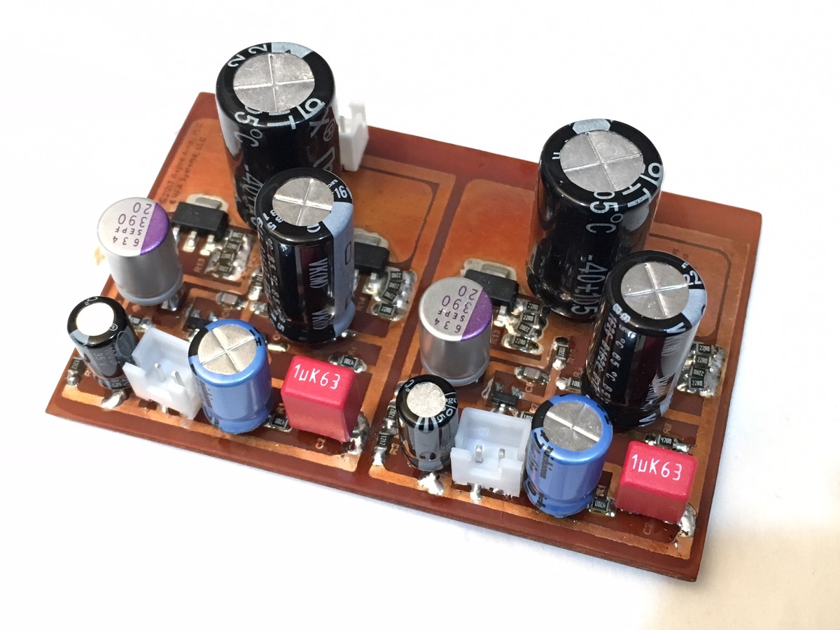

JPS64 and I are working on an integrated compact dual rail supply on same stereo board to make this project a lot more user friendly. We are thinking maybe simple Class 2 wall wart trafo to power a nice DC-DC dual rail step up, followed by state of the art TI ultra low noise LDO linear regulators and then some additional filtering.
A standard linear trafo and CRC and 7815/7915 works but FFT floor is not flat battery quiet like the way I like to see it. Inaudible of course but bothers me that it’s not like a battery.
