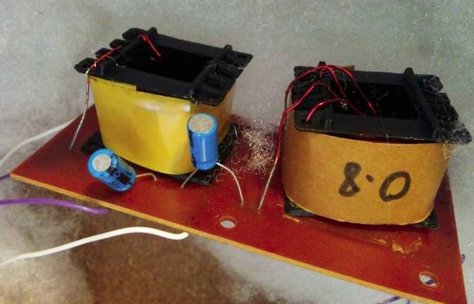

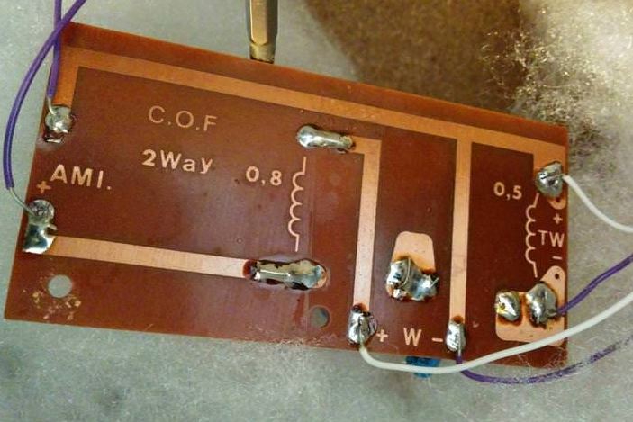

Hi everyone,
I was checking some old speakers I had in storage and noticed that one of the tweeters wasn't working. Opening both speakers, I saw that the crossover circuit has two caps, both 10uf. One speaker has caps rated 25V (one of them had exploded) and the other speaker has them rated 50V. Caps in both speakers are all electrolytic. This finding made me suspicious of the whole crossover circuit.
The speaker elements were made in Germany by Isophon in the early 80s, but were most likely assembled into a cabinet locally by the importer and may have been worked on at some point before I received them.
I couldn't find exact documentation for the woofer (p-225-35-8) and tweeter (kk7/8). This is the closest I got.
Judging by these photos, can you tell if this circuit makes sense for these speakers in this configuration? If the inductor values ( 0.8mH and 0.5mH) make sense, what values should be chosen for the capacitors? What crossover frequency is a safe bet? Is it normal to have two different inductor values in a crossover circuit?
I'm sorry if I offend you with my ignorance. I just want to try and revive these speakers. Any information or opinion will be greatly appreciated.

It's not unusual to use different values. The woofer and tweeter require different filtering.
If it uses one capacitor and one inductor per driver I would guess that it has been thought out, to some minimum level at least. Ie the crossover frequency is probably a reasonable choice.
The choice of Voltage ratings might be OK considering the two capacitors are doing different jobs,

Most likely one of the caps burst and was replaced with a different part (same uF, different voltage). Crossover capacitors are very unlikely to get damaged by voltage (it's of course possible, but you'd be surprised how low the voltage across the capacitor is likely to get in normal use). More likely, it's from I^2*R losses overheating the cap -- older electrolytic caps can get a lot of excess R in them, which can lead to heat and bursting.
bwaslo - the thing is, the second cap on the same board is also 25V and the board in the second speaker has both caps at 50V. I believe that all caps are the original ones because these speakers were hardly used and spent most of their lives in storage. Still, maybe the capacitance is fine and I'll just replace all of them with some metalized polypropylene ones of the same value.

It's actually a fairly standard sort of configuration.
What we have here is a 0.8mH coil on the metal dustcap (!) 8" bass to roll it off a bit and subjectively boost the bass.
Then a second order tweeter filter on a 1" soft dome. Usually around 3kHz. Coil is possibly around 0.5mH. Everybody has got it wrong on the 75mm chassis 1" dome tweeter capacitor. It's actually two 10uf electrolytic polars connected back to back to make a 5uF NP type.
So, me, I'd just replace the twinned tweeter capacitors with a 5uF non polar electrolytic at 5uF/50V or so. 4.7uF/50V will do.
AFAIK, this is a positive polarity filter, which will sound less echoey or phasey than negative polarity.

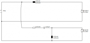

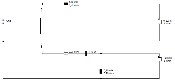

Last is a sim of how this sort of speaker works. If all goes well.

Good call, Steve! I was going mad trying to compare the PCB to other second order crossover schematics. Thank you and everyone involved for taking the time to help out. You're making the internet and the world a better place by sharing your knowledge so generously.
