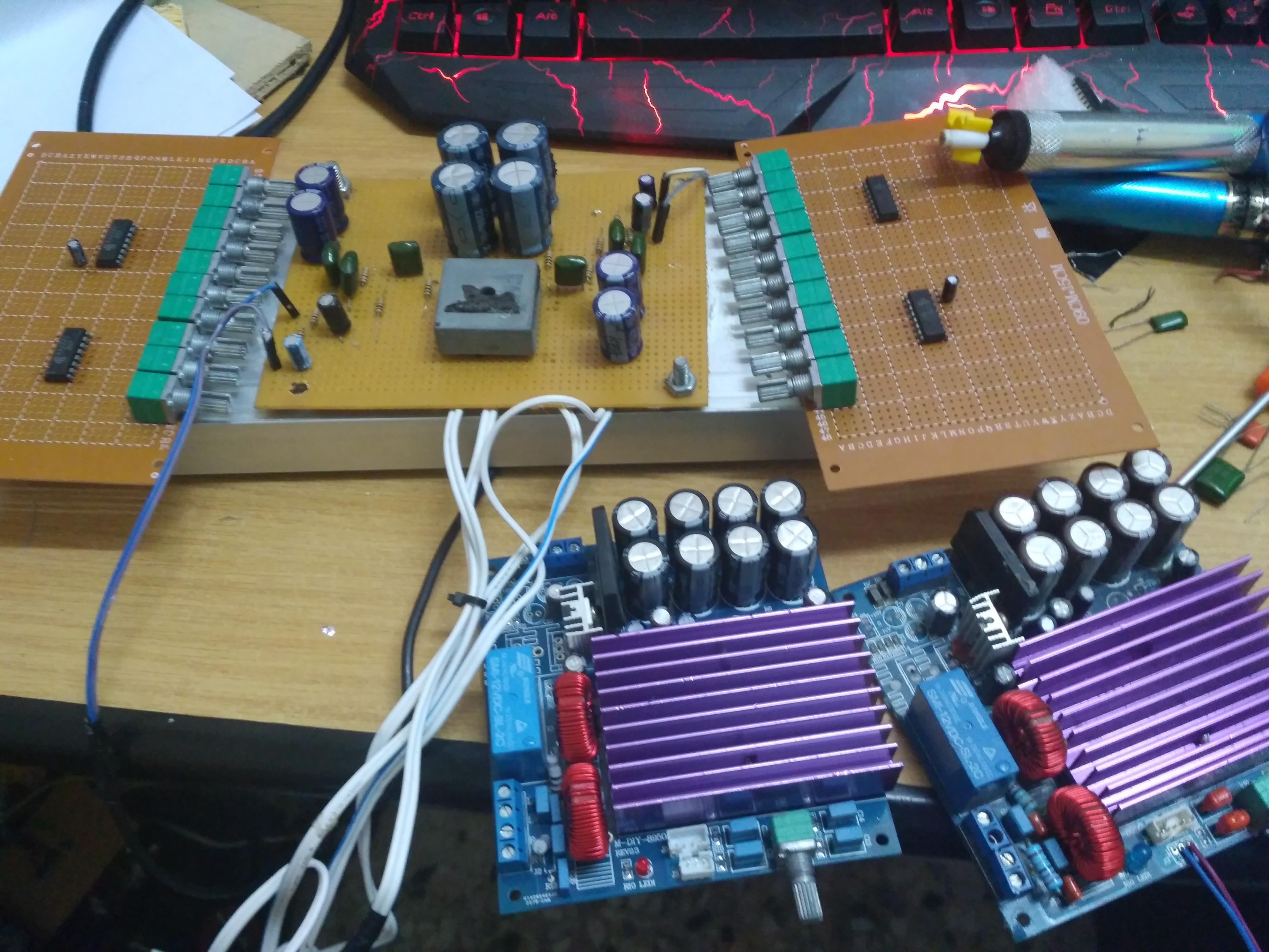

Get a ready made TDA 8950 class d module and you're good to go ... 120w per channel this amp is not a joke ... Your case you're making 6 channel amplifier ... 3 module of these will take care of everything ... Be sure to find a decent wattage power transformer as these modules were power hungry ... And yes this is the class d module mentioned refer to the photo ... And remember they need decent cooling to ... You need more information can feedback to me ... Good luck
