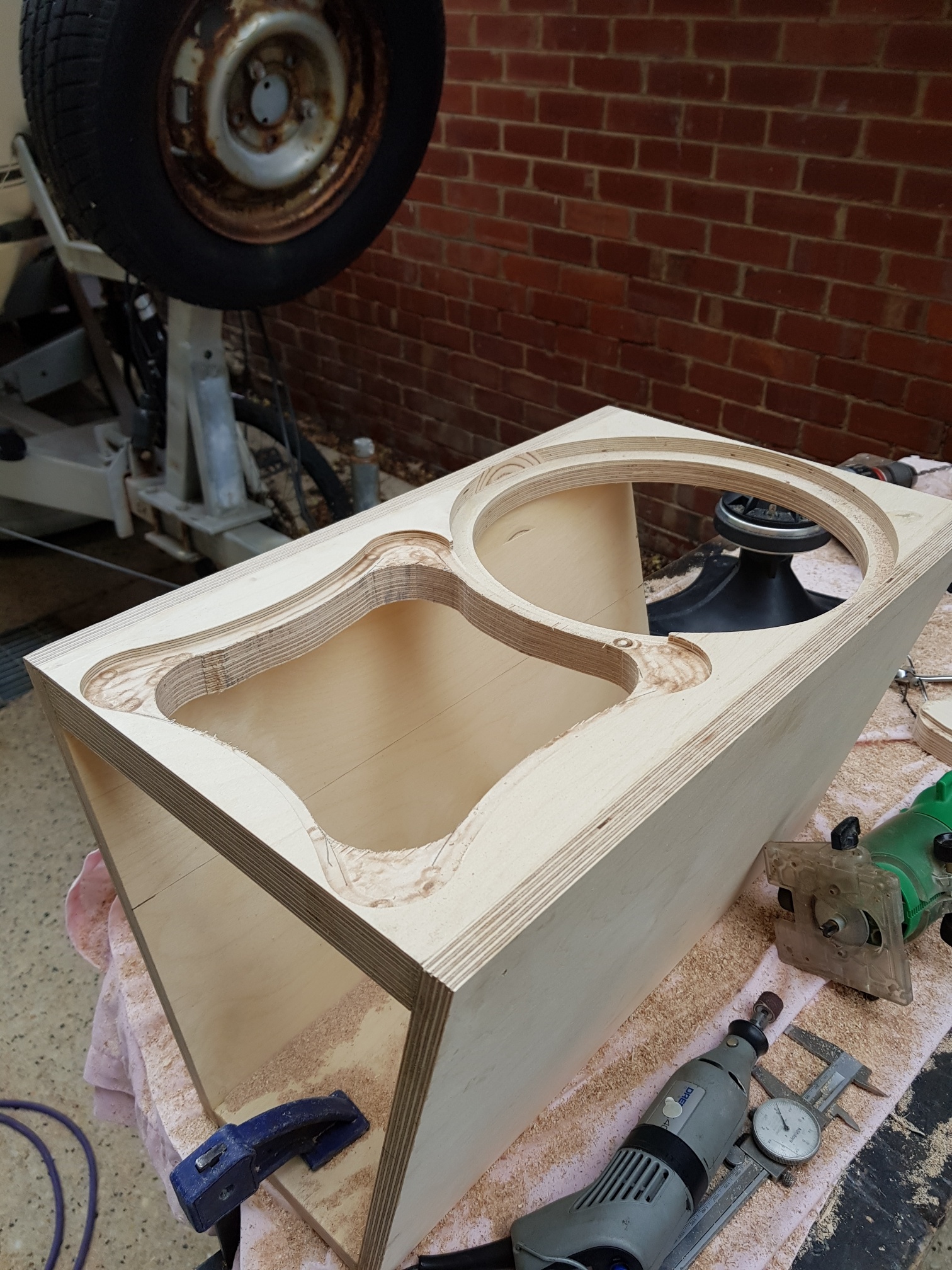

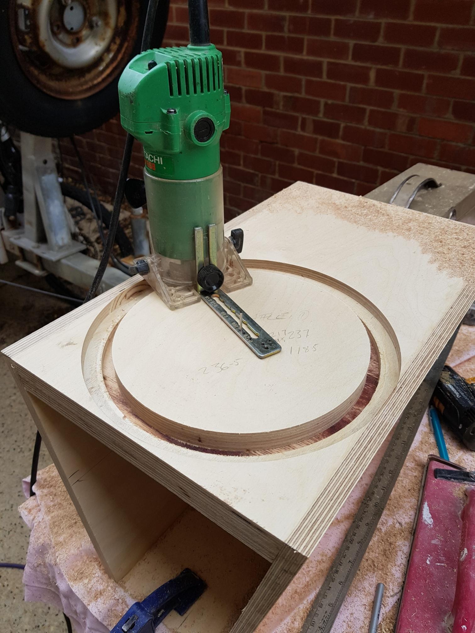

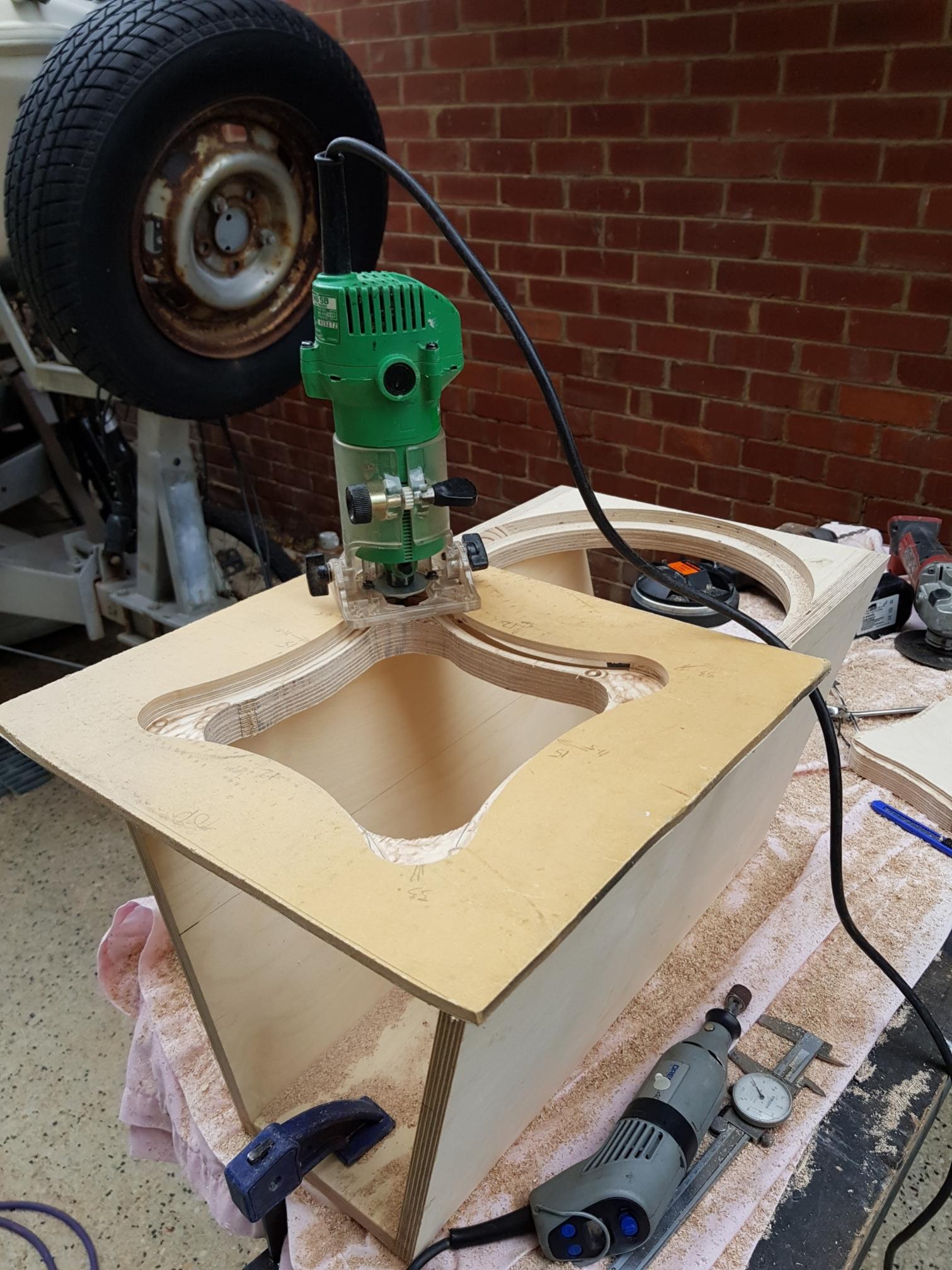

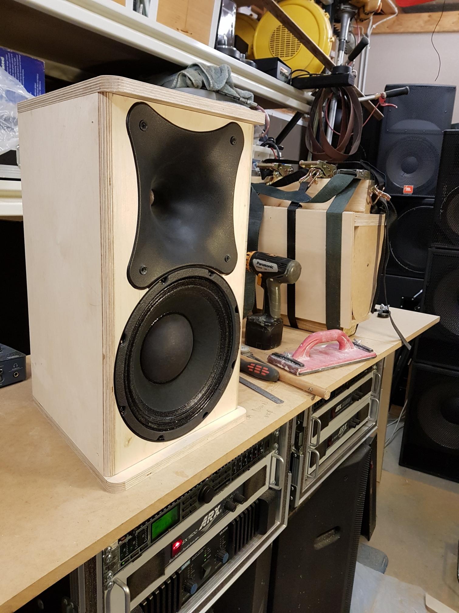

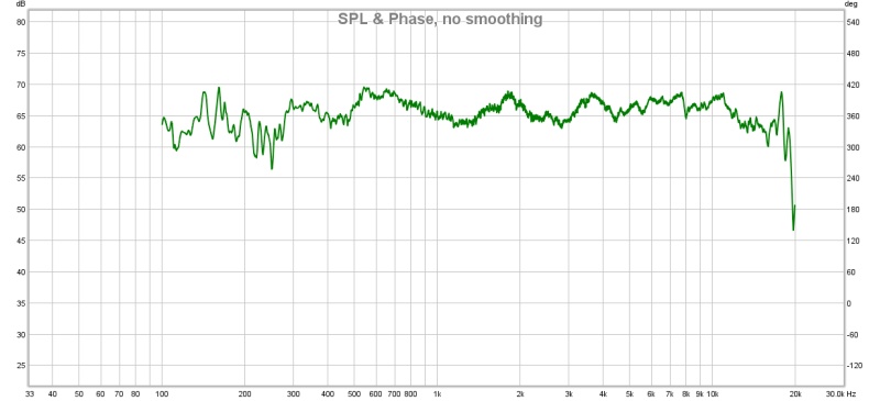

Well after much debating i went with the paudio sn10mb mk2 drivers as they where available locally and a good price too. if im not happy with them l will probably go with the faital 10fh520. I got about an hour of listening this afternoon to one cabinet and I was quite impressed, Im using a dcx2496 crossover to play with slopes and crossover points, so far ive tried 1.8k LR24 and it sounded great I had about 13db cut on the d220 compression driver. more testing to come before i attempt a passive crossover. cabinet tuning was to fs which is 70hz and the cabinet is around 21lt.

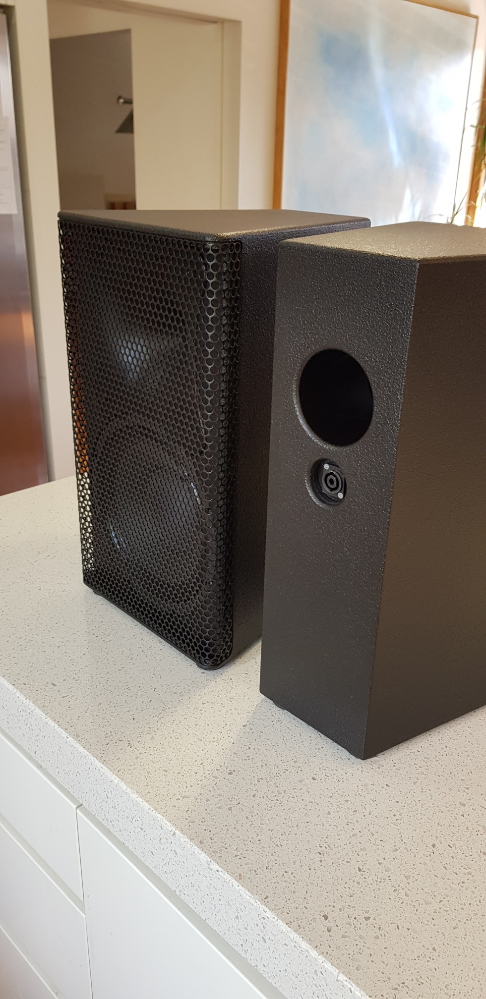

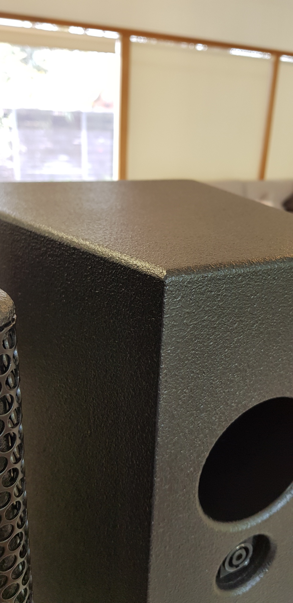

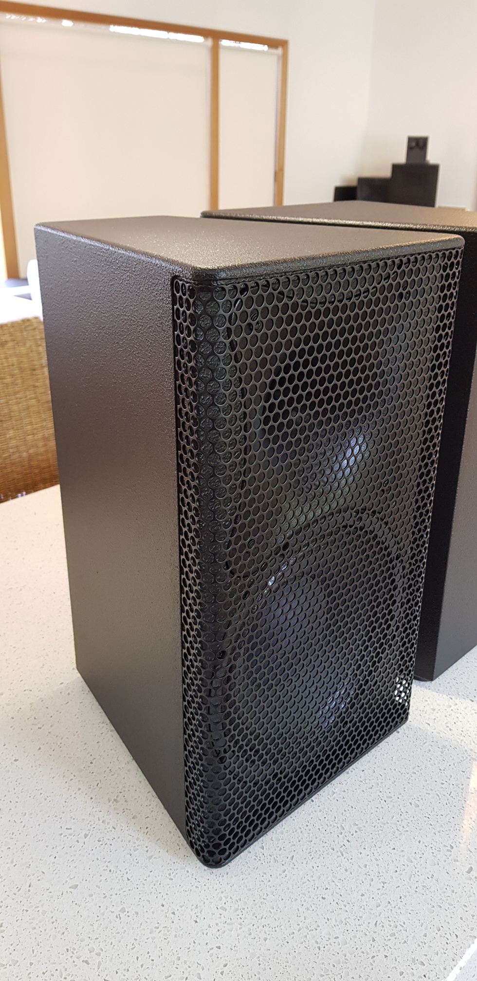

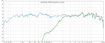

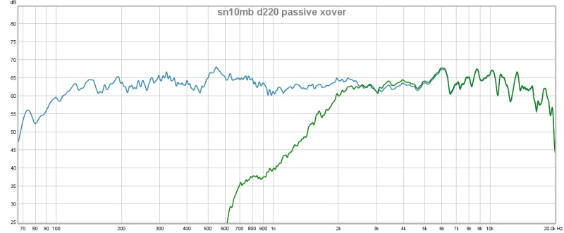

Its been over a year since i started this project and i have only just finished. I changed the selenium d220 out for a prv d290py-s with polymide diaphragm. The results are great im very happy with the sound now. despite the small size these speakers really pack a punch and can be used stand alone or with subs. I was also very please with the duratex paint.

Hey Greg,
I have built 4 similar cabs, also using the Selenium D220, a few years ago. I quickly built some passive crossovers for these cabs, and I had planned on optimizing the crossovers later. But so far I have just never gotten around to doing it as they sound pretty decent already.
Would you minds sharing your crossover design? I have a ****-load of inductors/resistors/capaciors laying around, and I would be interested in building one your versions for comparison.
Great looking cab by the way.
