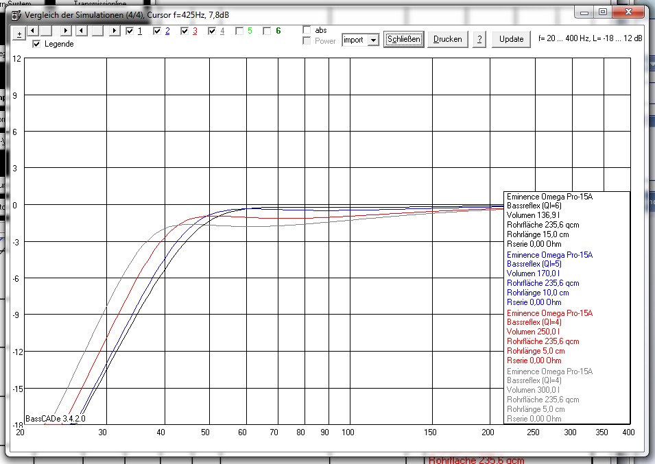

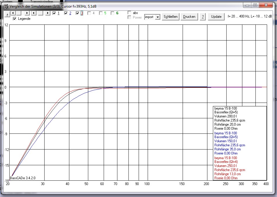

What kind of enclosure do you want? I presume BR. With the Eminence you won't get down to 35Hz/-3dB. The Beyma would, it needs ~200l for it. But you won't get 98dB on 15", the high spl is not reached in the bass let alone subbass, that's for the lower mids or higher. You can count on probably 94-95dB. If you need more, you'll need a bandpass or horn (which will be much bigger).

how much would the eminence pro15 in 250L give me in Eff? would it match the Audax mid?

The Eminence Omega Pro15 isn't a sub, it's a bass-mid driver. Even 300l will not get it much lower, especally not with with high spl. Besides that, the excursion isn't exactly huge (3,2mm).
But look for yourself:
attachment.php
That means, you cannot force every driver to specs they aren't made for. The Emmi will perform nice in a PA top or conservative PA fullrange, from ~60-140l.

Well, it's not unrealistic. But the f3 won't be refering to 98dB, it will refering to ~95dB.
attachment.php
So you see, more than 200l does not help much, no point in giving them more volume.

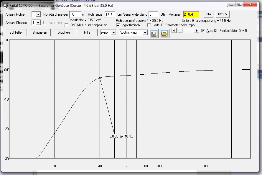

Some of the best very efficient options that will reach low are the Great Plains Audio Altec remakes. An alternative to a single 15", since you're not stuck with concerns about directivity matching for this system, would be to use an array of smaller drivers to achieve desired F3. I like using multiples for the design flexibility.
The Faital Pro 15PR400 is very good, that's correct. It does not go that deep linear though, that driver also prefers smaller enclosures and higher f3.
attachment.php

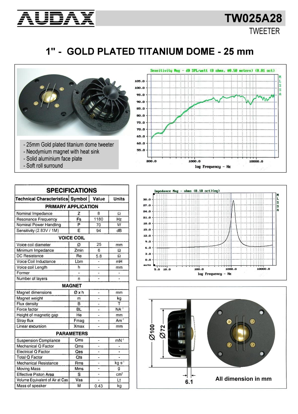

The silk ( 96 dB) and titanium dome ( 94 dB) tweeters from Audax are a good match too.
The Audax PR125T1 (silk dome with horn) is not a good partner for the mid, it has to be crossed over at at least 3kHz (better >3,5) and the PR170M0 already starts to resonante there. For the TW025A28 the spl is too low (93dB@2kHz) and it got a very wide dip between 6,5 and 9kHz where it only reaches 90dB. About which one were you taking?
IMO a horn or WG and a compression driver would be a much better choice. At least it can keep up with the dynamics of the other drivers.
No professional series, I was talking of the TW 025 line -The gold one is rated 97 dB/W/m :innocent: They have all a sort of horn ( waveguide it is )
The Audax PR125T1 isn't actually a professional driver, that's for power-HIFI. And I can't say I like what I'm seeing at the data sheet (PDF). Look at the waterfall decay measurement, there are horn drivers that are cheaper, louder, got a better linearity + decay and are able to cross over lower (i.e. Kenford Comp 34 + HL607).
The gold one does not have a horn or WG and it's rated with a lower SPL, look at the Audax datasheet:
attachment.php
