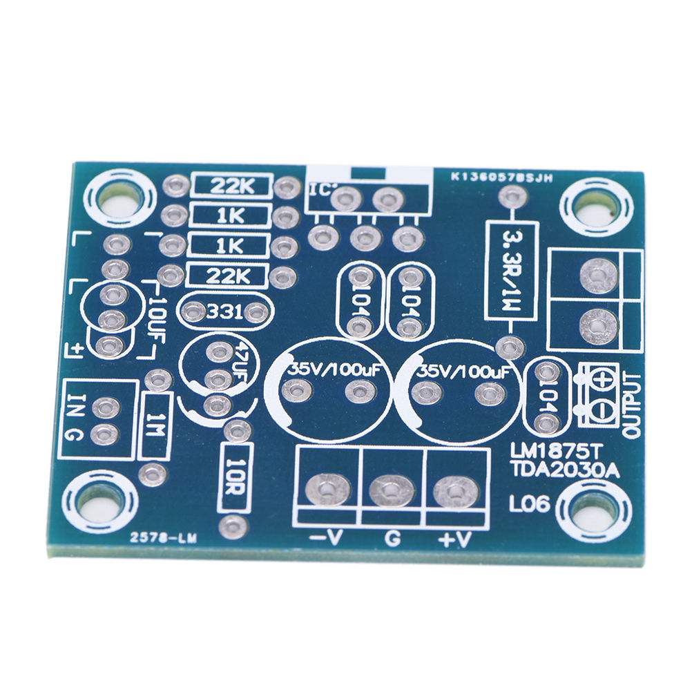

Hi, I am new to this forum and I would like to apologize in advance if I cross any lines while posting this. I got two of these mono LM1875 kits on ebay with the intention of making a stereo amplifier. I have attached images of the assembled kit along with the schematic and board layout. This kit is available from multiple sources for around $3 or less and I thought it would probably be popular on the forums. After doing multiple searches using the search feature and google I have found no information about it other than a couple youtube videos made by JohnAudioTech. He seemed to think the board is laid out well and uses properly rated components. He did mention possibly replacing the input capacitor though. What I want to know is if there is any more information on these kits and what components people would recommend replacing if any. I plan to use a known genuine LM1875 chip rather than the one from the kit and powering the two boards with a power supply board from chipamp and an antek AS-1218 - 100VA 18V TRANSFORMER. My apologies if this information is readily available and I'm making a duplicate thread.

the sch is a good start.
It has both MF and HF supply rail decoupling.
It has an Output Zobel.
It has both Low Pass and High Pass filtering on the input.
It has AC coupling both at the input and at the NFB.
It has a cap leakage resistor on the input.
It has separated the Audio Ground where the input Return signal references, from the Power Ground where the output Return signal references. This allows multi-channel assemblies.
All good signs that the Designer has at least read the datasheet, or carefully copied a properly executed sch.

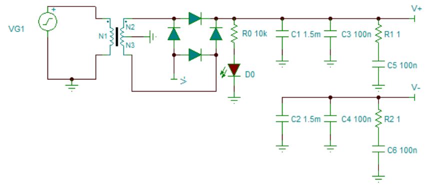

Do you think this power supply design would suit the amplifier? C1 and C2 will be 1500 uF capacitors and I'm considering not implementing the snubber network caps and resistors. I don't really know what I'm doing though and was only considering omitting the snubbers because Peter Daniel said he preferred the LM3875 without them.

The snubbers as shown are in the wrong place, they should be across the transformer secondaries. You could also fit some at the amplifier end of the PSU cable.
C3 and C4 are also in the wrong place. They are HF supply rail decoupling and should be on the amplifier PCB right next to the chipamp's power pins (see the datasheet).
The smoothing capacitance shown will only suit mid and treble duty. This is what Peter Daniel optimised his chipamp build for and used very high efficiency speakers (maybe around 95dB, or 96dB/W)
Most Builders and Listeners find they require lots more smoothing for better bass response.
The power supply schematic I provided was from the directions for Brian GT's (chipamp dot com) lm1875 kit. I'm not sure how they are in the wrong place but since I don't know how to implement them properly I'll just omit them for now. Seeing as there are already HF supply rail decoupling capacitors on the amplifier boards (C5 and C6?) I'll also omit C3 and C4 on the power supply board. You seem to suggest replacing the smoothing capacitors (C1 and C2?) with higher capacitance pieces. Assuming I would be using this amp with speakers in the low 90's db/w what size capacitors would you recommend? Thank you for all of the information you have provided by the way, it is greatly appreciated.

I use +-20mF per 8ohms channel. But nearly everyone else thinks that much less will do the job.

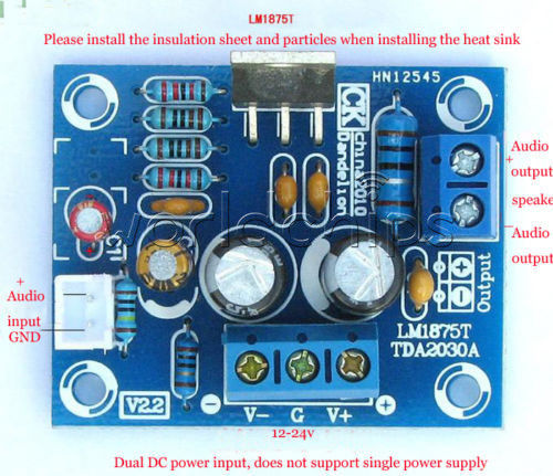

The resistors which came with the kit are light blue and have 1% tolerances according to their color codes so I believe they're metal film type and I think I'll use them. I have Vishay 0.1µF polypropylene capacitors that I want to use for the HF supply rail decoupling (C5 & C6 on amplifier board). I want to replace the 10µF input cap with a film capacitor of the same rating, do you think that's a good decision? I also want to replace the electrolytic 220µF MF supply rail caps and the 47µF cap with better quality ones like Panasonic or Nichicon. Should I use the same size for these? And finally I'm considering replacing the small caps that came with the kit as well (C4 220nf & C2 330pf) but I can't tell if they are ceramic or tantalum and don't know if replacing them would be worth it.
0.1uF polypropylene may not be suitable for supply rail decoupling.
Not enough ESR.
Use X7R ceramic for HF decoupling.
Difficult to tell from the partially obscured top view, but I think the yellow/orange caps are probably ceramic. They are very cheap and likely to be what they have used.
Can you label the sch with the capacitors that are actually fitted to the PCB.

Interesting to learn where this came from. Here is a schematic I labeled with what I believe are the correct component labels. I also found a picture of the board in plan view and saw that there are versions of this board where the silkscreen labels actually name the value of component to mount.

Here's a few suggestions.
If you want the low bass to be very extended then you need to increase C3 from 47uF to 150uF or 220uF.
This requires the input capacitor to be reduced slightly.
C1 <= C3*R4/sqrt(2)/R2, i.e. C1 <=150uF*1000/1.4/22000 <= 4.8uF use a 4u7F bi-polar, or MKT. Or 6u8F for the 220uF option.
Alternatively if you want less low bass, you can keep C3=47uF but you must reduce C1 a lot. The same formula applies and C1<=47uF*1000/1.4/22000 <=1u5F, use an MKT or MKP
If the amp slews to high DC on the output, then C3 needs some protection. Add two inverse parallel signal diodes across the cap pins on the bottom side. Use 1n4148, or 1n914.
If the source equipment becomes faulty and sends mains down the interconnect, then you need protection across R6 to take the mains Fault Current to your power ground and thence to your protected chassis, to eventually blow the mains fuse in the faulty source equipment. Add a pair of 1A power diodes in inverse parallel across R6. Use 1n4002, or higher.
C2+R5 is your interference filter. It is set a bit too high, although some Members prefer this very high setting because they claim they can hear the effect of any lower attenuation frequency. I recommend you experiment with the C2 value starting at 330pF and going up via 680pF, 1nF to 1n5F until you hear the treble rolling off very slightly and then go back one step. Use MKP
Between the amplifier output and the speaker terminals on the enclosure, add an in line air cored inductor. Use 1.2mm or 1.4mm or 1.6mm diameter enameled copper wire. Wind about 10Turns around an AA battery. Add a 4r7 resistor across this to damp ringing.
The locations of C5, 6, 7 & 8 are good.
Look up the 1875 datasheet and see if R7 is the recommended value.
Thanks for the suggestion phase but those do look a little too beefy for this application and I just received some caps I would like to use instead.
AndrewT I have 2.2uf Panasonic film capacitors (Part #ECQ-E1225KF) I was hoping to use for C1. With this value in your equation the closest capacitor I could get for C3 would be a 100uf. Do you think a 100uf Nichicon ES series cap (bipolar and suited for signal paths) would be a well suited choice for C3 then? And what voltage rating would be required for C3?

OK,
you can use your 2u2F MKT.
Turn the equation around to find C3 instead.
C3>=C1 * sqrt(2) * R2 / R4
giving C3 >= 2.2uF * 1.4 * 22000 / 1000 >= 68.4uF use 100uF
