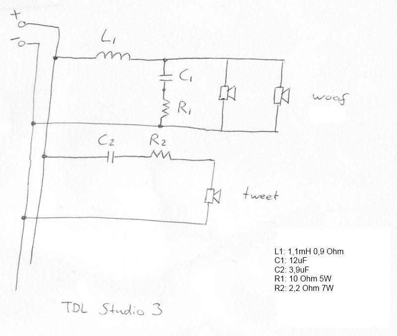

studio 3 schematic.jpg Hiya,
Here's the schematic.
The original high pass cap is actually 4 not 3.9. I bought a Janzen 3.9 which sounds very nice but I wonder if the fact it 0.1 uf out will make any difference? (My gut/ears says it is a bit...Janzen don't do a 4 anyway so I have ordered one with a value of 4 from another manufacturer...will report back)

The schematic helps a lot! :)

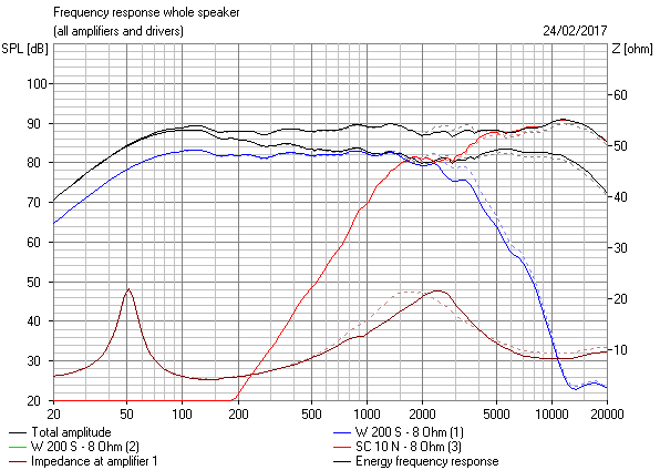

I'm guessing these are 16 ohm polycones, but I don't think my rough sim is much affected. I know this territory.
I can't see much point in messing with the bass filter. It's the sort of thing that works well with polycones, which really don't need much work.

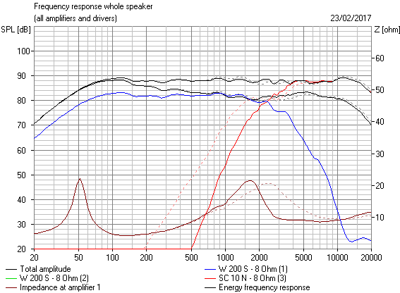

The sim shows the single cap tweeter filter in dotted. Also a conversion to third order and zobel. A 7.5R/0.68uF Zobel is just something I like with metal domes, and tames the top end a tidge, and you can try that without changing the rest of the filter.
You could try 4.7uF/0.3mH second order too, without the 10uF. This sort of thing changes the character of a speaker. But definitely lower tweeter distortion, which can be good for complex orchestral music. You keep the 2.2R at the input, because it protects the amplifier from overly low impedance if the tweeter blows.
So there it is. Things to try.

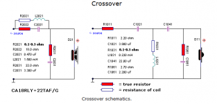

I just roughly simmed it with a deteriorated bass shunt electrolytic @ say, 4uF. And a 3.9uF electrolytic which we assume has a ESR of 1 ohm. The dotted line.
Once you "upgrade" to polypropylene, you lose a bit of midrange presence with the new 12uF and the tweeter is about 1dB louder. But that may mostly because the original bass shunt capacitor had wandered out of spec, not because it's bad. These are smallish differences.
TBH, I'm winging it a bit on the bass, because I'm using 8 ohm drivers, but the general idea applies. The bass shunt is a very mild but familiar form of impedance correction and added voicecoil damping which I use myself. It doesn't do an awful lot, but tidies everything up around 3kHz, and you can hear the improvement. Troels does something like it here:
