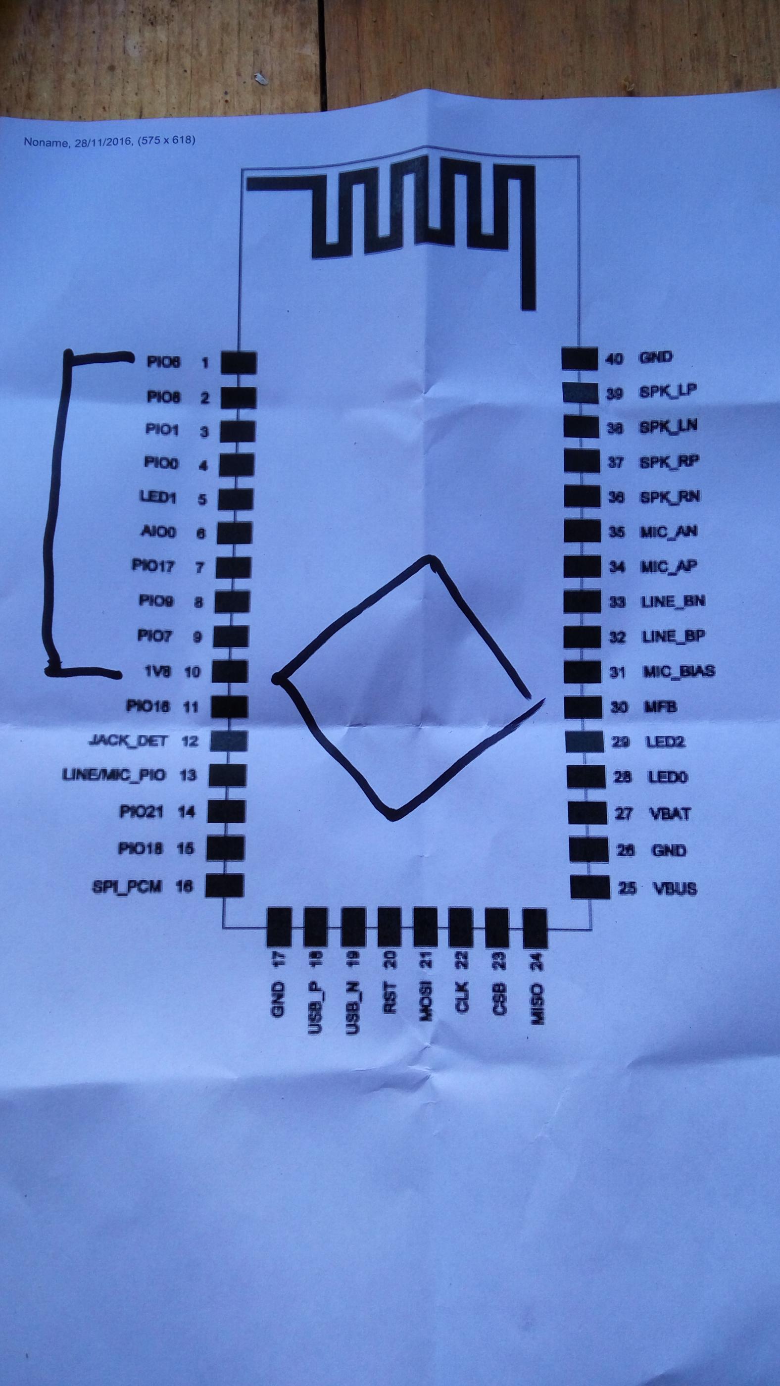

I located the output lines from the bt module, but wherever I tap into them I get no input. Could there be some protection on it? I notice the L and R channels have separate grounds, my input jack joins them, perhaps that's the problem? Not sure of how to solve it.

Not sure if adding a line in is going to work out but if its going to work at all I think you need to tap in after the SGM358 op amp, just before the main volume control where the left and right signals pass through the two 1K resistors. Not sure where to pick up the ground lead, but it should be easy enough to figure out. The ground is common for L&R at that point.

So this is weird... cut the lines from the opamp output from the BT module, connected a jack, and when its turned on it plays for about a second then cuts out. Tried a 10k resistor and a 100uf cap, and both, but get same thing.
Must be some protection switch on the amp to cut off if the bt is not connected? How to defeat that?
There is a circuit driven by pin 1 of the Bluetooth module that controls the mute function on the TPA3116 amplifier chips (pin 12 on each). I don't know why it would be unhappy but maybe you need a dummy load on the left and right output of the op amp? There is also short circuit protection on those TPA3116 chips so check your speaker wires too. I'd probably reconnect the BT and get a different amplifier at this point as this is getting in deeper than I would recommend.

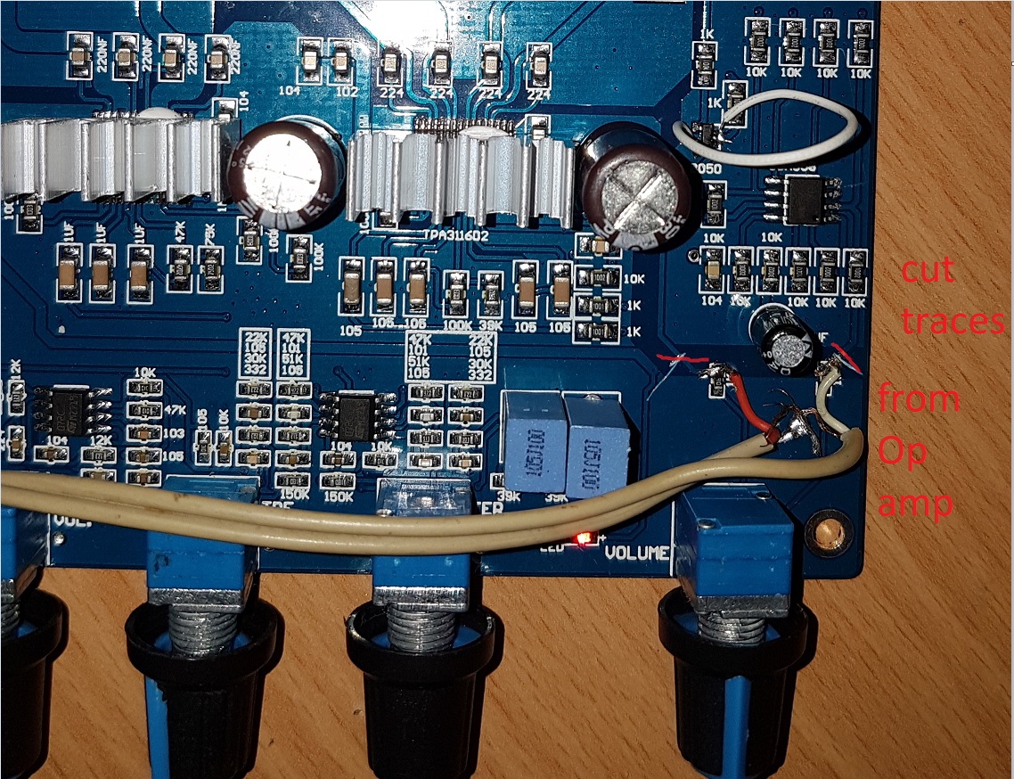

For anyone interested, I have managed to make the stereo channels more bassy. I changed the filter components (next to the volume control - two 100nF caps and two 39k resistors) to 200uf caps and 22k resistors. I'm not sure why but this raised the tone of the sub bass and gave the stereo more bass.. so quite happy now except for still having no aux and the BT being a bit noisy. Cheers all.

200uF or 200nF?

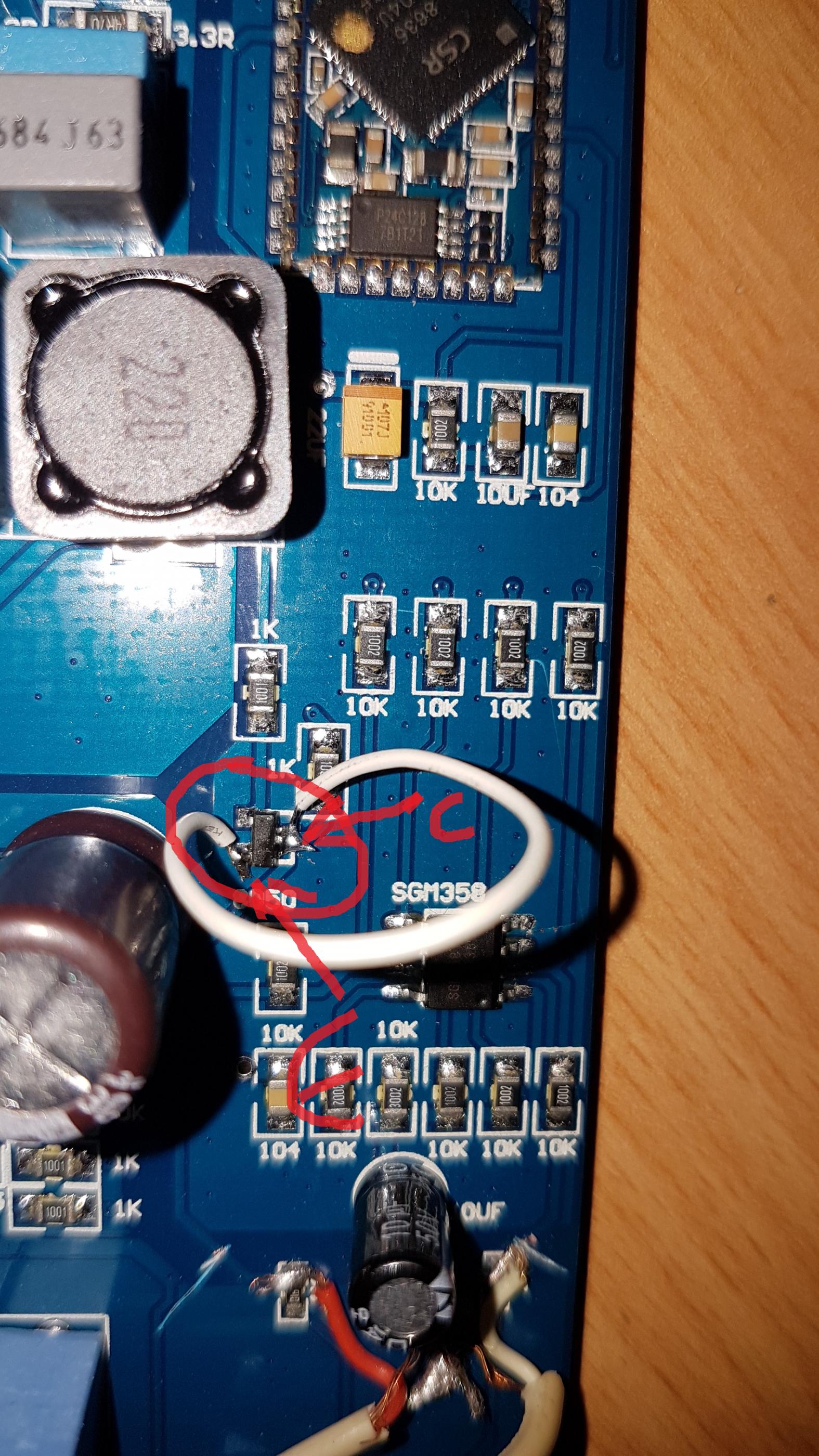

Hi, I just got it to work today, and it is pretty easy job, first you need to cut off signal from op amp SGM358, because you can burn your sound card. Signal from op amp is DC offseted and is about 1.5V on each channel. Then you place your input signal cable before 1K ressistors. You put ground wire on the ground of the PCB, best place for me was as shown in the picture, near potetiometer I scratched PCB and solder it there, for everything to work you need to bypass marked Y1 NPN SOT23 transistor that is enable signal for the TPA3116, signal comes from bluetooth module when sound module says that audio is present and puts about 1.7V in the transistor base and activates the enable signal of 5V on the amp, here are pictures, it's all soldered just temperarly till I get the case for the board and make a switch that changes input signal to amp bluetooth/aux.
Notice:
Double check your connection, solders, make sure that no voltage is present on the input signal cable with a multimeter. I'm not responsable if someone damages their amp or audio source device
