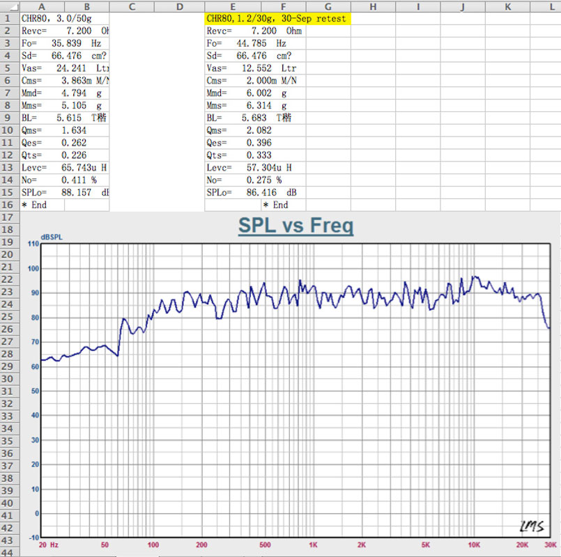

sarathssca, compared to "normal" drivers that are used in multi-way speakers full range drivers aren't smooth at all. You'll see large response variations. 10dB (which is half the perceived loudness) is common. There are some exceptions though.
In my opinion they all need to be equalized to get them into the ballpark. Equalization is cheap and easy to do these days.
Here's an example of a full range speaker under development. The manufacturer claims that is was measured in an anechoic chamber:
attachment.php
Its un-smoothed data. It would only be fair to compare it to other drivers measurements that are un-smoothed as well.

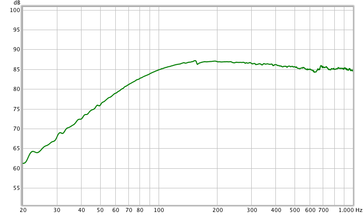

Here's a near field measurement of a driver. I've used the near field technique described by Keele. Frequency resolution 0,334Hz, no smoothing.
attachment.php
Maybe the Markaudio data wasn't measured in an anechoic chamber or the measurement methodology produces artifacts? I've asked the manufacturer about his anechoic chamber and measurement methodology but he didn't answer. He even deleted the whole thread.
