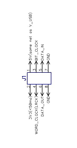

Recently however the folks behind Raspbian and especially Florian Meier with his contributions to I2S modules have made me take a much closer look at the raspberry pi - particularly "model B - revision 2". The addition of P5 and the newest Raspbian and Volumio builds make it possible to have an incredibly good I2S based music appliance by simply adding a great DAC - such as the Buffalo III-SE - which works perfectly - but you could just as well use any asynchronous I2S input DAC.
Using the raspberry pi with the B3SE is very simple. I have tested two scenarios - each with distinct advantages.
First pi -> DAC direct.
This is really simple:
just wire P5 to the DAC appropriately - as show in the attached picture. Pin 1 is indicated on the rpi by the square pin. And P5 is located right next to P1 (directly below with P1 oriented at the top).
The best news is once configured you can use the pi as an airplay receiver (with a mac) for audio (at 44.1khz) and as a direct audio appliance at up to 192/32bit sample rate (the limit of ALSA at the moment).
I have mine streaming directly from NAS (an ASUS RT-AC66U with a USB SSD drive) at up to 192Khz sounding superb! No complaints. The sound is incredible.

Here is detail you will want if setting up Raspbian, or Volumio for B3SE.
make your /etc/modules file looks like this:
Code:
snd_soc_bcm2708
snd_soc_bcm2708_i2s
bcm2708_dmaengine
snd-soc-pcm1794a
snd_soc_rpi_dac

Yes - you can supply the pi from the P5 header. I would not necessarily use Placid. You will need to supply 700ma or so.

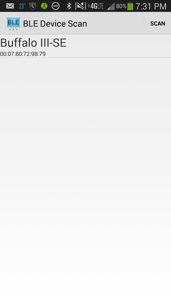

Hopefully this board will allow full control of some of the Buffalo DACs (in place of the unavailable AC2).
I have exciting news there too!
Look for another thread coming soon. I actually have something far better than AC2 already working. Brian and I are just finalizing the design.
Here is a teaser...
