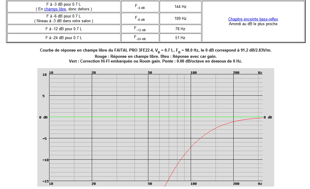

Each driver Faital Pro 3FE22 / 4 ohm, reference here,
http://www.faitalpro.com/products/LF_Loudspeakers/product_details/index.php?id=401000101
with a (BR) VB = 0.7 L tuned to 98.0 Hz.
F-6 dB 109 Hz, F-3 dB 144 Hz if you need to add a woofer later in time.
Don't worry about about Xmax or (Xmech), you can use it @40/50Hz without reaching it's mechanical threshold of damage that is 7.3 mm ~@20 W/4 Ohms.
An approximate measure for the vent is 2.5 cm (diam) for length 20 cm (x1 driver@0.7 L).

Wouldn't that be better to tune it higher ? If I put your recommendation on WinISD, I reach the x-max quickly (not the x-damage). I don't really get the difference between the x-max and the x-damage...

No, do a slot vent as many pro applications. Align as I said because there are no problems with max excursion for that (max.) power. Damage is the max excursion applicable at 7.3 mm for the driver. No problem with Xmax. The sealed app with be different in the x or low frequency roll-off (F3=230/250Hz and up).
The enclosure you mention is wrong, separate the enclosure for you don't have interference between channels. One for both drivers is not a good idea.

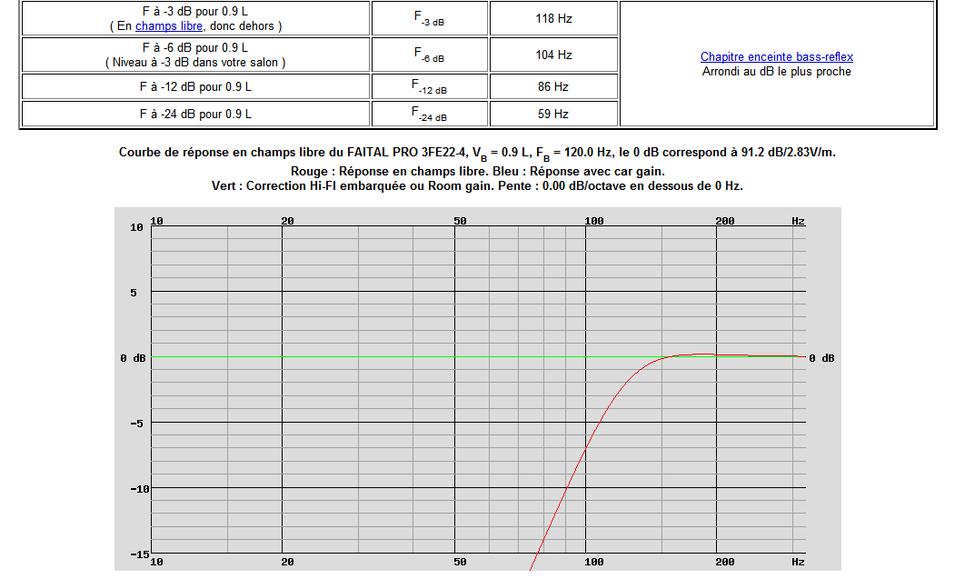

Inductor, I don't really get why you would tune it so low. In WinISD, if I tune to 120 Hz, the F3 is better, and the response frequency seems to be better. So why tuning it so low ?

I can make 2 sims for you if that helps in any way. But make sure you are using the right parameters for the 4 ohm (post #2) FAITAL PRO 3FE22-4 from the website or they can never be compared. :no:
The right alignment is a personal matter. I'm not here to make you change your opinion.
I hope you got my note on the inside of the enclosure, and I'm sure you never wanted to share the space between the 2 stereo drivers, they would interfere with each other. Also make use of some acoustic absorption felt because of the inside reflections. 🙂

Yes, I thought about the NS3, but they are more expensive here in France. I will definitelly try them one day, but the low sensitivity worries me, as I care more about SPL than lows. An F3 of 100-120 Hz is ok for me (outdoor use).

I have quickly made a closed box of 1,8 liters for both 3FE22-4, and the sound is nice. Some EQ with miniDSP is really necessary but the SPL is incredible for such a small box. But of course, no bass. I must know try to find a way to include ports. I'll try one aligned at 98Hz, and one aligned at 120Hz.
