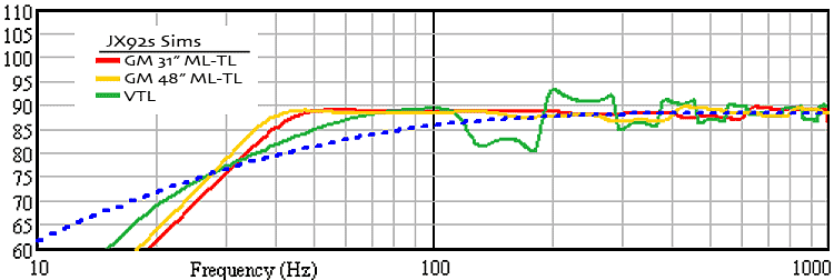

Ted Jordan's VTL for the JX92 is 4 in deep. I think you can successfully flatten designs and preserve CSA to a certain extent but the flatter it is, the fewer acoustic modes you can support in the short direction and the character of the sound will be different. I took a 6x8 in CSA from a BIB design and flattened it to a 3 x 16 in for a wall mount BIB and it still worked but I think at the expense of a richer sound and it forced a resonance that matches the 16 in width to crop up. closer to rectangle proportion of golden ratio will sound better. Taken to an extreme, I would imagine that a nominal 6x8 flattened to 1 x 48 will not sound the same at all.
Perhaps not a good example.

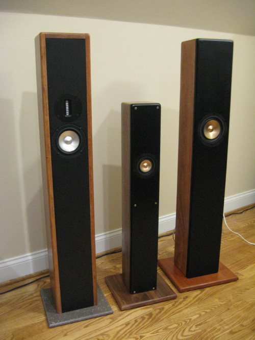

Finally, I have attached a MLTL family photo of my Jordan JX92S design (the Jordan with a ribbon variant), an Alpair 6 design, and the Alpair 10/10.2 design.

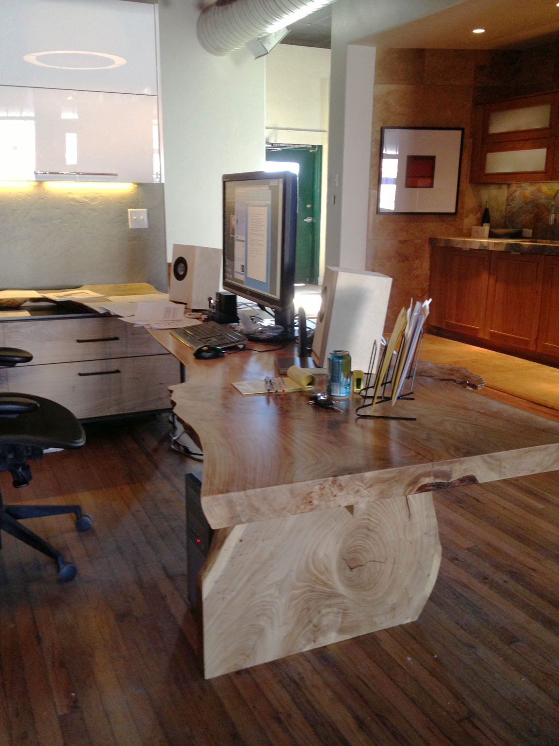

The three designs listed above would likely provide pleasing results. It would help for us to know your specific performance goals to discern which design would best fit your needs.
I spend 8hrs a day behind my computer so I’m looking for a “good as possible” desktop solution.
My Desk is located in a retail store and there are some limitations.
The actual desk is very shallow so I currently cannot get the speakers back as far as I like.
Speaker location off the floor needs to be taller than normal (40” to 45”) to be at ear level, minimize reflections off the desk surface, and produce better imaging.
Speakers will be pulled quite far (6 feet) off the back wall. And there is a walkway behind them.
They need to be a slim, attractive design since they are out in the open.
I’m not sure what qualifies as near field but I am finding I like the sound with the speakers about 4’ apart, and about 4’ to 5’ back from my listening position.
With the 6P Fonken’s aimed up and with my chair rolled back the sound is crazy good. These replaced a set of Tekton’s with Fostex 127’s and I understand the Mark Audio magic now. Really different sound.
The obvious solution is stands, but I am so enamored with the Mark Audio Drivers I want to try some additional models and designs. I’ll use the Fonkens at home.
Greg’s Design looks pretty much what I’m looking for proportionally, provided the enclosure works with the 10.2. I would be tempted to build it without the brace for the super skinny version, but it sounds like this should be avoided.
Or Jim’s version with a 10” taller cabinet and dead space below the enclosure will work too.
Jim, Your Floor standing Alpair 6 design looks really interesting too!!!
I wouldn’t mind building these also so I can compare with my Planet 10 boxes. Have you shared this design publically and will it also work with the 6P (looks like yours are6M)?

I never knew it would sim so poorly - is it lack of stuffing? Anyhow, I was trying to point out that there are thin 4 in designs around. It's tough to beat rectangular csa MLTL for a smooth response. Do you think the MJK sim would break down if aspect ratio became very flat? Well, at some point you run out of depth for driver magnet, so practical limit is like 3 in.
