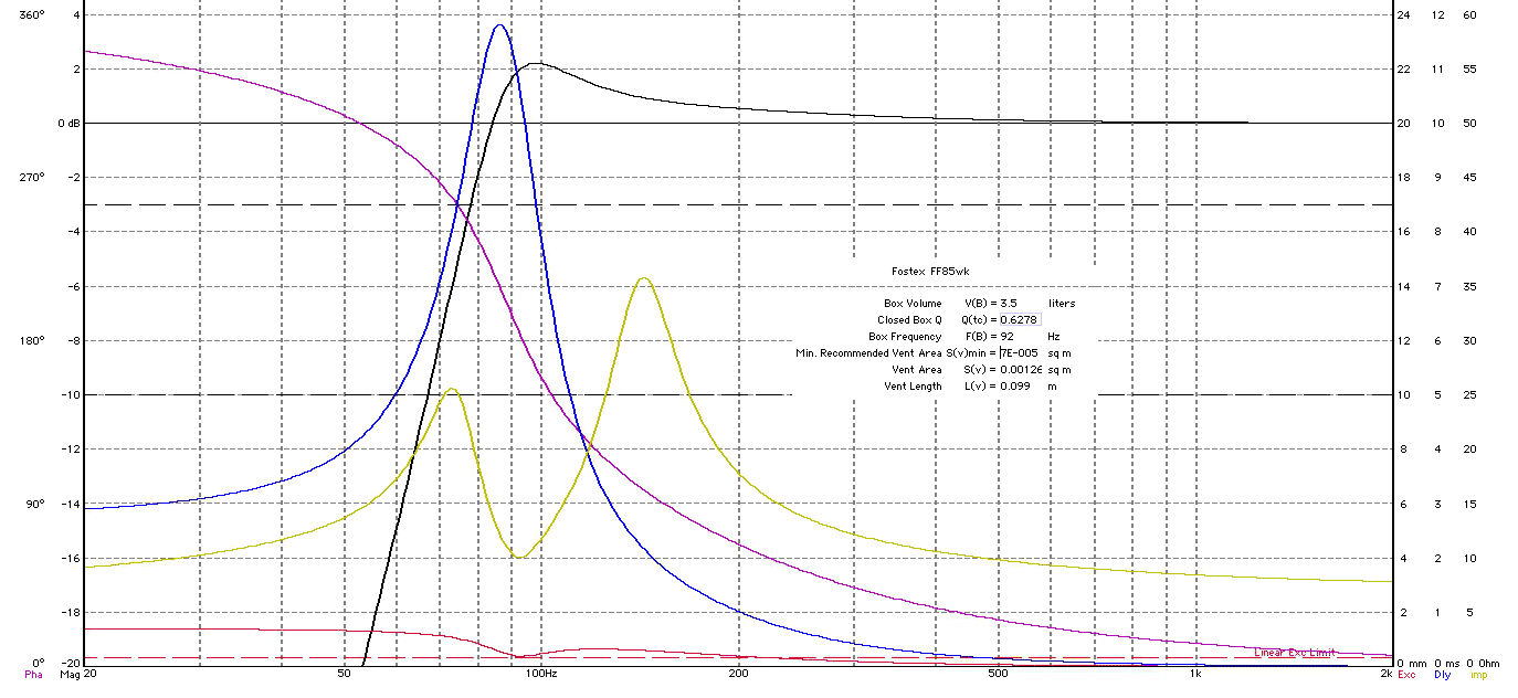

I am ready to order the goods for my first build. I want to make something small and simple using the Fostex FF85WK in either the Fostex-designed bass-reflex (3.5 liter) or the uFonken (2.2 liter?). Both enclosures do not look too difficult to make.
Could someone please let me know how different the two enclosure types would sound? Thank you,

A few years back I built two pairs of small vented enclosures for FE127E - identical in volume and tuning frequency; one with standard round port, and the other with narrow slot vents (which in small enclosures are easily incorporated into bracing scheme)
The standard BR had more pronounced lump in the frequency response, while the slotted design was leaner in that area, but had more definition (I like to use the term articulation), and extended deeper and more smoothly. The latter design became the template for what Dave now refers to as the "milli & micro" series - with adjustments in CSA and depth of slot vent, including the use of filler/spacers, this topology easily allows for a wide range of adjustment for different driver's T/S parameters.
A simulation of the factory BR is not encouraging, but not the "cruel joke (jw)" that the FE126En factory BR is.
The uFonken is 2 litre, the uFonkenSET 2.5 litre
