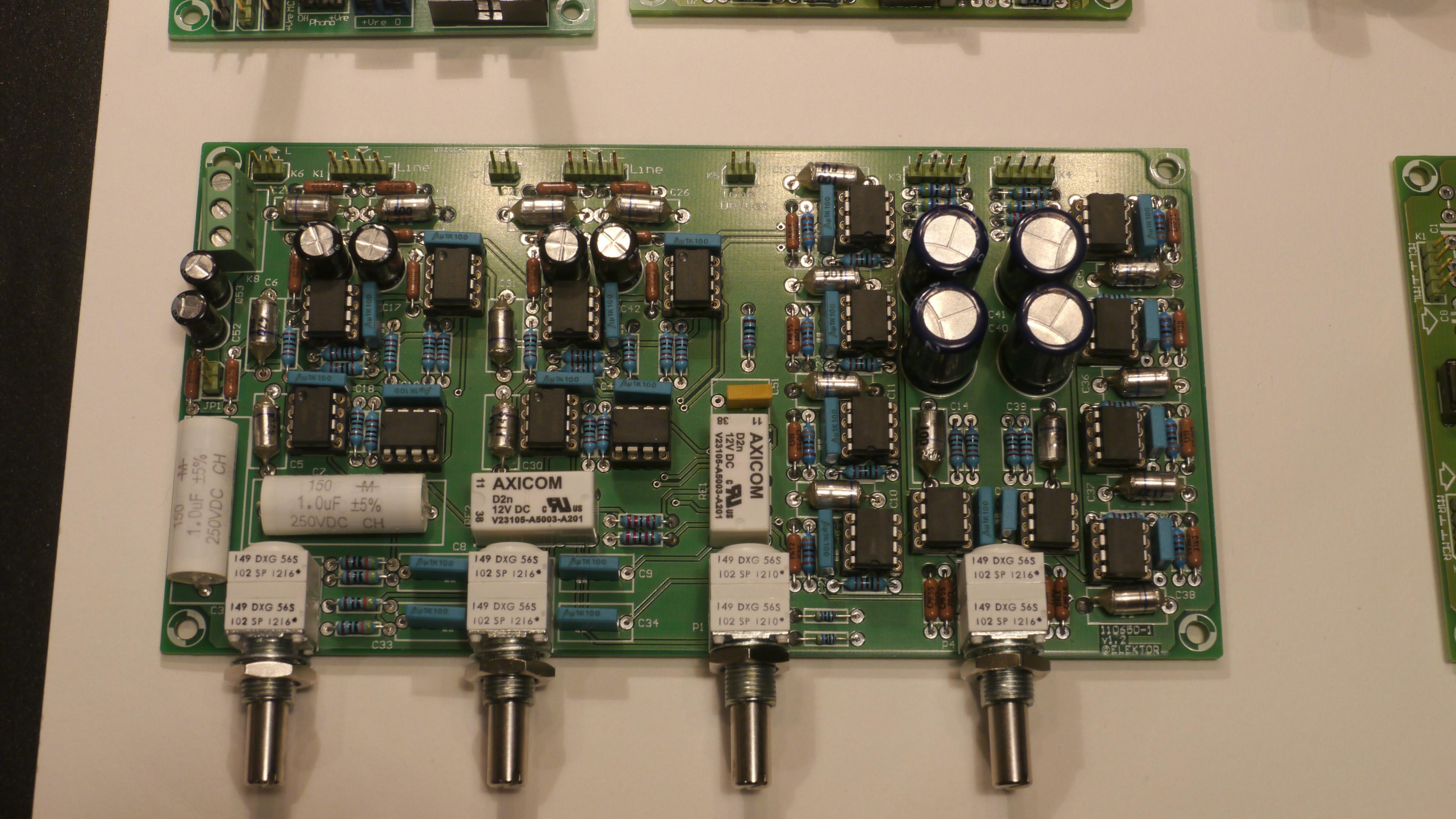

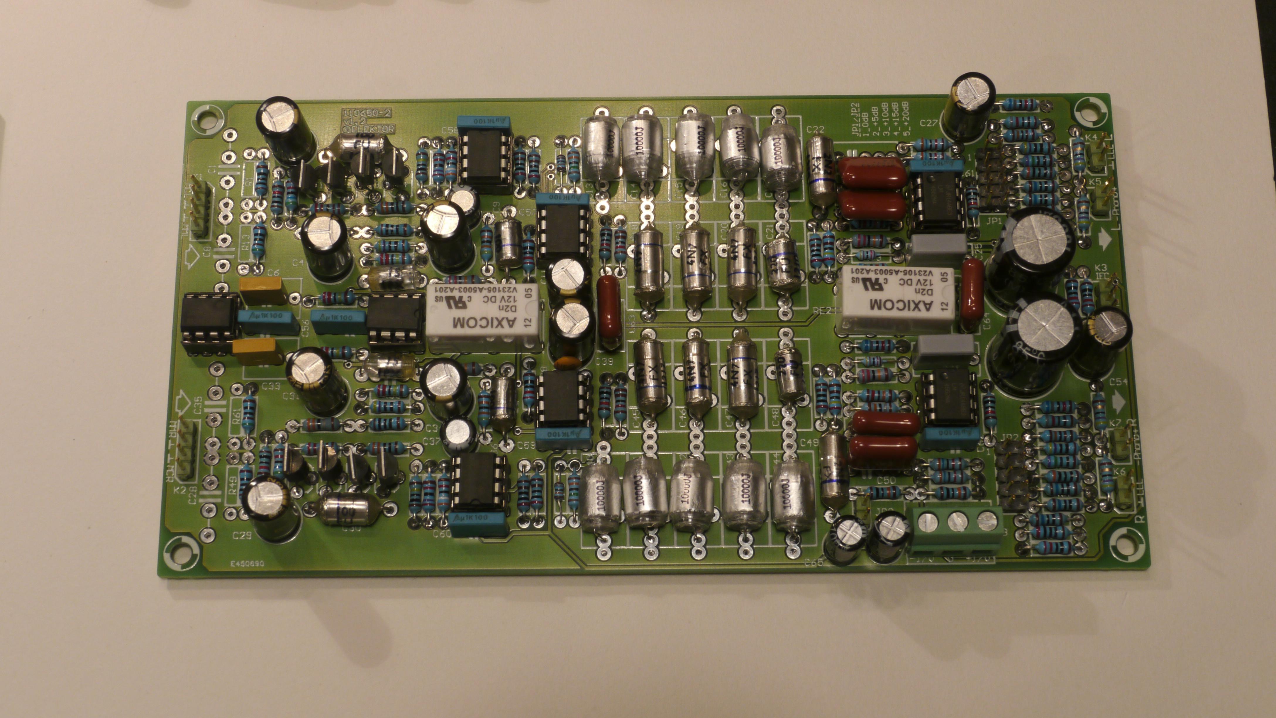

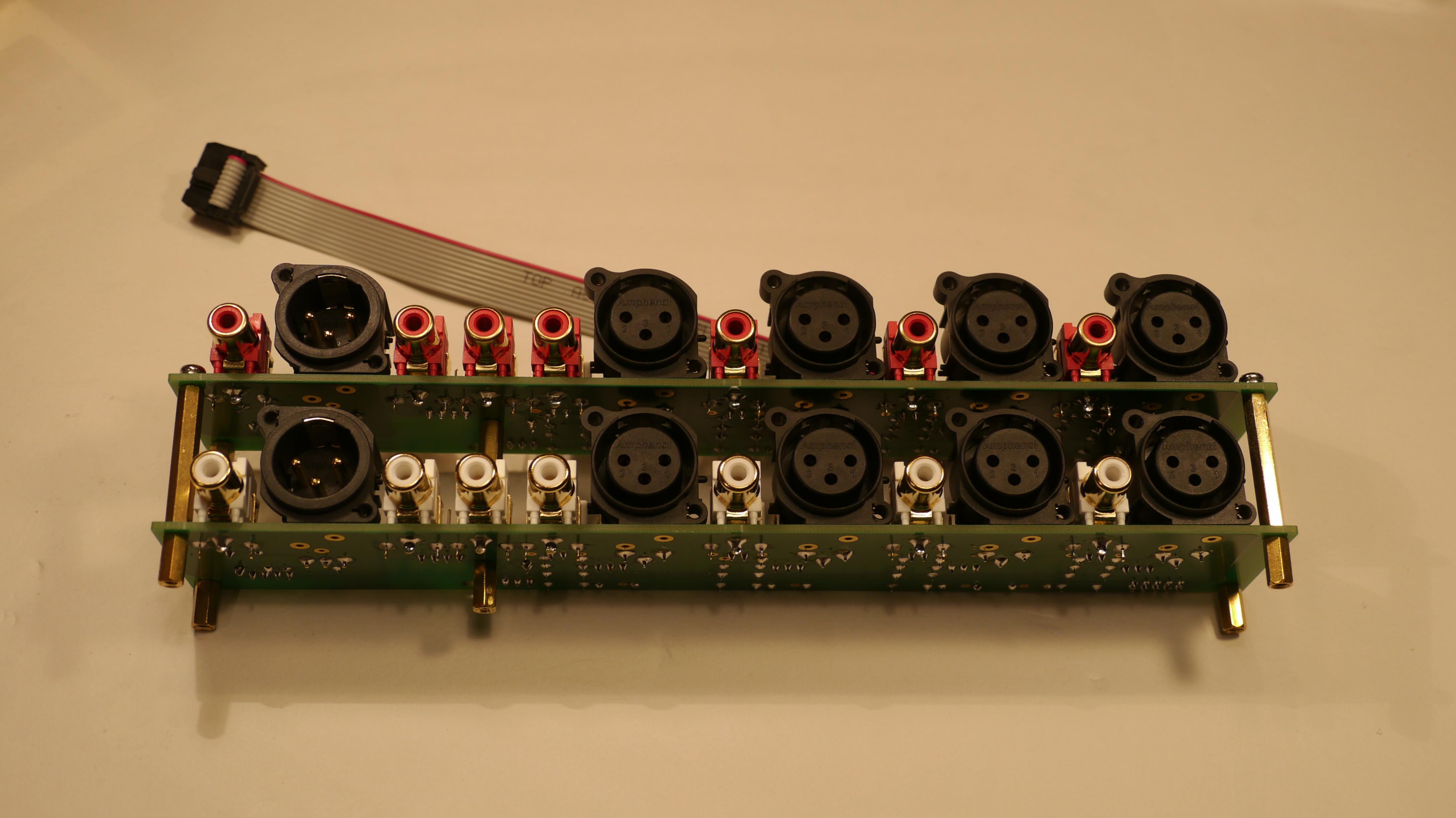

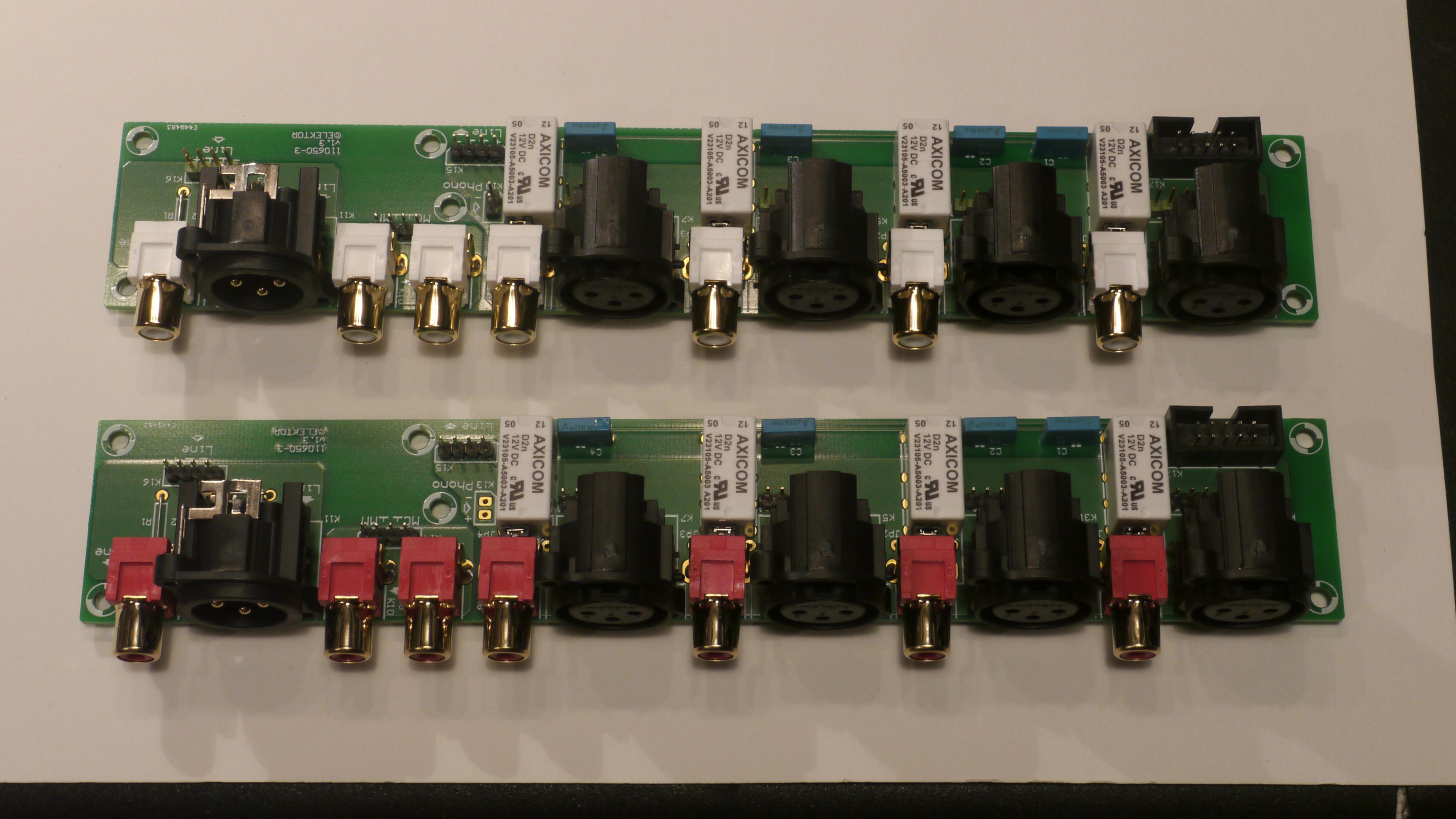

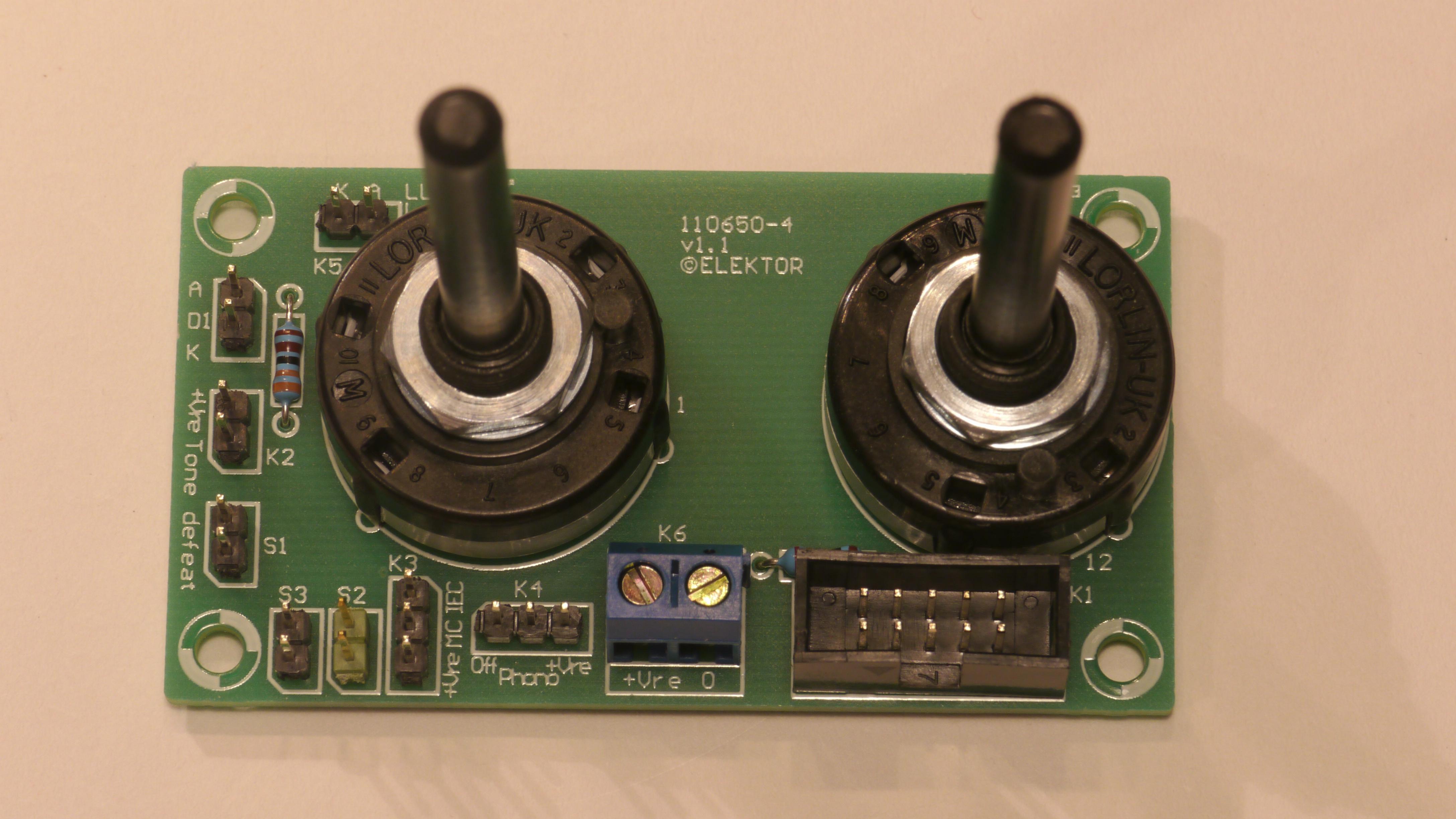

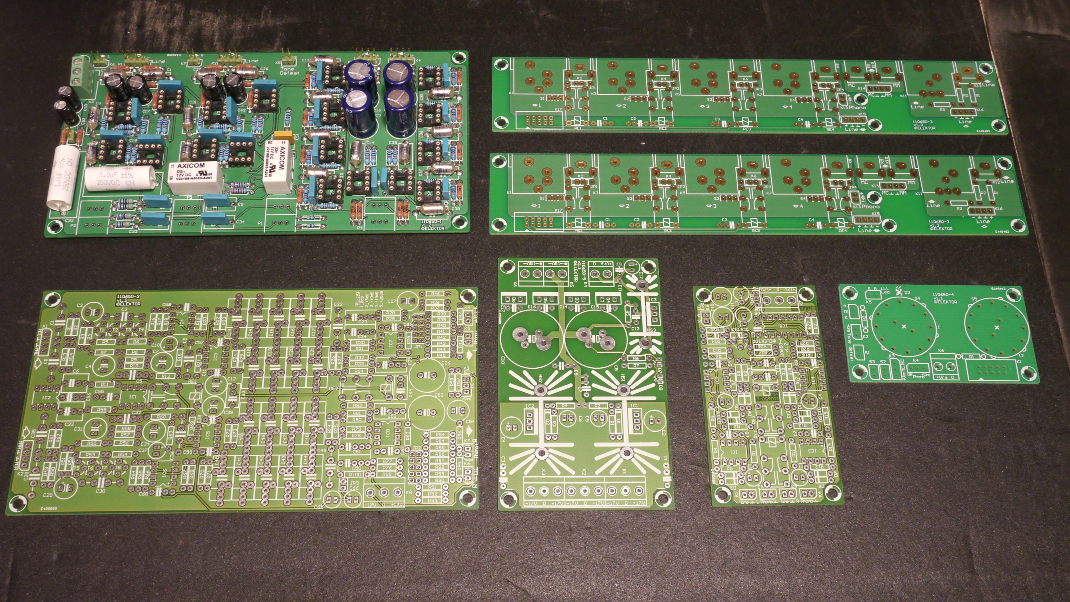

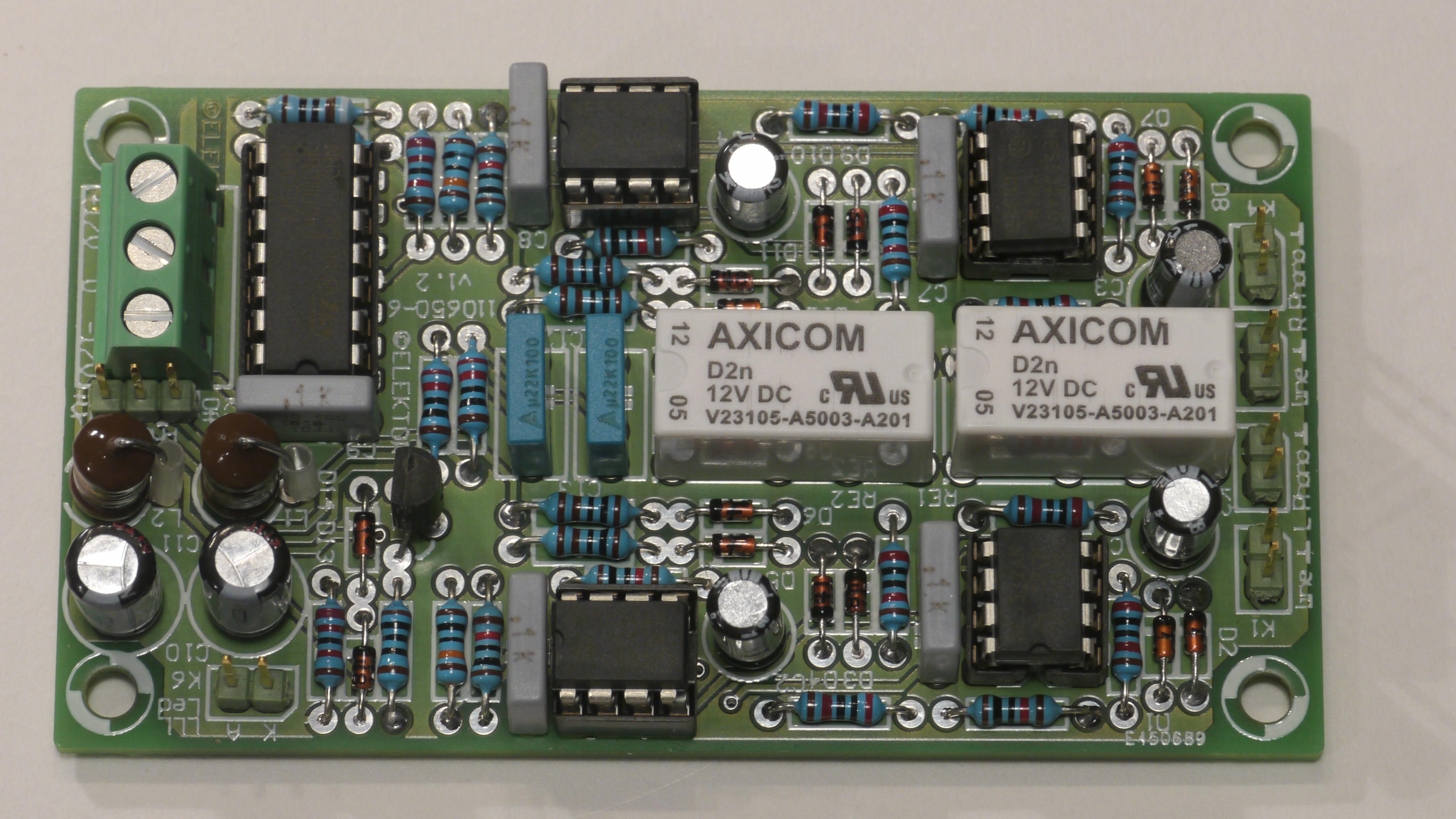

Thot I would start a new thread on the build and construction of the new Doug Self's pre-amp as published in Elektor. This is intended primarily for construction, build techniques, and enclosure topics. Be sure to include lots of pictures! :D

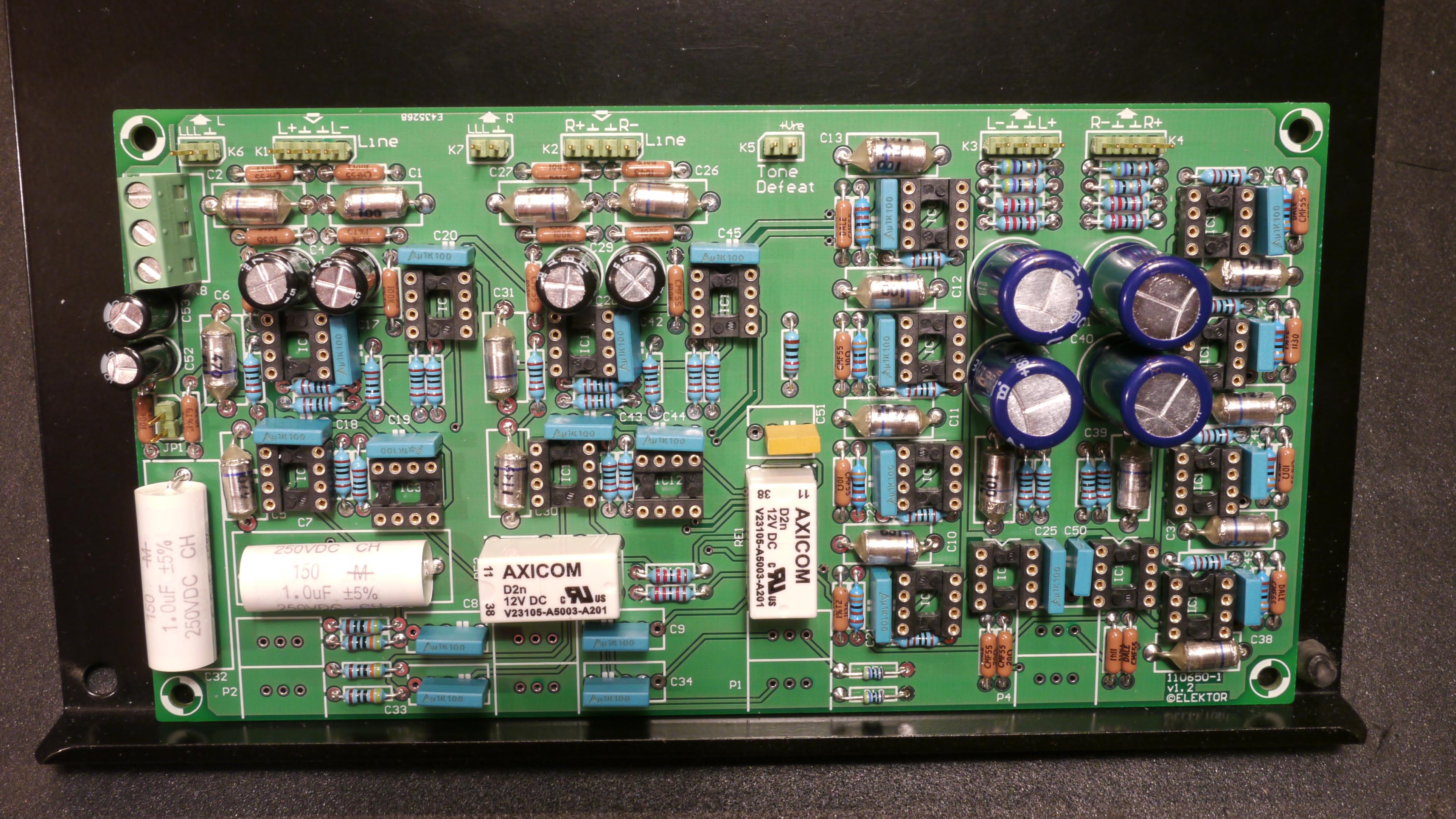

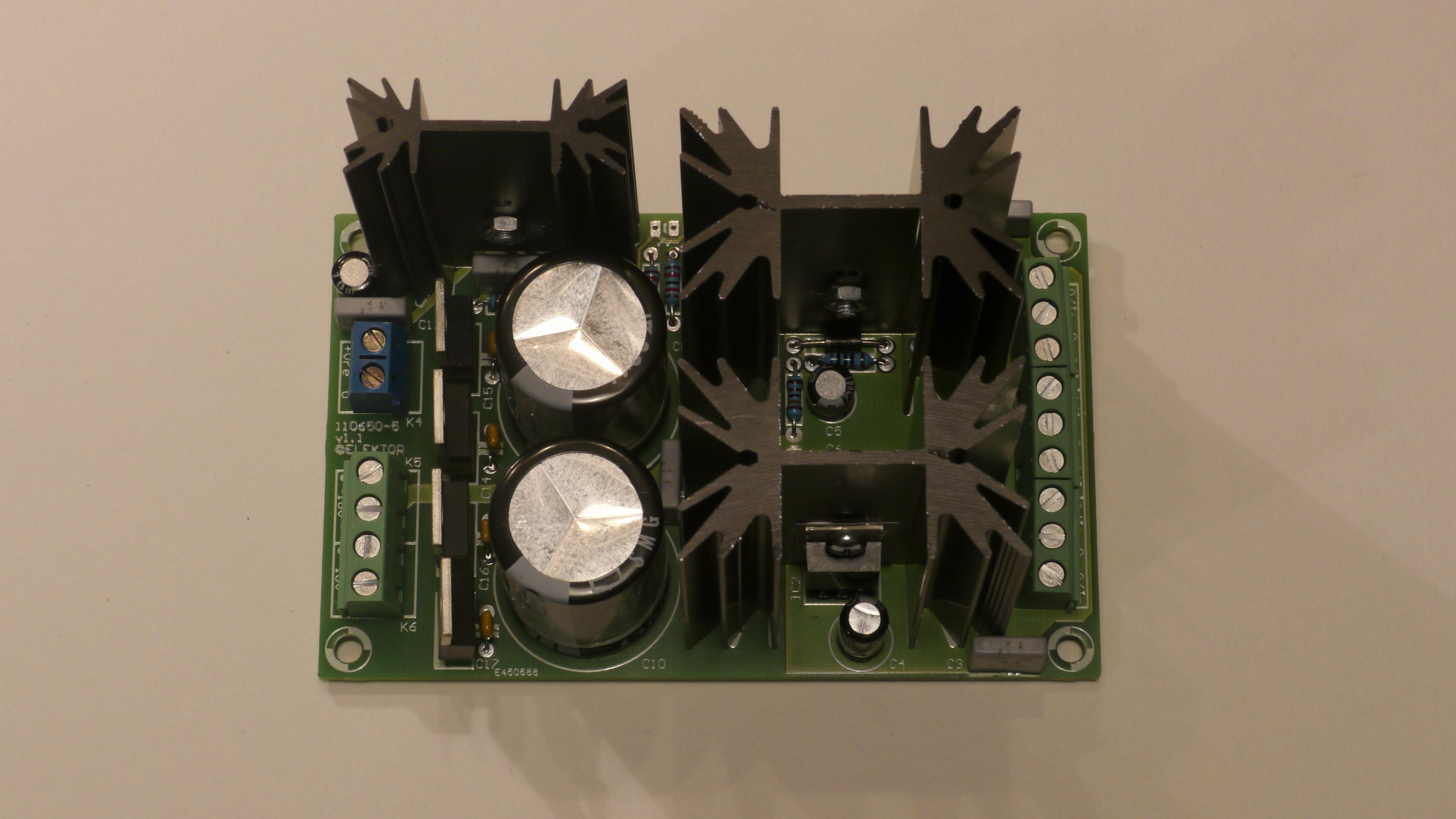

I've started it with a series of PCB pics - both empty and populated. More to follow as I embark on putting this all into a custom case.

It is/will be expensive. I don't know the exact amount, but the PCBs alone with shipping from Europe were close to $180. The 1k pots from Newark/Element are ~$100 total, although I've since heard reported similar ones can be had for way less. Other components probably totaled another $200-300 dollars. But mind you... I bought all exactly spec'd parts as called out by Doug's design and implemented by Elektor - mostly from Newark/Element and some from Mouser. Many parts had to be back-ordered when I purchased most of them in the Spring. So that slowed things down. I just found I could navigate and lookup parts much easier on Newark than other supplier sites. So, all my parts were new. I didn't use any parts from my junk drawer! :p I know, not very DIY..ish. Plus I bought way more header pins, female header connectors and sockets, and other connector stuff like that, since I have some other projects going too. It's just kinda my approach. When I sit down at my bench to work, I like to have everything I need right there, and not have to go looking or scrounging around to find something! I'm sure many parts can be found a little cheaper if you want to take the time to visit multiple sites in the process.

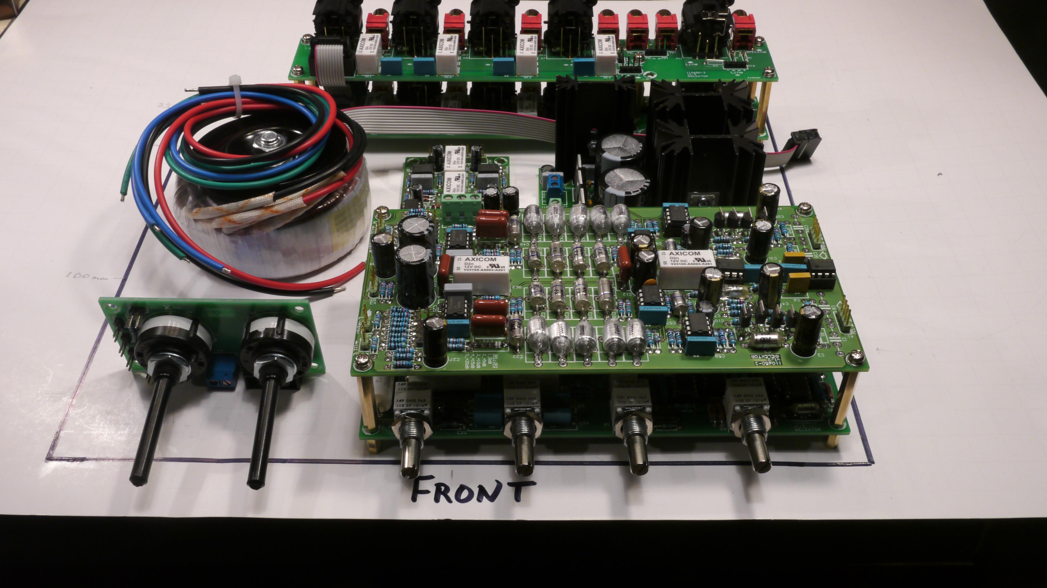

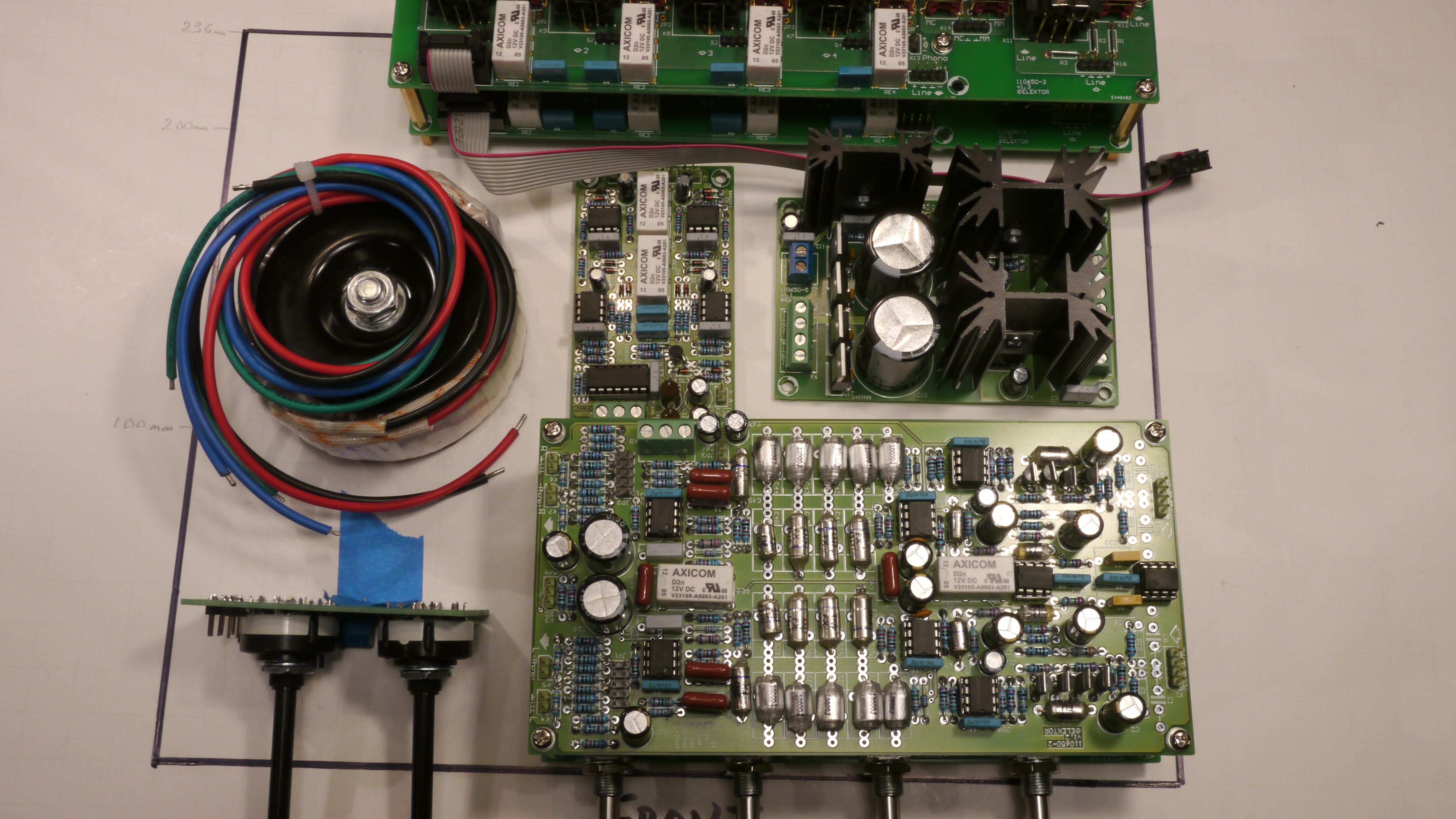

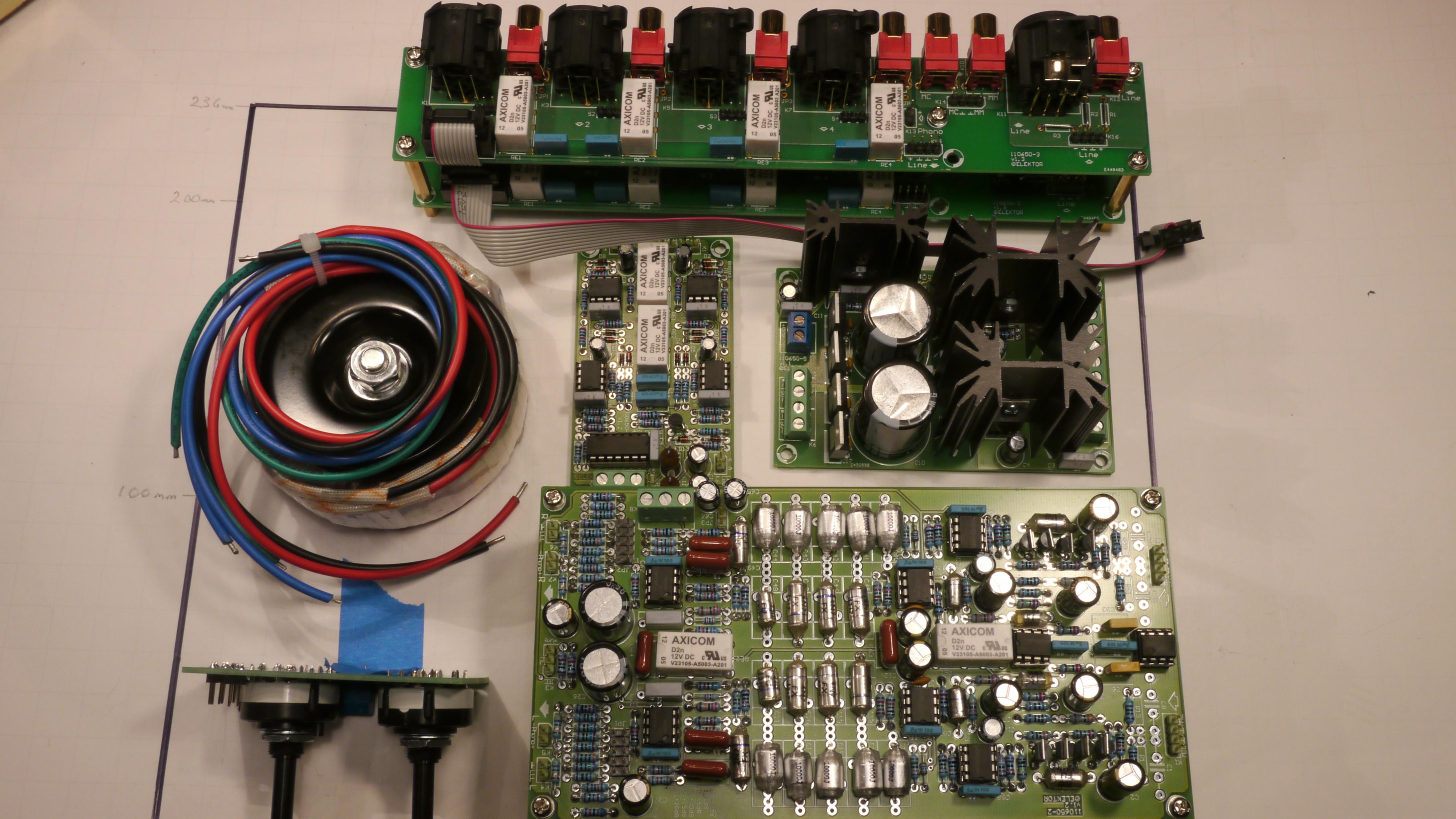

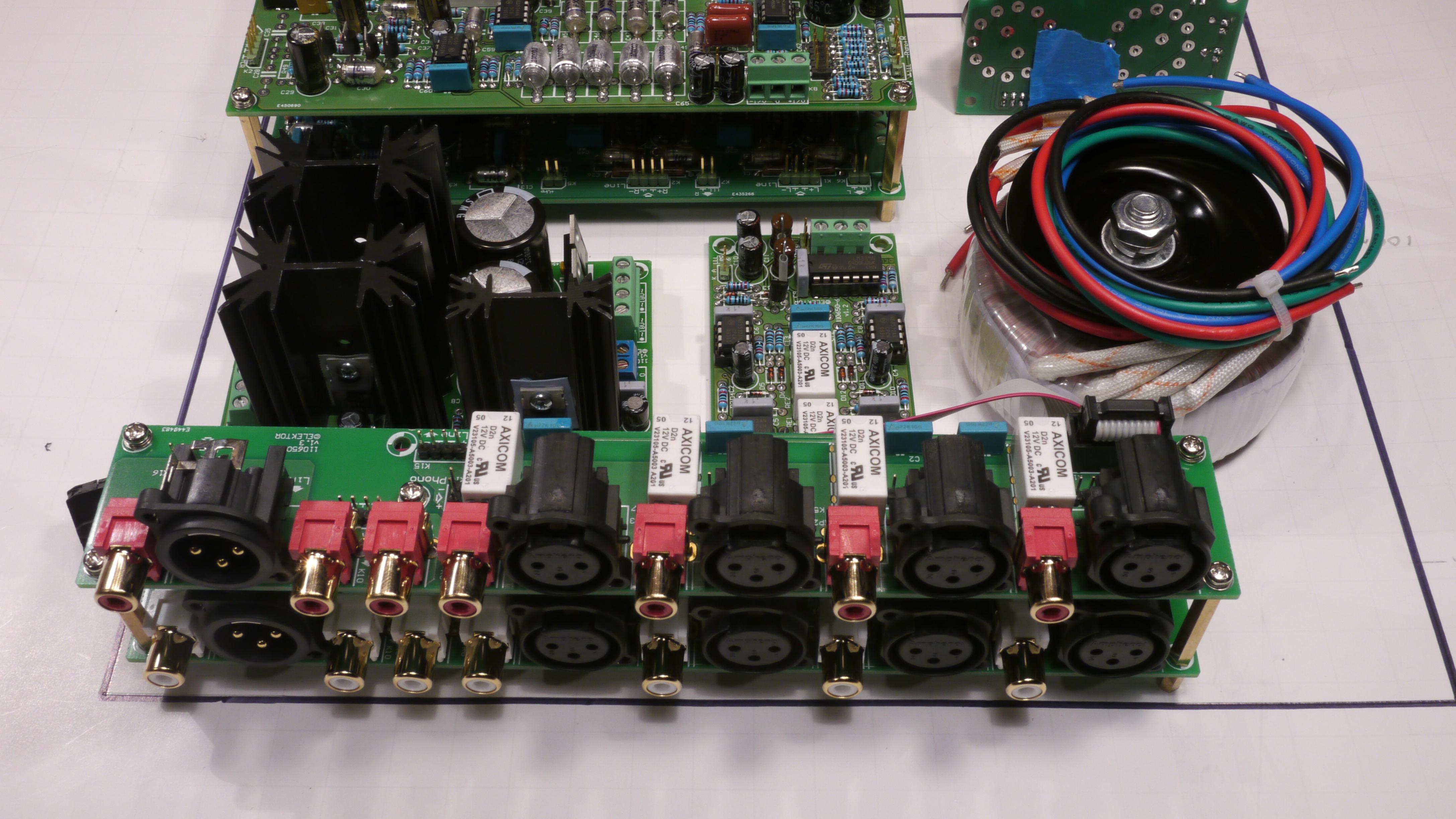

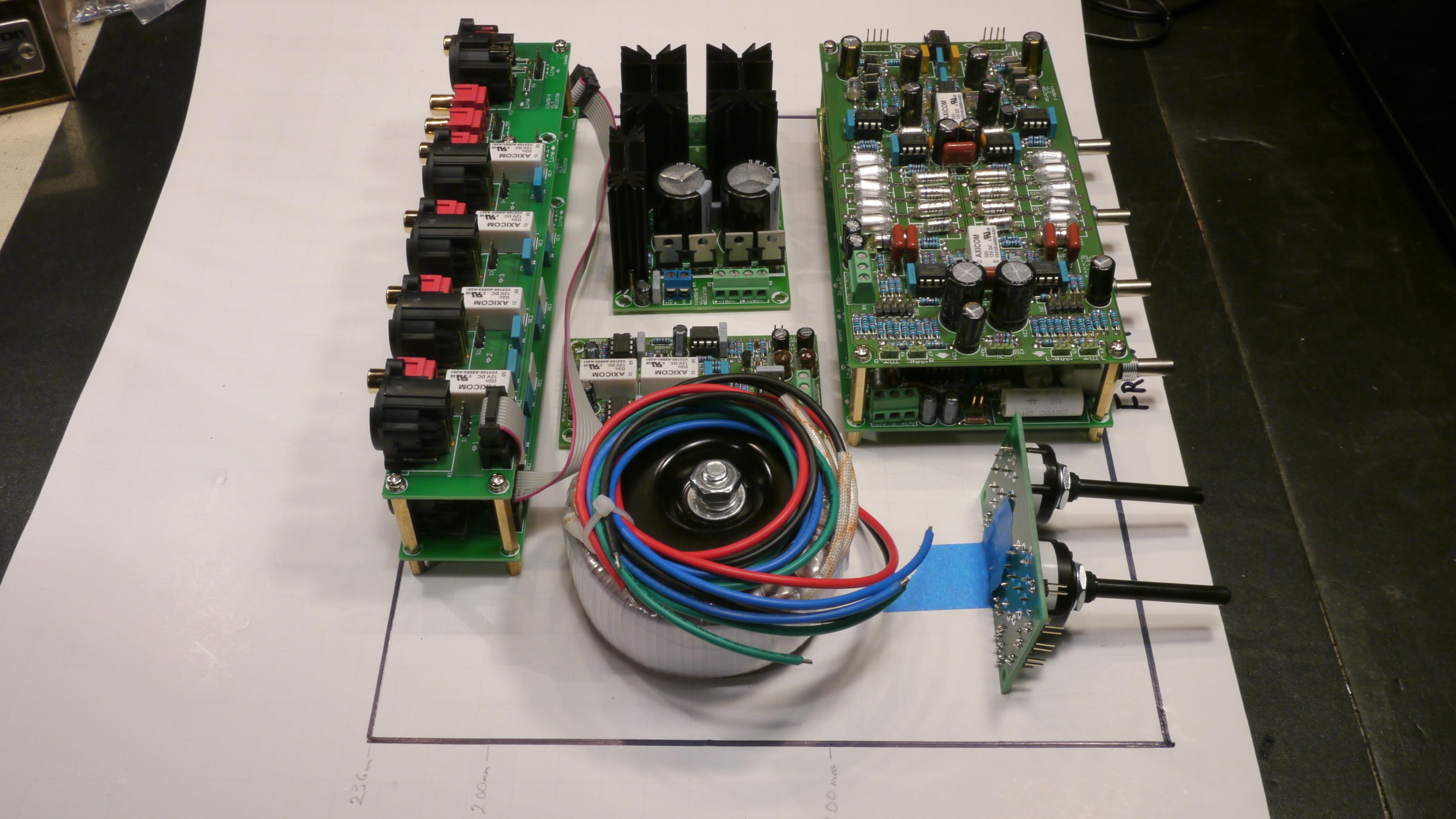

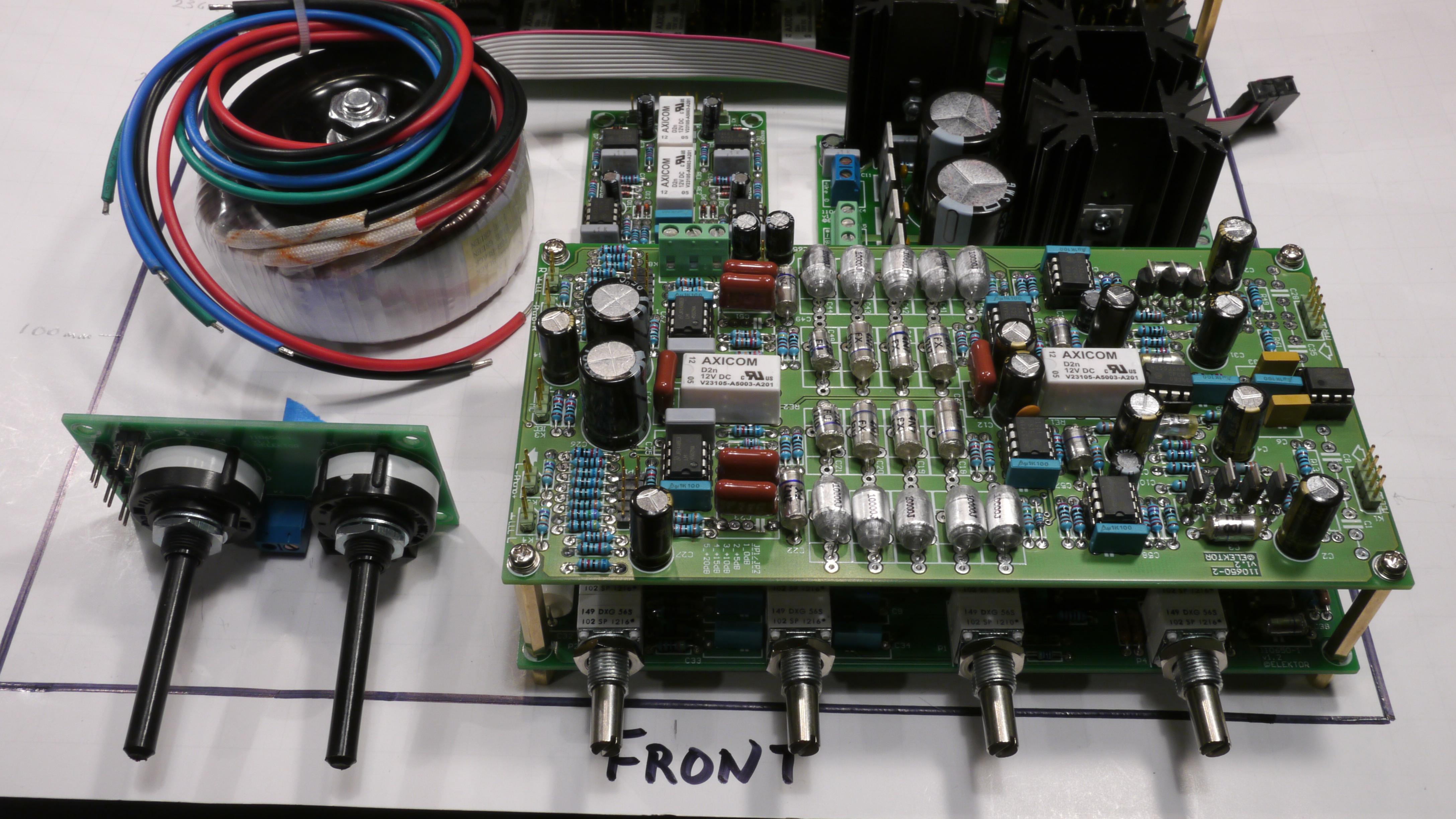

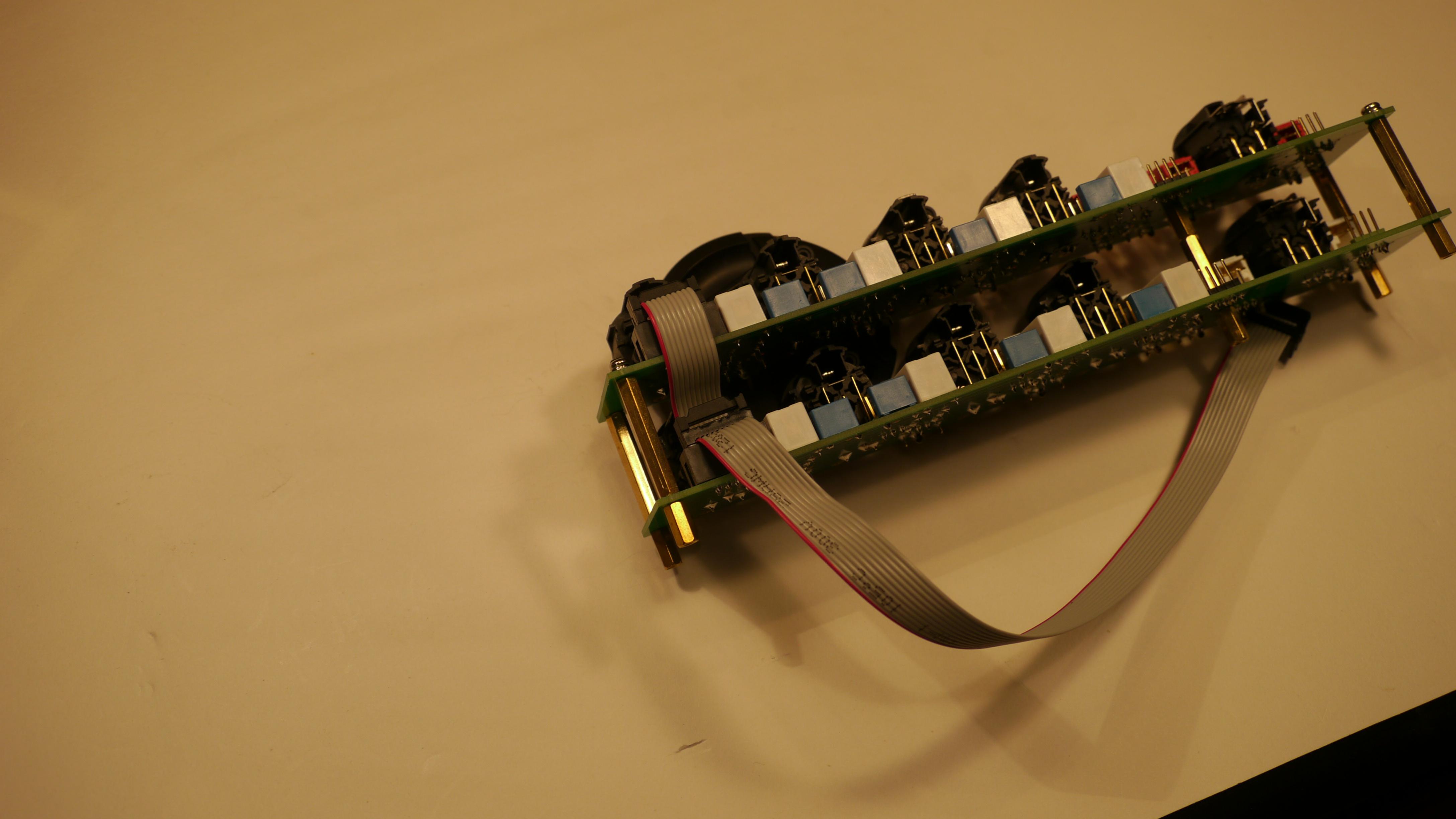

Here are a few pics where I've mocked-up the internal layout of the PCBs. This layout would fit a case with minimum internal dimensions of; 300mm W x 236mm D x 74mm H. As you can see, this size is very snug fitting for everything that's got to go inside for sure. I found an enclosure on eBay from a supplier I use, and it looks like it would fit the bill beautifully. Here's the link if interested. The price is very reasonable for a case that size. Too bad the shipping is almost the same! :( There is also another case that I used to build a power amp in earlier in the year that would work also. If I bought another one of those I would have a matching pair. :)
While these pics may not be of interest to the community at large, I find doing this layout exercise very useful in helping me determine the dimensions of enclosure I need, fabricating wire lengths, and ultimately how the wire routing may be done. Hope this helps.

Nice work redjr!
One suggestion: if you used a standard 430mm wide rack chassis or similar, you could space the transformer further away from the sensitive circuit areas. It looks close enough to potentially induce hum/buzz in your proposed layout.
Hi owdeo. That same concern crossed my mind too. Rack-mount size is just a little bigger than I need this project to be, but I understand the issue. Perhaps with some very well planned out wiring I can avoid that pesky induced hum if it raises it's ugly head. :D But, you really never know how much of an issue it will be. If I am faced with some induced hum I could try shielding the traffo with a metal cover, or worse case take all AC power outside and put the PSU in another, separate enclosure. Obviously that's not my first choice, so I'll have to wait and see what hum related issues (if any) I end up with.

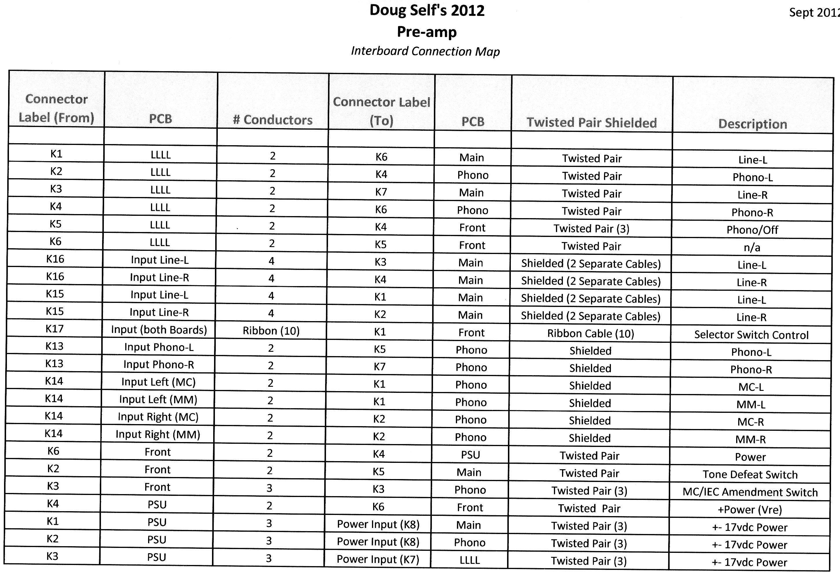

pre-amp Intra-connect Map
Since there are so many intra-connects required for this project I thought it would be useful to create a map. This not only provides a guide for the fabrication of the specific cable, but also serves to identify just how many I need. This is going to take awhile! :D Once I'm satisfied with the final layout of the PCBs, I'll have a better idea how long to make them, and where the routing should take place to avoid hum issues(if they occur).
This is my first pass at this map, so there may be some errors, or typos. If you've been following the articles in Elektor and notice a mistake, please feel free to post it here.

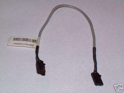

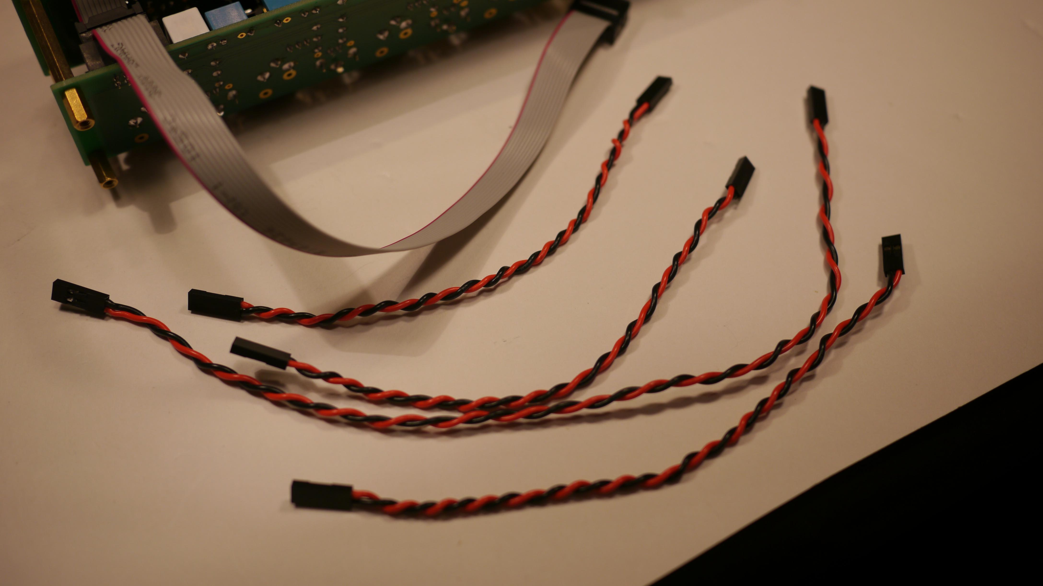

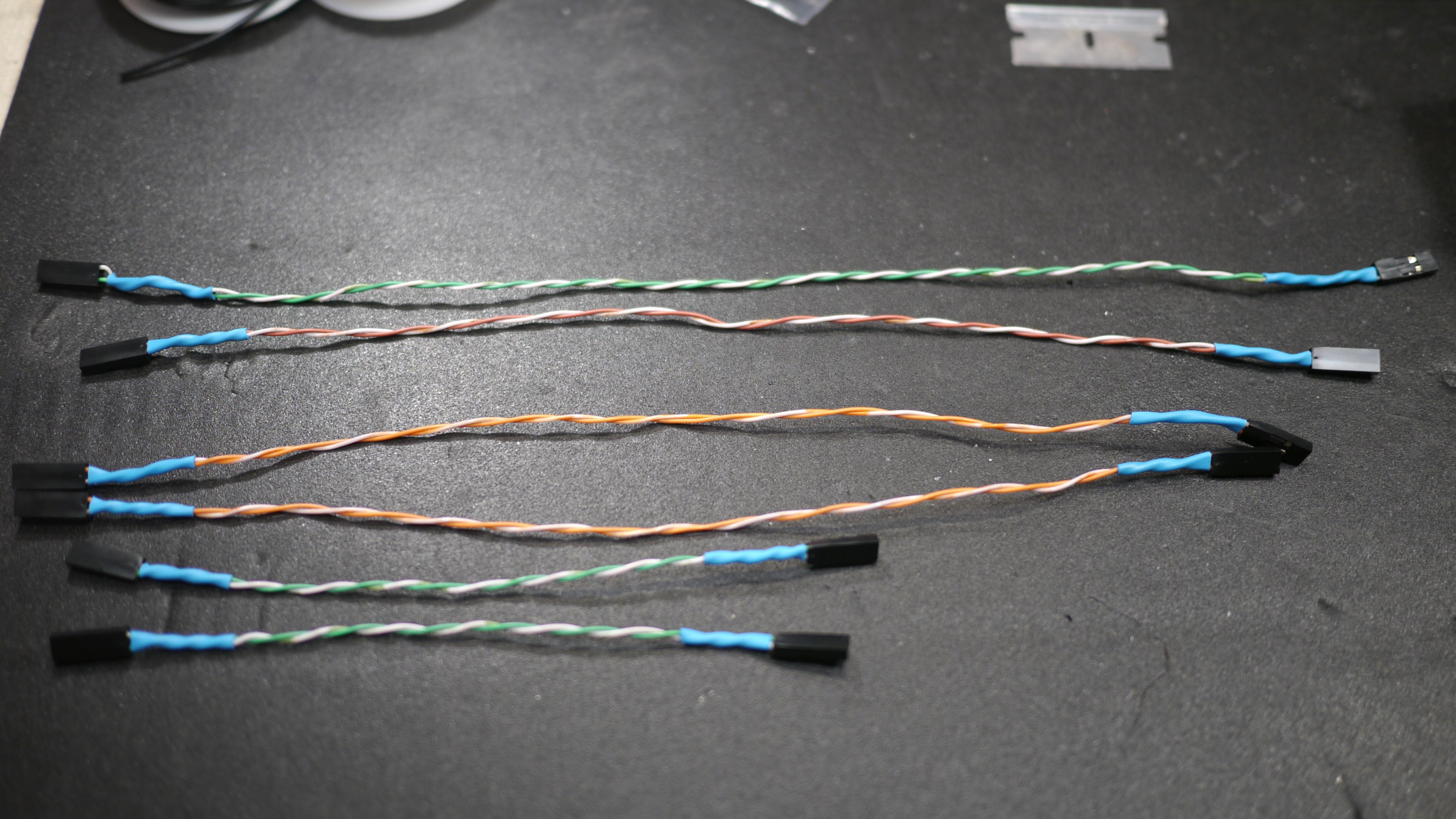

I had a change in strategy with the control intra-connects. I decided that the guage of wire I was trying use at first was too big and more difficult to twist. Enter... CAT5 wire that's (a) the proper gauge for the tiny connectors, (b) more flexible to work with, and most of all (c) plentiful - at least around my house! I've elected to fabricate various lengths and during final construction cut to exact length and solder on the other end.
For the shielded cables I will need to and from the input PCBs, phono board and the main board, I found some custom 9" lengths complete with the 4-pin connector on eBay. And you can't beat the price @ $1.00 each. Seems like a suitable solution if 9" will work with your build. I ordered a few of them, but I'm prepared to also make custom lengths - if I need to - during the final placement. PC sound-card cables work well and are generally 24" long. The 9" cable on eBay can be found here.
