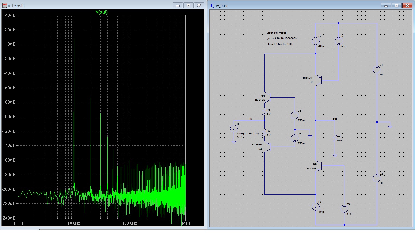

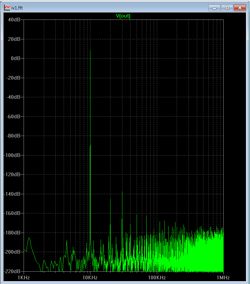

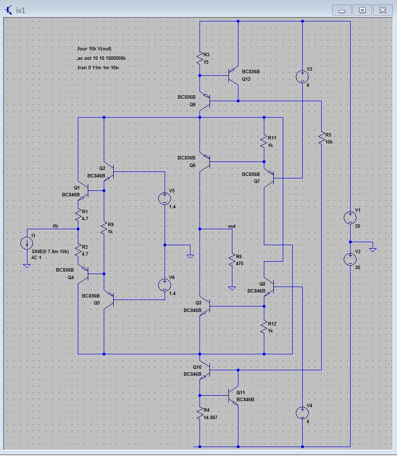

This circuit dont use feedback, have 3,5 ohm of input impedance, and very low distortion , it gave only 0.000005% of distortion in the LTspice simulator at 2,5Vrms.
Yesterday, come to the conclusion that i need a new dac, so i will use the pcm1794 and dir9001, just because already have them.
I dont like the I/V of the pcm1794 datasheet, so i remember to use a circuit that i have design for a non feedback amp.
in attachment there is the asc file for the simulation. dont forget to go to control panel / compression , and turn off all compression for better visualization of fft.
if you have any doubt please fell free to ask

Just a few comments. Real life might have more distortion because you won't get such near-perfect cancellation in the push-pull grounded base BJTs - you might need offset trimming. You seem to have bias applied from voltage sources via emitter followers: the followers will degrade the perfect voltage sources (in simulation - real life will be different), and of course followers work by using feedback. You might not have signal feedback, but your bias uses feedback.
DF96 this is only a simulation circuit, not the final project.
of course the circuit need offset trimming, a dc servo will be use.
the voltage sources will be replaced by zeners or voltage references.
when i say no feedback, i mean no closed loop (global feedback).
i will post a more simplified circuit, for better understanding.
this is the more simplified circuit. and have 0.008% distortion.
the only sources of distortion are the currents from the bases of the transistores( that's the reason for using the extra four transistors ),
and the fact that the 2 current sources in the first circuit are not perfect.

You are using a perfect current source, infinite z out. DAC's in real life are worse.
Use a voltage source instead, and put a 1k resistor between it and your input. This is closer to reality. Use 1Volt per ma the DAC puts out.
Better would be to build and measure though...not much sense to believe these Simulation numbers, you might be disappointed.
This is very similar to Dr. Leach's moving coil head amp:
Moving Coil Cartridge Head Amps
So, you will achieve lower noise and lower input impedance by removing the emitter resistors R1, R2. If you use current mirrors as suggested by Dr. Leach, then a further improvement should occur. You can lower the input impedance even more by doubling up the input BJT's. I have a similar circuit that has about 1 ohm input impedance.
The DACs that you like have DC current on their output pins which will upset the balance of your circuit. The PCM1794a for example puts out -6.2mA of DC current. Something has to be done about that as well.

My doubt is - DAC chips don't put out sinewaves, yet you're simulating with a sinewave source. So I can't but help thinking all those zeroes in your distortion figure are rather meaningless.
A modern CMOS DAC such as the PCM179x puts out some very fast edges with rise times perhaps <1nS. Have you considered using transient simulation ? - you can input a .wav file containing a sinewave which will be somewhat closer to reality because it'll have steps. It will still not really be close enough though as it won't have all the out of band hash that's intrinsic to S-D converters.

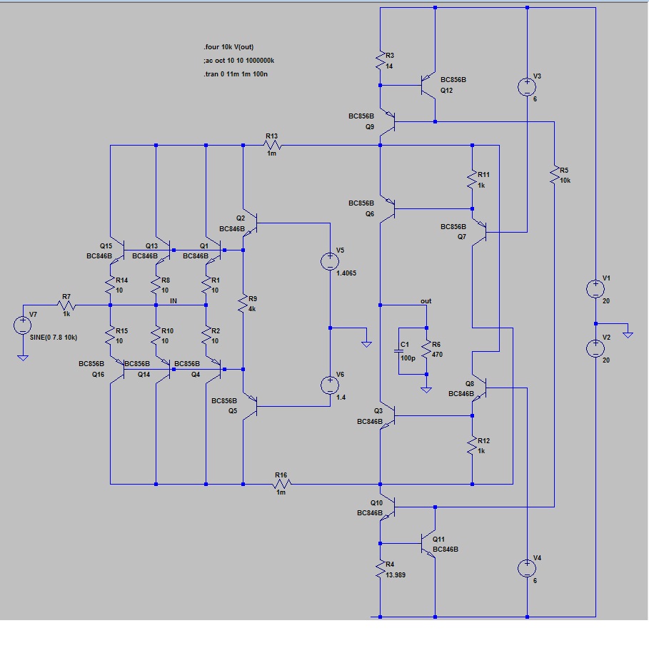

I tried your suggestion and got even better performance for my circuit in simulation. I was using a current source with 1Mohm impedance originally.
If I had an Audio Precision analyzer then I could verify the design in real life. The best I have is a computer based real time spectrum analyzer with a higher noise floor than the AP analyzer. Nothing I have has a higher spec than the PCM1794a chip, so there's no way I can verify or optimize what ever I build with it.
You may try to convert a sine to a .wav in LT Spice, and then feed the I/V input with the .wav
It's possible in LT Spice, but I never tried this.
Generally, I wouldn't trust sim distortion numbers anyway. It can give you a hint about the direction you can take, but exact numbers?
A common base I/V is a good starting point to build upon anyway.

Hi Zinsula,
i was told that the output impedance of the pcm1794 is 2M with 22pf, try to find in internet for the real value, but no luck .
this circuit was design with that in mind, with a source of 1k the distortion is a lot worse (0.008%). but i have made some changes in the input and got 0.000064% thd with 1k input impedance see circuit below
how do you come to 1k , i think is very low for a current source, if someone knows the real value please post.

sorry to disagree with you. but simulating this circuit with a sine source is enough.
this circuit is very fast and dont have slew problems, if you care to simulate in ltspice, you will see that there is no voltage variations, only in the output so there is no parasitic capacitors to charge and discharge. i will explain better how this topology works.
