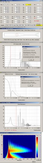

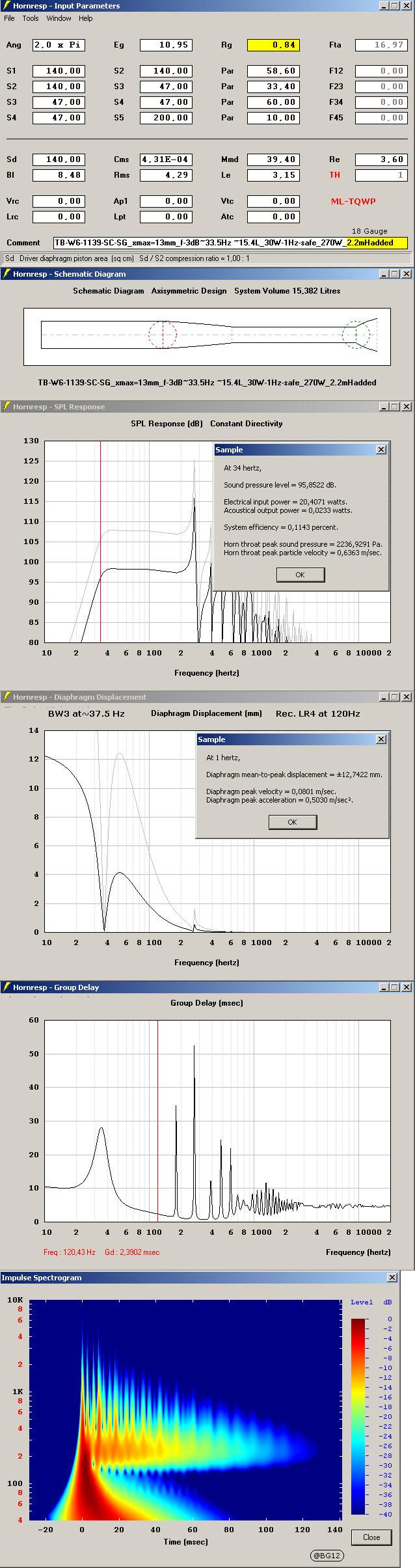

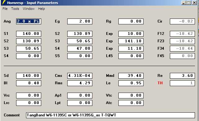

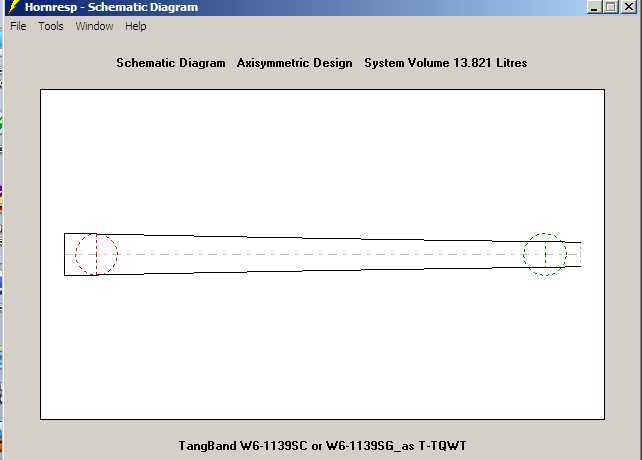

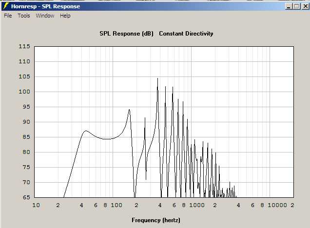

Hi 60ndown,
Maybe one of bjorno's T-TQWTs would fit the bill? V_net=13.8 L.
Hi Brian,
He'll have to take care of the low-end excursion with a filter anyway. For the BP4 the duct seems to get very long. Volvotreter's small TH may be another solution, it's not tiny, but would still qualify as portable (if one builds it with 1/2" plywood), at least it has a little more output.
