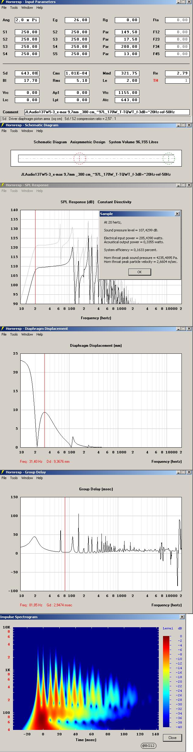

The somewhat expensive approach: Use a JL Audio 13TW5-3 driver in a ~96L T-TQWT...f-3dB=~20 Hz-80Hz
JL Audio 13TW5-3 Component Car Subwoofers at Onlinecarstereo.com
b🙂
