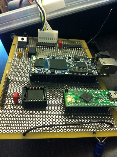

Hi Now I'm making my USB-I2S interface.
I made stereo and 8channel USB-I2S project 2007 and 2008,
https://sites.google.com/site/koonaudioprojects/usb-to-stereo-i2s
now expanding to 24bit 24 channels.
attached

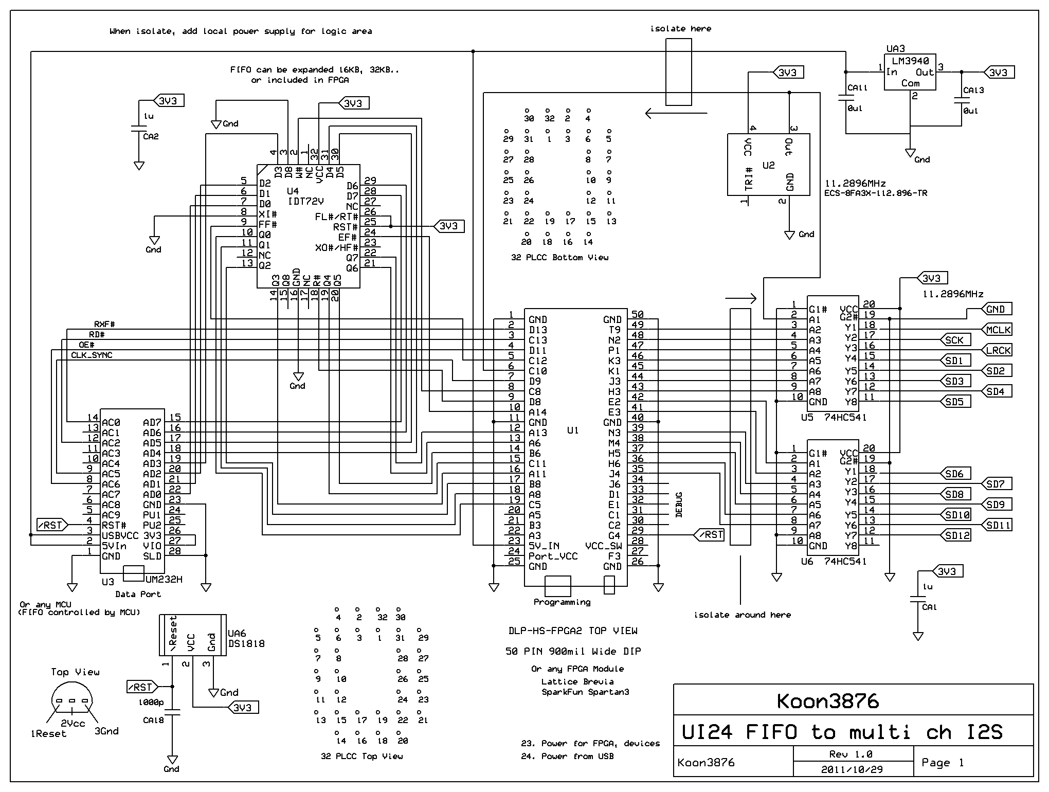

(1) Board photo, UM232H module / IDT72V FIFO / DLP-HS-FPGA2 / Clock, Power, Buffer
(2) Schematic.
(3) VHDL source, single, about 800 lines. 1300 FFs.
(4) ASIO Host Driver source, about 600 lines. (ver 0.1! I want to tune)
(you need ASIO SDK and free VisualStudio to build)
Hardware
FIFO can be changed to Cypress or faster one, if you want synchronous speed.
FPGA module can be changed. maybe GameDuino, Lattice Brevia, etc will work.
Clock, more can be added to switch 44.1/48/88.2/96.
Isolation, you can add IL711 isoLoop.
Power supply, is your free choice.

ALso, why are you using a separate FIFO? The UM232 has an onboard FIFO as well as 1K buffer. Are you using 512 bytes bulk transfer mode?
implementing FIFO in FPGA is possible, but it makes VHDL more long / confusing, and specific for Xilinx.
current design is very 'generic' and as I wanted, easy to understand. complex problem is broken down to ASIO host / FIFO / FPGA.
everything on the generic prototyping board, so anyone can change power / clocks / isolation.
on chip FIFO is too small. 1KB can contain only 13 samples, this is 68usec for 44.1kHz. No program can put next samples in this cycle.
Koon,
Can you explain a little more about:
1) How resilient this design is for jitter performance
2) How do you manage the FIFO buffer to avoid over/underruns? I assume the PC sends its data full speed but how do you manage the FIFO buffer control? Its not obvious in your code.
3) Do you have a description of the serial protocol you use between the PC driver and the FPGA. How do you differenciate between the serial samples (header, timing etc?)
4) As I understand it, a FPGA needs to be programmed every time it is switched on. Do you send the program over serial? Wouldn't a CPLD be a better choice (sorry I am FPGA/CPLD newbie).
5) For PC/USB isolation, I assume its best to isolate the 8 data lines out of the FTDI module so that any added jitter is buffered by the FIFO
This is a very interesting approach to USB audio!
dean: if you are talking about PC software clock / DAC clock buffering issue, This design is free from that. Only one clock drives everything.
(1) at the end of VHDL, you can see re-clocker. of course you can implement as you like, including power, isolation and buffers, on the outside of FPGA. (this is IL711 / 74HCxxx etc, DIP devices issue)
(2) see VHDL, the state machines run with "Full Flag" and "Empty Flag", and frame sync.
PC to FTDI: only processed when FTDI buffer is not full.
FTDI to FIFO: only processed when FTDI has data and FIFO is not Full.
FIFO to FPGA: only processed when FIFO is not empty and next frame requested.
FPGA to I2S output: MCLK (256fs) drives every bit.
(3) see C code, it adds 7fffff800000 as frame header. and in VHDL, you can see 7f->ff->ff->80->00->00 tracer state machine. If FPGA can not sync, all registers are cleared to 0x000000.
(4) FPGA module has flash memory. so power-on reset will cause reprogramming.
(5) "jitter" buffered to the FIFO? FIFO only has 00-ff data as result of writing operation. there are no information that "this D0 was recorded 15 ps earlier than next D1" all data lines are fixed when write pulse goes 0->1.

Hi Dean,
7fffff800000 : this is checked only at the starting of the frame. in the 24ch x 3 = 72 bytes sequence, there are no checking (see VHDL). so State machine always waiting for the header, then check, if OK, process 72 bytes data.
7fffff800000 means +1 (full top height) and -1 (bottom) of PCM. if your wav always contains this pattern, that is not music, should be full volume square wave.
There are another method that 8bit/7bit encoding. But I just want PCM data transfer, not want to implement strict data communication protocol.
retry: when corrupted, the data is cleared to 0x000000. DAC will receive 0.
resending: when FPGA find corrupted frame, then.. send NAK to PC, clear the FIFO, and wait for PC? it will cause some msec silence. I think discarding 1 sample (1/44100) is better.
Isolation point: also it's your free selection where to isolate, .. but including FPGA into DAC area, or Clock / FPGA in same PSU area?
Sample rate: I'm simply thinking to add mechanical switch to change clocks.
you can modify the VHDL/C to include (a) Clock selection byte (b) Clock selecter / buffer.
D2XX: I don't expect much, only writing 512 x 78 = 39936 bytes per host cycle.
FIFO: I had IDT72V so I used it, and it can work up to 15MB/sec > 96k/24bit/24ch.
if someone wants to implement 384k/24bit/24ch, this is 27MB/sec.
