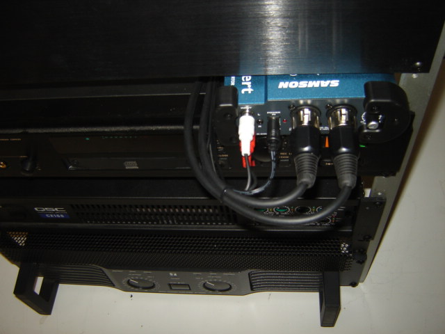

I did have a RCA to XLR converter from them (and vice versa), it actually sounded great. However, one ground came loose and the thing went south. Now one channel controls both and the right side is dead, it was $43 bucks (sale price).
Now using a Samson, which has a nice layout, using it a mini preamp (one volume knob).
No offense but I cant do Samson, Behringer, or other cheap stuff... dosen't look good in my rack
I really want that Coleman MS6, I've found one for $225 used. I'm waiting on a reply from the guy.
None taken, it was only a suggestion other than building one.
That’s not my good rack (-;
