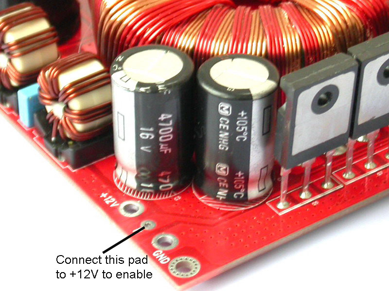

How to enable the module
Hello customers, sorry for the valgue instruction. To enable the modue, the pad marked with R must be connected to +12V. See the photo attached

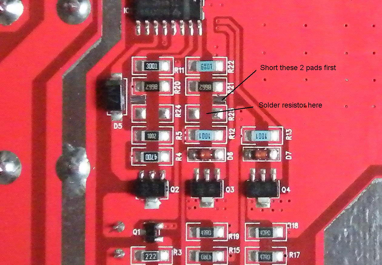

Hello s sorry for the late reply.
Please look at the schematic below:
the feedback network is formed by R24//R20 + R11 and R21//R25 + R22. Voltage on Pin14 is 5.0V. The voltage on Pin15 must equal to pin 16. R20 and R21 is actually 82.6ko. It's not quite complicate to calcualte the value of R24 and R25 with this conditions.
