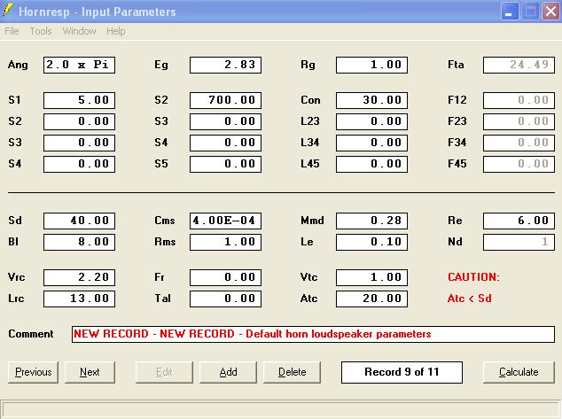

Thanks for the help, I had a look through the HR help manual and it makes sense now, so I should be able to get something happening on my own! I will eventually build a tractrix and le cleach but I will start with a square conical, simply because it is easy to build with stiff foamcor.
It seems that cutoff frequency cannot be entered for a conical horn (F12). Why is that? I can enter it for tractix and le cleach without a problem....?

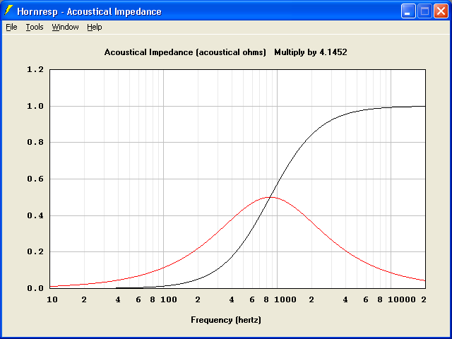

Hi dabbler,
A conical horn does not have a specific theoretical cutoff frequency. To illustrate:
Attachment 1 shows the normalised throat acoustical impedance of an 'infinite' exponential horn having a cutoff frequency of 100 hertz. Notice how the resistance (black trace) falls abruptly to zero at 100 hertz.
Attachment 2 shows the normalised throat acoustical impedance of an equivalent 'infinite' conical horn. In this case there is no sharp reduction (or cutoff) in resistance at a particular frequency.
