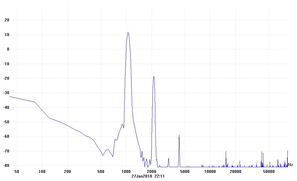

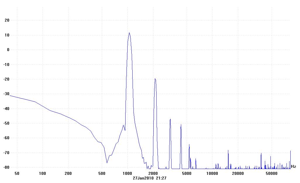

Measurements of a 6AS7 job doing an Edcor XSE25-16-7.6K and later same tubes doing a One-Electron UBT2. $25 vs $110.
One watt into 8ohms. Please ignore low frequency content, the amp was still in progress and had some hum.
As you see the Edcor does have some higher harmonics, likely only due to impedance being 'wrong' for these tubes, but I honestly couldn't hear much difference in the short listening test I did.
Response wise the Edcor was flat 10Hz-40kHz and the One Electron about 7Hz-50kHz.
