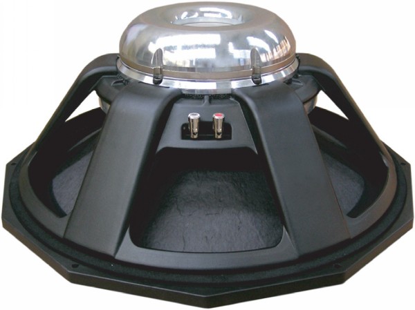

Two pictures of 21" woofers of same make
The new model with neo is the cheaper one
Maybe because theres much less iron involved, and less work
Unfortunately still very expencive
Clouldnt resist showing it bottom up🙂

Yes, very pretty magnet!
In pro use the weight savings are very welcome. Anyone who has worked on the road can tell you that. 😀
