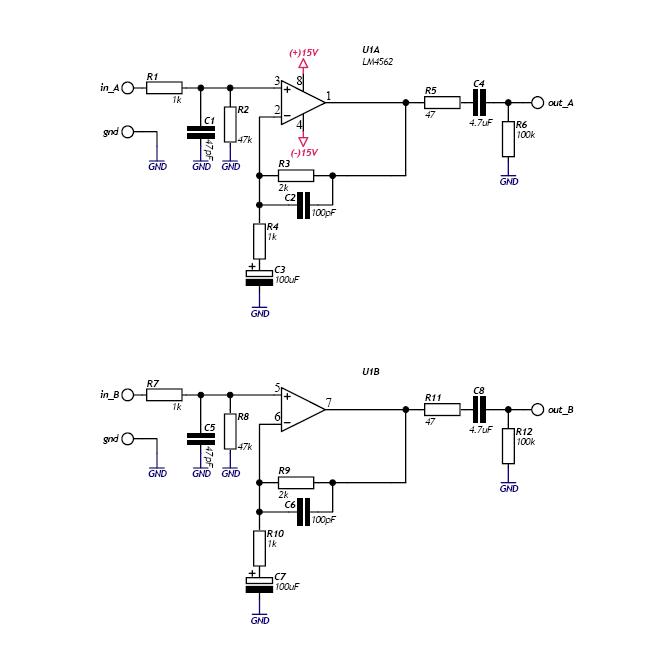

Hi all,
I am still working on a op-amp preamplifier + headphone amplifier project for my LM4702 power amp.
I have some LM4562, OPA134 and NE5534 to use that project. I dont use any capacitors on signal path in LM4702 amplifier. And also dont want to use any capacitor in preamplifier.
So I decided to use DC servo in preamp. I saw Damian's LM4562 preamplifier for gainclones on somewhere. Its very simple and looks goodworking one. However as you can see it uses capacitor on signal path.
I have two alternatives;
- I can use that circuit without capacitor,
- I can add a DC servo to it.
But the op-amps used for DC servo are generally expensive and low availabililty ones. I want to have my preamp very quickly, and I can find some LF411 and LF412 s in Turkey. May I use them for that project as DC servo? Because I saw that op-amps in original BPA200 project used for DC servo for LM3886s..
What do you say? May I use LF411 as DC servo for LM4562 or OPA134 (also for LT1210 in headphone amp) ? And works fine?
Thx in advance..

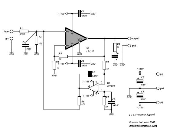

I examined the Gootee's web site.. However I am confused.
I will use 3 x gain for preamp. So for a shortcut solution;
As Damian's application for LT1201..
I want to use Damian's circuit with OPA134 instead of LT1201 and LF411 (or 412) instead of OPA604..
Do you think this is suitable for that opamps?
I am not sure, because in Spice analyse I could run this circuit with ideal op-amp sub circuits, however with OPA134 and LF411 it doesnt look like working. I dont know the reason but thats the situation.
Another way is to use MKP type caps on signal path. Do you recommend that?
Thx
That circuit will work fine with LF411, though you'll need to capacitively couple the input. There are one or two things you should do, though. First, eliminate R7/C5 and take the noninverting input of the 411 directly to ground. Second, split R6 into two 22-27k resistors in series, then take a 100nF cap to ground from their junction.
The latter mod adds extra passive filtering of the output as Andrew suggested.
The other suggestion is to return the servo to the bottom of R2.
Hi Ozgur,
I think there are a few issues with your last circuit.
1) I wouldn't inject the servo output into the same node where your signal goes. Look at gootee schematic how he did it.
2) If you for some reason want to keep that scheme, you can omit C5/R7 and simply ground the non-inverting input.
3) Keep an eye that you use an FET-input opamp. The LF411 is FET-input, so will work good. A more modern choice would be AD820.
4) Output filtering. You need to know what your worst case offset is. The lower (without servo) the better. If your worst possible offset is say 50mV+/- you can figure what the maximum output voltage swing of the LF411 is. Lets assume it's 13 V+/-, you have an ratio of 260:1. So you can set the voltage divider R6 : (R2||RinLT1210). Allow a safety margin and you might get by with R6 as big as 200k, which enhances filtering of the noise that is coming from your servo.

Hi Dx,
Post4 shows an inverting DC servo.
It has no filter on the input so the opamp has to amplify the whole audio and sub audio signal to extract the wanted sub-audio correction.
The circuit as shown also has no filter on the output feeding into the NI input of the amplifier. This allows any noise from the opamp/PSU to be injected into the power amp input without any attenuation.
In addition any errors that the opamp makes in extracting that sub-audio correction also get injected into the amplifier input.
Scrap that example and use one that filters both the input to the servo opamp and filters the output before injecting it back into the power amp.
Both the inverting servo and the non-inverting servo work. I believe it is easier to get the non-inverting servo to work well.
Gootee's example uses opamp2b to extract the sub-audio correction. Then opamp 2a applies active filtering to attenuate any remnants of unwanted audio and distortion and noise.
However this circuits works as a DC servo with the active filter wrapped around opamp2a removed. Then just use the passive output filter.
R8 & C4 are the input filter passing below 1Hz.
R13 & C13 are the output filter passing below 3Hz, if the second opamp is omitted. retain R1=R13.
This passive output filter allows slightly more audio through to the amplifier, but it is at a very low level and if designed correctly should be inaudible.
Hope this helps.
Hi Andrew,
don't you think R5/C4 in Post4 does the input filtering?
And output is filtered by the voltage divider consisting of R6 : R2||Rin?
If not, why?
Rüdiger
