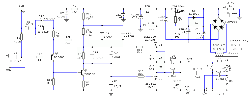

25W Class A amp with Lateral MOSFETs
This time I wanted an amp that will combine qualities of my F5 (made with k2013/j313) with a certain seductive gentlenes that comes with good tube amps (member p18 recently made a nice amp with 6C33C that inspired me). Comparatively, I wanted something like F3 but with more control, more gain, more power and insensitiveness to characteristics of source and speakers.
I worked for a few months on it and tried a number of ideas (best candidates were a circlotron with LU1014 and a single rail version of F5 with BJTs at input and Laterals at output) but the buck stopped here:
I chose single rail PS becouse it enables using the benign reactive component at the output that makes "sound tailoring" possible.
Transformer is 500VA (2 x 40V AC, one secandary per channel). Cap. multiplier provides smooth and fast source of power (1.5mV ripple at 1.3A). 10mf ELKOs are Siemens Sikorel, bypass are MKC in PS and MKP in direct signal path.
Q1 provides high Zin and Low Z feedback point. Q2 gives all the voltage gain (OLG is about 50dB), it runs on about 7.5mA and that's more than enough to drive a pair of Laterals in push-pull Source follower topology (there are jumpers over Source resistors which are taken off when setting the bias with P2 ; P1 sets the half of the PS voltage at the output).

Schematic :
636182d1505823180-25w-class-amp-lateral-mosfets-svaja-aspublished-gif
Version 2.0 - post #180

At the risk of sounding picky, 7.5 ma just sounds rather a lot to feed through a standard preset wiper for long term (many years) reliability. Fixed resistors maybe ?

The only thing I would have done different is put the transformer at the front of the case away from signal wires. I am not sugeesting it would make a difference to the end result but that is how I like to do things.

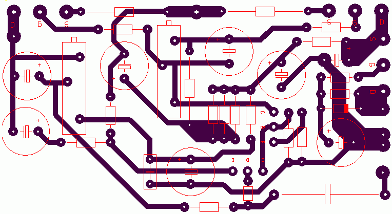

I have a pair of Toshiba laterals, which Ii bought some 15 years back for a elektor circuit and never completed. I also have a 35-0-35v transformer, for which I am looking for a project. Your idea seems a perfect fit. Do you have PCB layout, which you can share?

Anliva, which Toshiba laterals do you have?
As for PCBs, if you look at the pics you'll see that I make my PCBs by hand and according to my needs. I don't know if it will suit your needs, but here it is (copper/bottom view, 80 x 44 mm).
There are things to consider, to name some of them: most of bypass caps are soldered on the bottom side of the PCB, there are three 3k6 resistors in parallel instead of one 1k2/1W, MOSFET's gates are in the middle, between S and D, there are two GND wires that go to star groung, etc... You'll have to be very carefull if you want to use this PCB, this is not a layout made for beginners ;)

Since you asked me, I went and looked at the laterals with a magnifying glass. I am sorry they are not Toshiba, but Hitachi and the parts are 2SK1058/2SJ162.
I am looking at this as a long shot for now. Will keep you views in mind, if I do the PCB.
