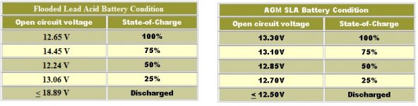

I'd would have the 20.1 v PS attached to the batteries all the time - whether the amps are in use or not. It will not hurt the batteries. They will remain charged with the PS supplying the amps' operating current and the batteries providing any extra amps for music peaks - much a like a capacitor. Here's my reasoning ...
SLA-AGM batteries have calcium added to the chemistry. This increases their operating voltage by 5%. See the attached "State-of-Charge" chart.
So at full charge, a 12v battery is at 13.3 v and the 6v battery is at 6.65v for a total of 19.95v. The PS at 20.1v is only .15V higher. This is negliagble and won't hurt the battery. 12V float charges have tolerances greater than this w/o battery damage. I just measured my SLA charger on float and it showed 13.8v. The flooded lead-acid battery in your, car when fully charged, is at 12.65 and the alternator consistently puts out 14.4v w/o ill effects.
Try it. If your skeptical, you can always test for a day and check to see if the batteries get warm.
If you routinely run on batteries alone and use the PS to charge, then limiting the charge current with a resistor would be warranted as others have stated. I'd use the 25% SOC value for the discharged batteries (19.59v) against the 20.1v PS for a voltage differential of 0.5v and limit the current to 2 amps for 12ah batteries (1/6th charge current is my rule-of-thumb). A 1 ohm resistor would give 0.5 amps but could take more than a day to charge. You can have a resistor in-line with a bypass switch - open for charging, closed for continuous operation/hibernation.
