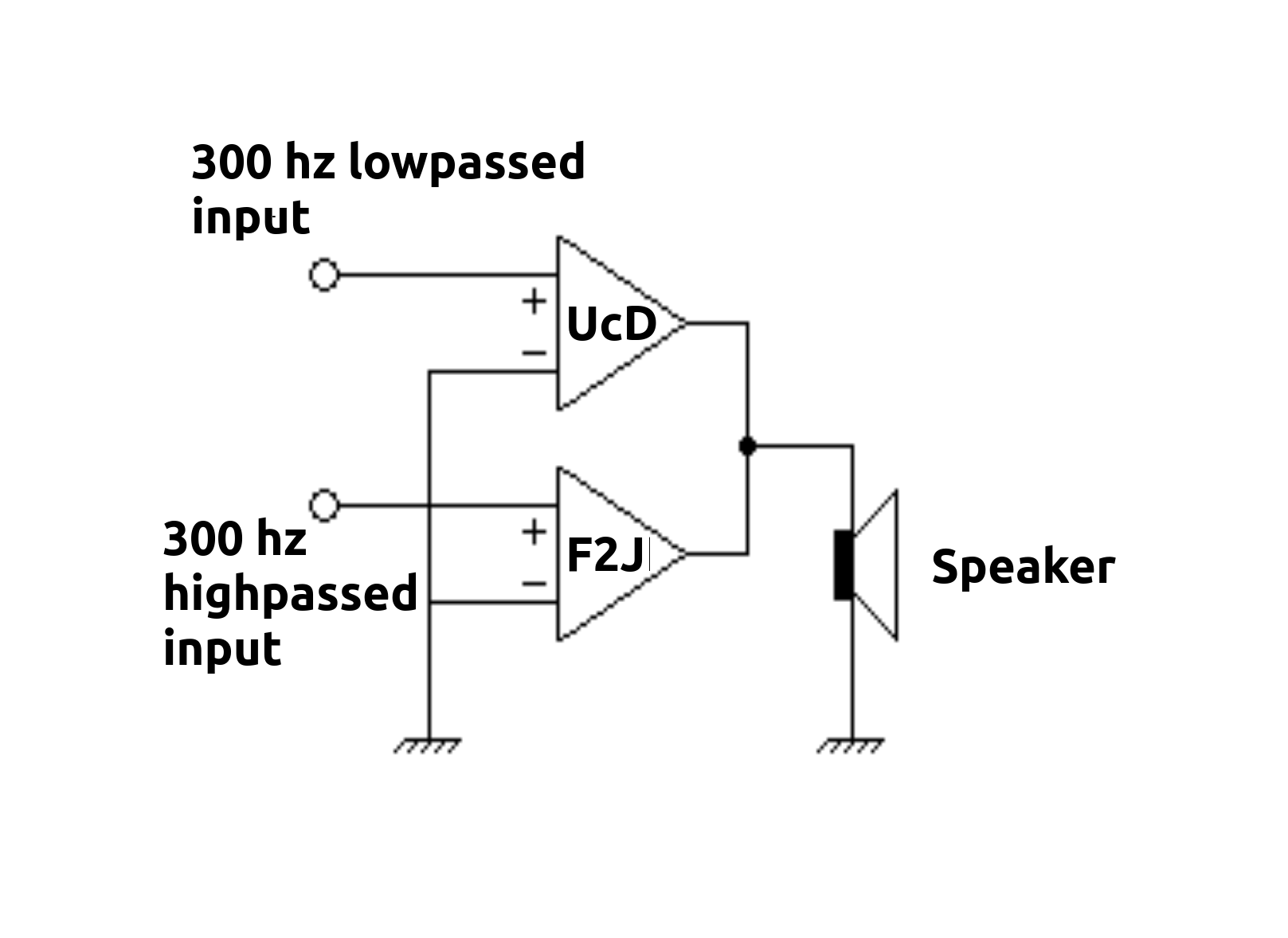

The idea would be to do this:
Each amp is driven form it's own DAC with its own DSP. If each amp had its own speaker it would work no problem, but the question is if we could let both amps drive the same speaker while keeping the output impedance characteristics of the amps. So in essence the speaker is voltage driven below 300 hz and current driven above. So ideally the output impedance that the speaker sees should be = [Speaker impedance] at 300 hz, increase 4x per octave above 300 hz and be reduced to 1/4 per octave below 300 hz.
Or will it just be driven as a handicapped combination of both voltage and current source over the operating range?
Hi.
443281d1413153435t-parallelling-voltage-current-source-amp-active-crossove-parallel_amp.png
The top amplifier will simply sink all the output
of the bottom amplifer, i.e. it won't work.
It would work in some fashion with a series output
inductor on the top amp, series ouput capacitor bottom.
rgds, sreten.

That won't work either, even with the same signal the UCD
supplies all the power to the load, all your cancelling is the
current in the F2J, and If you increase UCD voltage over
F2J, UCD simply starts driving the F2J as well. Highpassing
the F2J simply means the UCD will drive it a low frequencies.
Your not getting anywhere fast, or achieving the desired
result, low impedance at low frequencies, high at high.
Variable Amplifier Impedance
Stick a cap or so in there and you should be able to do it, an
amplifier than varies from low impedance at low frequencies
to high impedance at high frequencies smoothly transferring
the current delivery from the top amp to the bottom amp.
rgds, sreten.
Makes sense.
I did try to add inductors parallel to the F2J-ish amp but to get as close to a voltage source as I would need I would waste too much power. I think I know the "best" solution though if I wanted to do it:
Cut back on the source resistors to increase gain, add voltage feedback below 300 hz and add current feedback above.
It would make the amp significantly more complicated though =)
