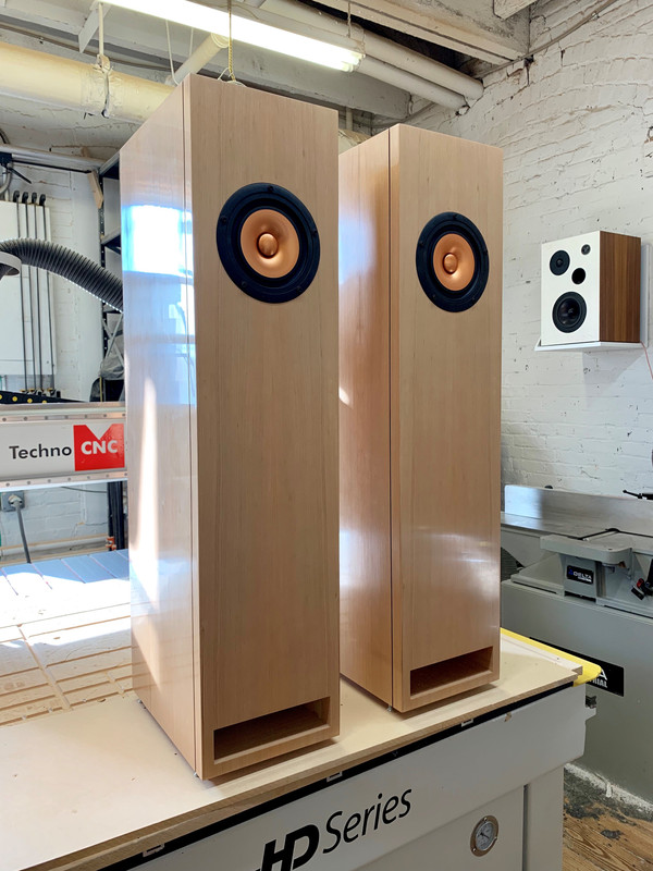

I've been playing my baritone semi acoustic/electric guitar with piezo pickups, through some transmission line cabinets, with Markaudio Alpair 11 ms drivers.
They are powered by a 30 watts AUDIOROMY FU29 tube amp. Very even and clear sounding, but in this baritone guitar situation, have just a bit too much low end for my taste. (They are my main music/tv speakers, and are perfectly fine for that, for now ...)

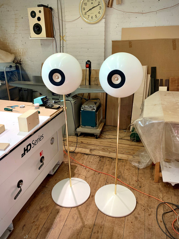

As I refused to tame the bass with EQ or other outboard gear/pedals/effects/preamps etc., and looking for a more concise/tamed low end, I decided to build smaller enclosures, for the Markaudio CHP-70 drivers.
Spherical they had to be 🙂
And on rods/stands, to bring them up to ear level, while sitting.
The clarity and evenness, is simply amazing. A much more manageable sound, more revealing, that requires less volume.
I also had no idea that baffle diffraction, or quasi lack therefore, would have such a dramatic effect. I'm very happy with the results.
BUT ...as these cabinets fall off sharply around 50-60 hz, I do of course now miss some low end ambiance.
Going back to the alpairs is not an option, as the "width" and "air" in those spheres is just too sweet.

Very nice spherical cabinets! Do you have a thread showing details of the construction. The spheres are indeed the least diffractive and give great imaging. Congrats on a beautiful speaker!
Thank you. No thread, I'm sorry. It's basically stacked layers of MDF, routed on a CNC, and finished with nitrocellulose lacquer.
They are certainly elegant and beautifully crafted. I might find it unnerving to have them staring at me, slightly cross-eyed though 🙂
