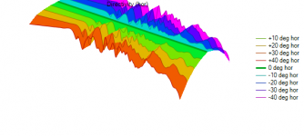

I took the tunrntable and measurement gear to bedroom and tuned dsp settings a little. MT xo changed to 2500hz LR2 with some eq tuning. o-90 deg polars were taken at 80cm distance and I used here 10ms gating , so response below 1kHz has artefacts. Mic height was between M and T. No room response measurements this time.
I use LR2 xo, which gives less than smooth horizontal response 2-4kHz. 4,5kHz has baffle edge interferences form the narrow sub-baffle. 26mm textile dome has high directivity above 12kHz. I have no interest to try to make response better, because speakers positioning in the room gives much more problems that cannot be fixed.
Measurements with REW shown with smoothing 1/24, traced with 1/6 to VCAD2.
as1 v3c 0-90 10ms 124.jpg Avalanche AS1dsp v3c 10ms Hann 16 line norm (hor).png
Avalanche AS1dsp v3c 10ms Hann 16 pol norm (hor).png Avalanche AS1dsp v3c 10ms Hann 16 wf norm (hor).png Avalanche AS1dsp v3c 10ms Hann 16 surf norm (hor).png
It is snowing again and I have a day off from work. I was thinking about testing some masking to smooth the midrange, but instead decided to jus make some eq changes and shift MT xo to 3kHz LR2 acoustic.
These speakers are used only for farfield listening, in not so optimal locations. So, ultimate smoothness of response is not needed. The added panel I made for new drivers is making some unavoidable edge interferences that destroy smooth DI. Stone baffle width is 26cm, added baffle is 14cm.
Avalanche AS1dsp v3d 10ms Hann 16 line norm (hor).pngAvalanche AS1dsp v3d 10ms Hann 16 pol norm (hor).pngAvalanche AS1dsp v3d 10ms Hann 16 surf norm (hor).png
