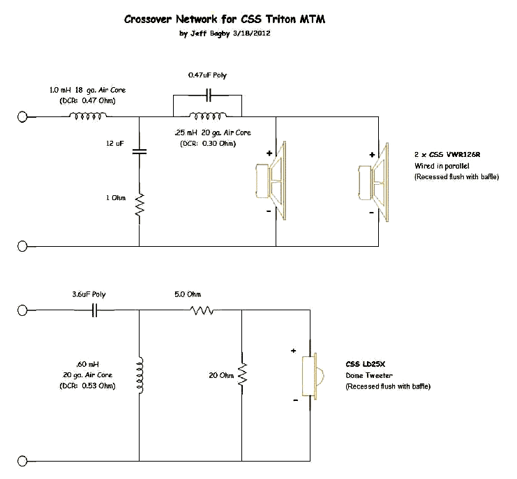

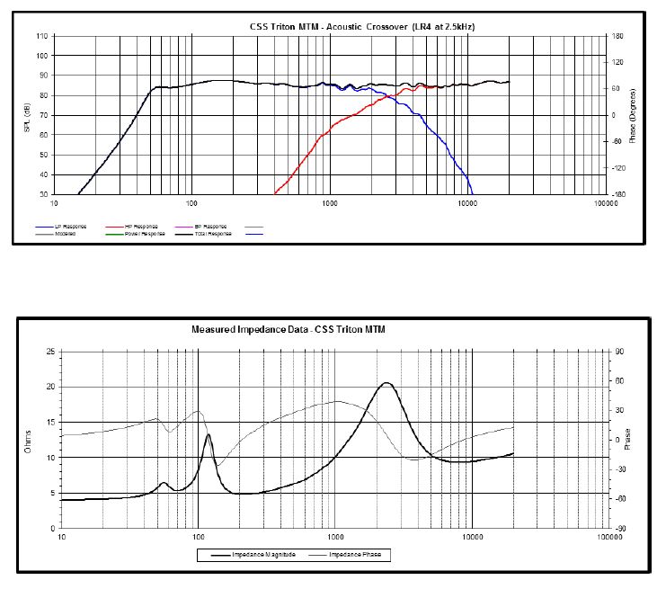

1.7kHz in the CSS Criton seems an awfully low crossover for a little 22mm tweeter... 😕
Jeff Bagby went much higher in the CSS Triton kit with a 25mm, albeit with smaller bass units:
http://www.diyaudio.com/forums/multi-way/220592-css-next-generation-high-resolution-triton-kit-designed-jeff-bagby.html
