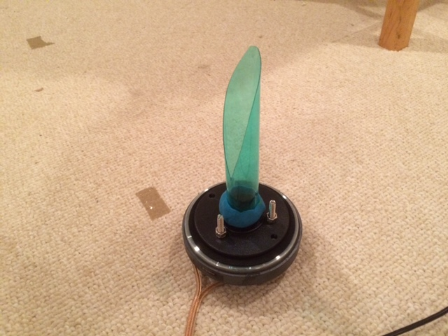

So I decided to test this K-tube concept out - it is simple enough: I took a 1in dia plastic tube from an old toy, took scissors and cut the slotted aperture, or should I say Kut the K-aperture? 🙂 Anyhow, the tube was about 5.5in long with a 5in long aperture. Then secured the tube using modeling clay to a 1 in dia throat PRV D280Ti compression driver. I made the measurement 0.5m away at 30 deg angle from axis of tube but aligned with K-slot. The resulting measurement surprised me with how flat it was and listening to it XO at 2.5kHz with an 8in Beta 8CX (no CD) in an XKi was downright pleasant. The most impressive thing was how wide and uniform the polar dispersion was. I did not have time for a polar measurement but walking around the room, could hear that it was very uniform over +/-70 deg or 140 deg wide. There is a fall-off int he HF's but I later found out it's because I did not have the K-tube oriented properly. I had it pointing straight up as shown in the photo with mic, the tube should be aimed up about 30 deg from horizontal with aperture facing down and mic level. Freddi. do you have some data that shows how flat it is and how high up it can go?
Photo of the setup:

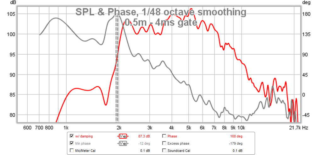

Here is frequency response and phase:

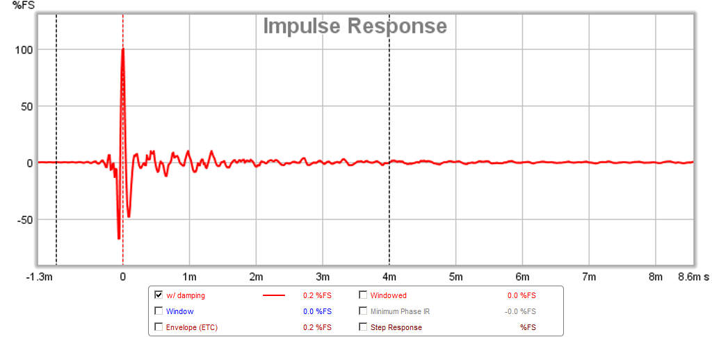

Here is the impulse response:
Summary: a very smooth sounding "horn" that is dirt cheap and brain dead easy to make. I have heard that even a cardboard tube can work. My next step will be to print one on a 3d printer with a CD bolt flange. Highly recommended that you give it a try - it looks funny but it really works. I am in the process of making a 90x40 deg SEOS waveguide and will compare the two at some point.
Photo of the setup:
Here is the harmonic distortion:
