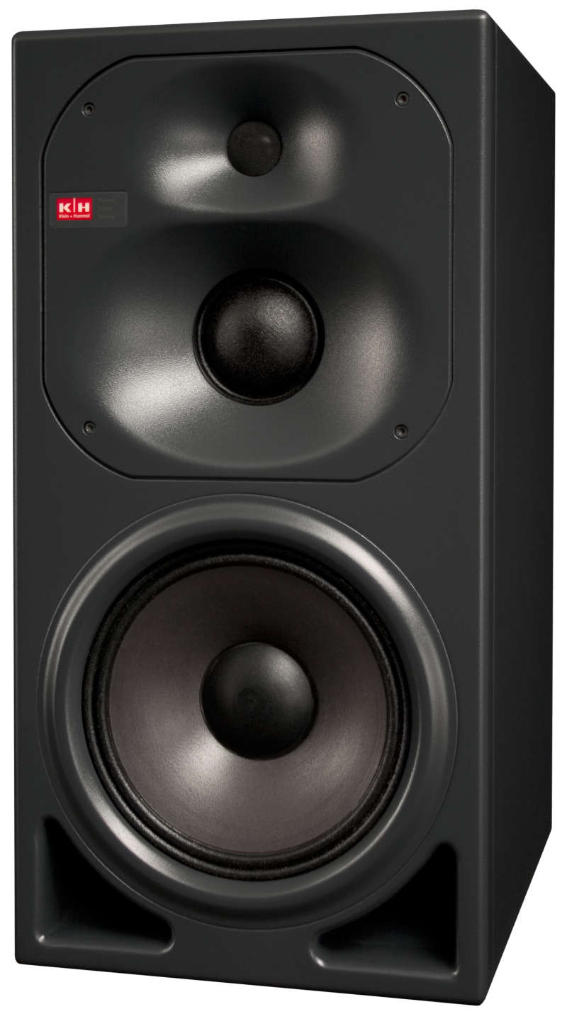

I don't think it will load the driver, there's no horn throath. The idea would be a bit like these:
I think we understand what you're looking for, but you still cannot get horn loading down to 400hz without a large enough horn to "contain" 400hz The bottom threshold wherein you will get horn loading is more or less equal to the dimension of the mouth compared with the size of the wavelength (in a conical).

Getting there bit by bit 🙂 The radius of the horn is limited by the asymetrical placement of the Sica on the baffle.
Ok, 160mm wide x 36mm deep. Baffle width is 450mm. Can this be a rectangular horn or do you have to have a round horn? Why only 36mm deep - that is not much depth to work with. I suggest at least 150mm deep, is that possible? If baffle is 450mm wide why not make horn go all the way to say 400mm wide x 160mm tall x 200mm deep for 90deg pattern?
