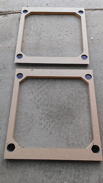

I got started and cut the first sheet that has all pieces for 2 modules.
I cleaned up the pieces and got them all ready for assembly. The first step was putting in magnets for a grill in back. I have been using a bunch of 1"x5/8" neo magnets for awhile for holding grills. Magnets can go on one side and a steel blank on the other, or magnets on both sides for extra holding power. I buried the magnets in the back panel of the baffle and filled with epoxy around them.
Once that dried it was time to put the box together. It was assembled with a black epoxy we use for many things. It holds well, is very thick so it stays in cracks, but takes awhile to dry. I still find it is the best adhesive we have used for cabinets in all the years I have been building. I have determined I am going to build a couple jigs before I assemble more modules but the first one went together quite well.

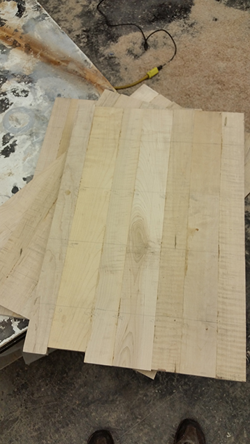

I got a little time in today, but not much. Just enough to dig out the rest of the curly maple off of the wood rack. I then cut the pieces to 25" long. The top will be 23" finished width so I needed a little more length to screw down to the CNC table when cutting the shape out. I ripped them down to somewhat random widths. I did make the pieces symmetrical but this was more about not wasting too much material than it was about having perfect symmetry to the pieces. They range in width from about 2.25" to 3.5". I laid them out for 4 total pieces, two tops and two bottoms. The curly maple really is quite nice looking. The nice thing is with the modular design I can easily end up with 4 tops instead of using these as 2 bottoms. Later on I will probably do that and make the bottom plates out of plain maple when I get more in.

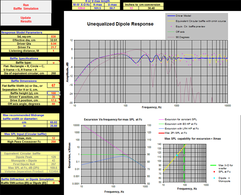

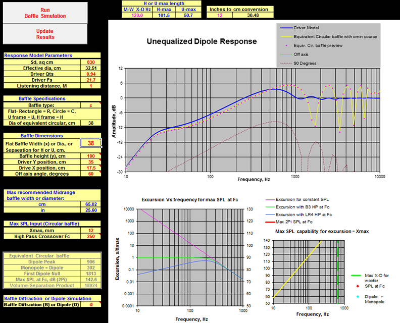

I'd wager John has pretty much heard them all.There's a reason why minimal baffles have such a large following.
John, what are your intended xo points?
As mentioned, there are benefits to the minimal or naked baffle mostly in the dipole radiation pattern. The problem is that you simply cannot get enough output from it. While I do want to verify with actual measurements, the models show a huge difference in output between the U baffle and naked circular baffle. This should be the case due to the large separation difference between them. If I was to take a 15" woofer on a tiny baffle vs the U frame that is being made, there is an 18dB difference in modeled maximum output at 20hz. A single Dipole15 with the naked baffle can only achieve about 75dB at 20hz. This just isn't very useful.
The U baffle on the other hand shows I can achieve about 95dB at 20hz with this design. Again, this needs to be verified as these estimates seem extremely generous. If 95dB can be achieved from one woofer, this may be enough for many people. Again this is where the modular design comes in and multiples can be stacked based on the needs. To get the same output with naked baffles would take 6x as many drivers. Again that isn't very practical.
Having the most ideal dipole radiation pattern but not being able to achieve required output levels really doesn't mean much. Reflections in the room really mess up this radiation pattern as well. If you are going to those efforts realize that there are many other factors beside just the baffle. Another of the large benefits is simply eliminating resonances and reflections in the enclosure coming back through the cone at a delay. Eliminating this is still a huge benefit. That is what most are achieving in their designs.
It is all about compromises.

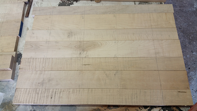

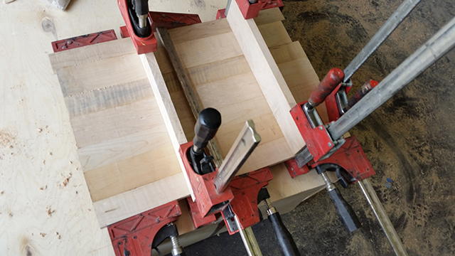

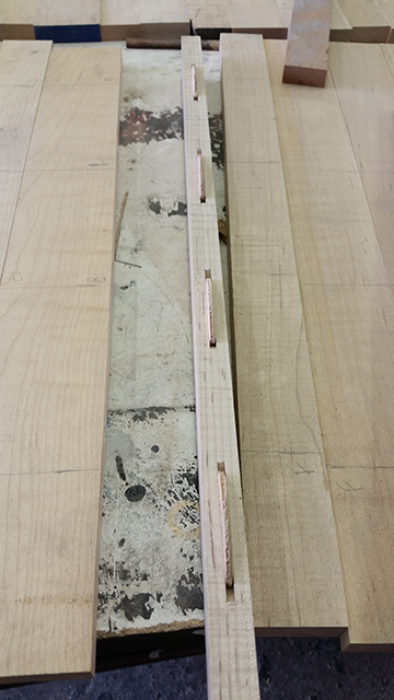

I haven't been able to get much done on this but finally got some time yesterday to do a little. The next step was to actually glue up the curly maple top and bottom caps. I took all the boards and laid them out with end grain properly altered. I then drew lines to use as guides for the #20 biscuits used to help align them. I ran each board through the jointer taking off the smallest amount possible to remove any saw cuts assuring a proper seam when glued.
Then I took out the porter cable biscuit jointer and made all the slots for the biscuits.
Then using some Titebond III I glued them all up. Boards were clamped top and bottom to keep the assembled panel from bowing with pressure from the clamps.
The end result was 4 nicely glued panels.

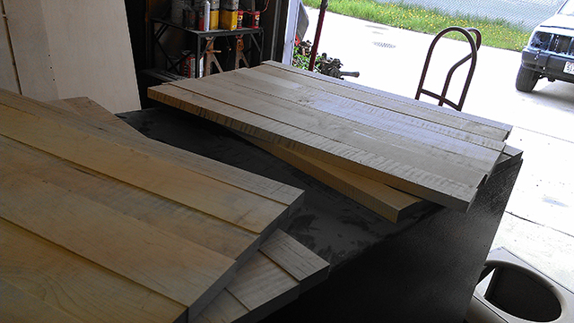

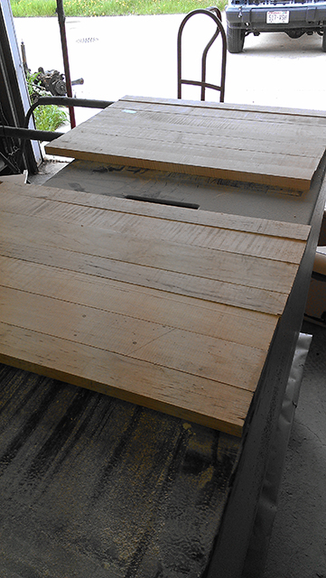

Because these are curly maple I can't really plane to thickness. Luckily, there is a local shop that has a very nice 50" wide triple belt sander and a 50" wide rotary sander as well. For about $20 they will send the panels through the belt sander multiple passes until they are smooth, then send through the rotary sander to remove the sanding lines. Then it is back to the shop for these panels to go on the CNC router where they will be taken down to the final shape to match the curves of the enclosure.

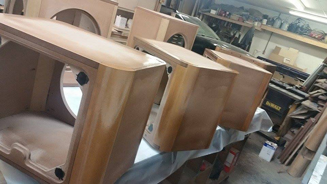

After assembling the cabinets, the first thing done was to prep them for veneer. While the veneer will cover very tiny flaws, a great amount of care needs to be done in prepping the MDF. Seams tend to telegraph through if the cabinet is not sealed properly. I ended up spraying them with a catalyzed polyurethane sanding sealer that was diluted with MEK. This allows the sanding sealer to penetrate into the MDF much further, rather than sitting on the surface. It is sprayed on heavily with the intent of soaking the MDF. As a result, it will run. This is not a problem as the sanding sealer sands very easily and final body work is done after this step anyway.

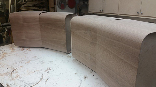

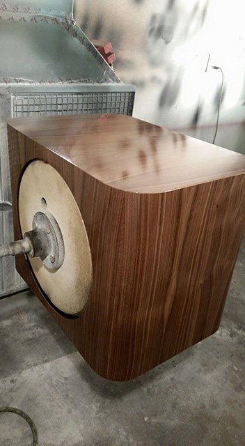

While these are fully curing, the veneer is cut to size to perform the wrap of the cabinets. It is laid out upside down to help flatten prior to applying it to the cabinets.

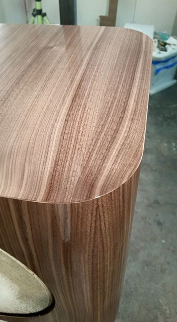

Next, the final body work is done over the top of the sealer and the whole cabinet is blocked out by hand. We use Rage Gold body filler and Icing finishing filler. They are more expensive than some other fillers but they lay down smoothly and sand very easily. Here the cabinets are all sanded, filled, and ready for adhesive.

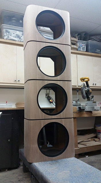

I then did a wrap with the NBL backed walnut veneer. As these cabinets will be stacked, I sequenced the veneer to give a continual grain over the front of the cabinets. You can see the grain pattern more continually before the cutouts were made.

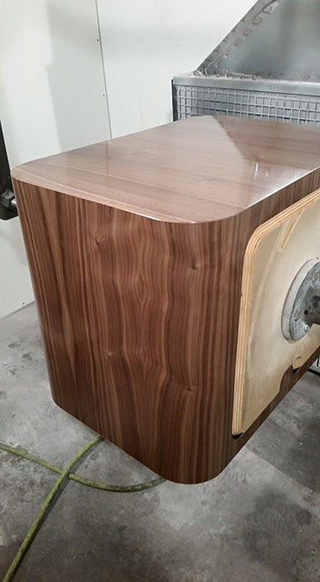

From there, the veneer was trimmed for the driver holes and the open back of each cabinet. Magnetic grills will cover the openings in back to give them a finished look.
The cabinets where then taken to the spray area and hung on the rack. This allows for all sides of the cabinet to be sprayed simply by rolling the cabinet on the bearings. Two coats of sanding sealer were applied. The cabinets were again blocked out by hand. Two final coats of a 45 degree sheen top coat were then applied to finish the cabinets. The result is a finish between satin and semi gloss with very deep grain.

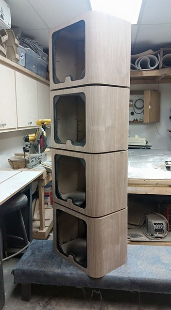

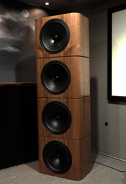

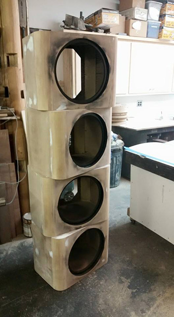

I had a little time so I was able to stack the baffles showing the possibility for 4x UB151 to be done in a single stack with sequenced veneer. The design and large radius corners ended up looking very nice.
To get somewhat of an idea of their performance as the bottom end with a horn based system I took the cabinets and stacked 2 per side under the Radian 745BePB on the SEOS24 waveguides. Unfortunately I did not get to spend significant time optimizing this system, but the initial results were very promising.
I will be getting some good measurments of the UB151 soon in a very large room, or outdoors. While they produced tremendous bass in the small demo room, it as not at all ideal for taking these measurements.
