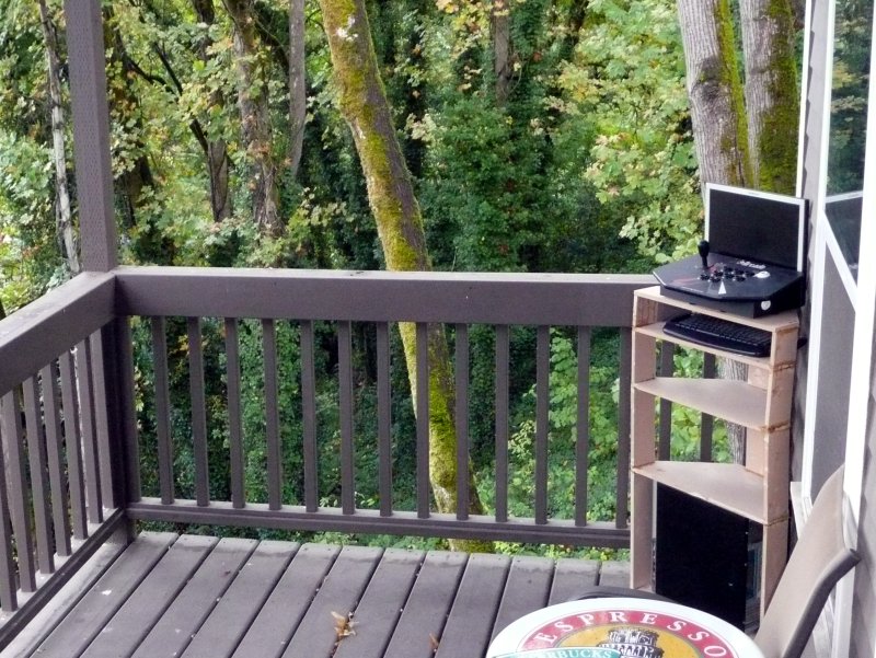

One of my motivations to do this project is that I wanted to have some toys outside. I've seen some people install dining rooms, cabanas, and even home theaters outside.
One problem with the plan is that I don't want to ruin the view from my living room. So I modified the foot print of the cabinet so that it uses as little space as possible.
Hopefully it will look something like this when I'm finished.
The shelf heights are from the Fibonacci sequence, and the bottom shelf is just big enough to contain the PC.
I can't make the cabinet any smaller because I have to use a full size case. The video card I am using won't fit in a small case. (Small video cards don't have enough horsepower for games.)
Here's the Unity horn in comparison to the cabinet. Yes, it's huge.
The mouth of the horn is 21" across. It has a coverage angle of ninety degrees, the same as my Summas
Because the Unity horn is conical, it has a small foot print. It will likely me mounted from the ceiling of the deck.
From the living room, the video game cabinet and Unity horn is completely invisible.​

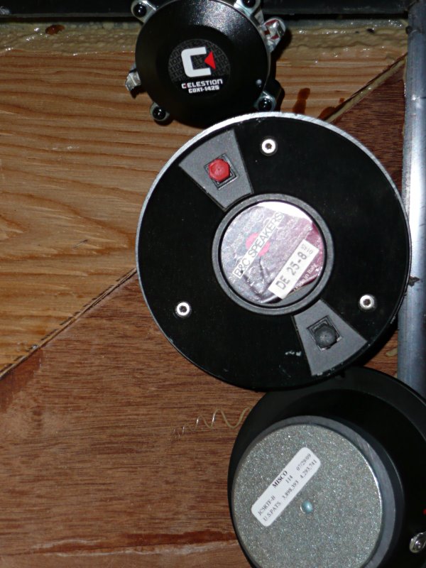

Here's the Durango '95, along with two mids and a couple of compression drivers. If I'm not mistaken, these are the same midranges and compression driver used in the SPL-TD1 and the Lambda Unity. I intend to use a Celestion compression driver instead of the B&C used in "the real deal", as the Celestion plays higher (at the expense of power handling.)
