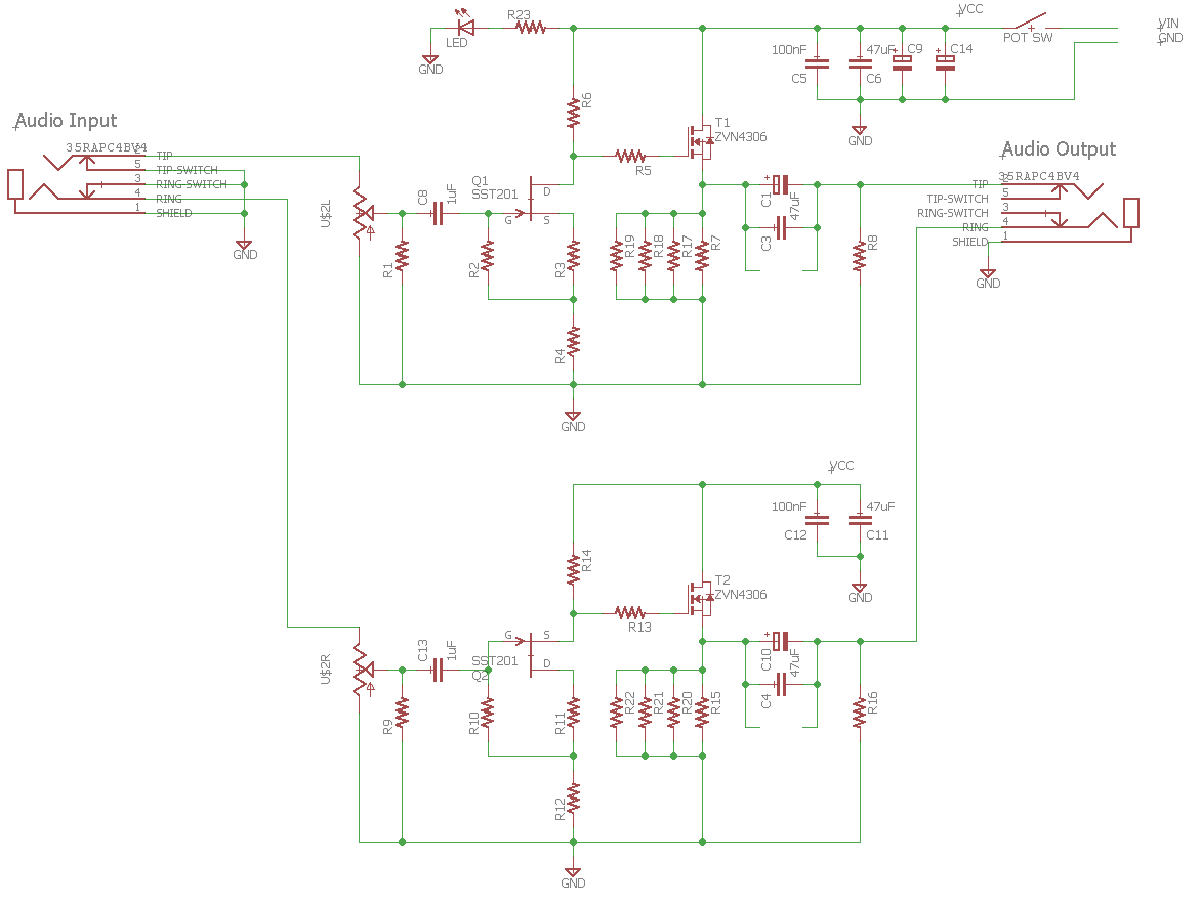

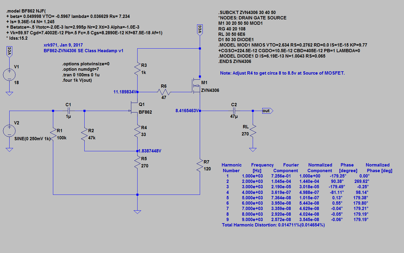

This is the basic circuit - very simple and it's what gives it a natural and very musical sound that is engaging, lively, never sterile.
591187d1483977924-bf862-based-se-class-headamp-without-heat-pocket-class-bf862-zvn5306-ha-v1.png

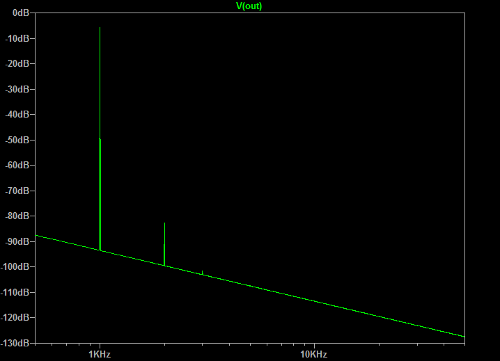

Here is the predicted HD profile:
591189d1483977924-bf862-based-se-class-headamp-without-heat-pocket-class-bf862-zvn5306-ha-v1-fft-1khz.png

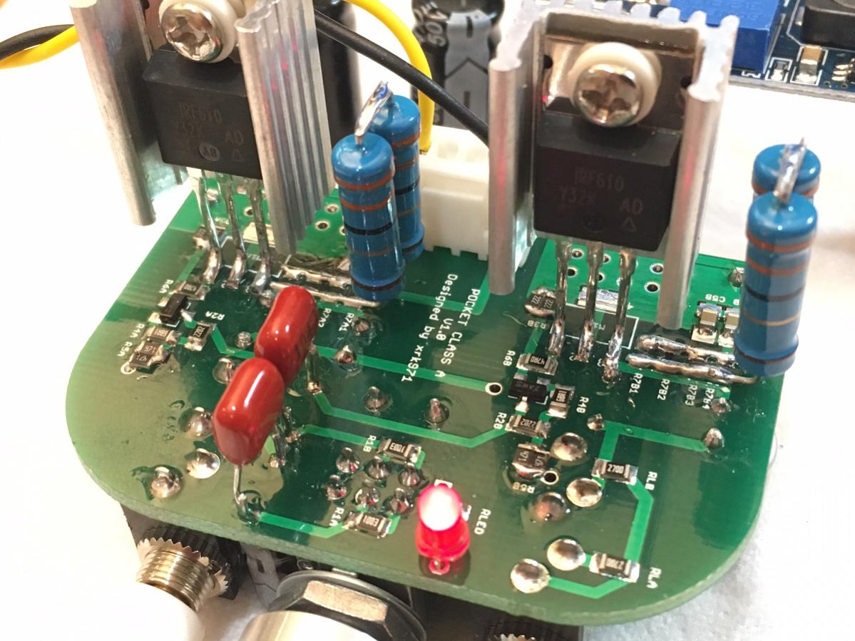

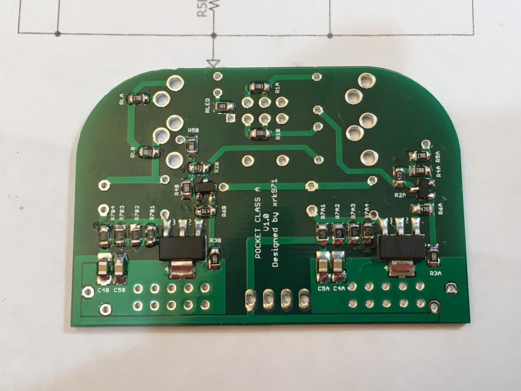

Here is what the hand made prototype looks like:
591358d1484063759-bf862-based-se-class-headamp-without-heat-pocket-class-bf862-zvn5306-ha-v1-new-oscons.jpg

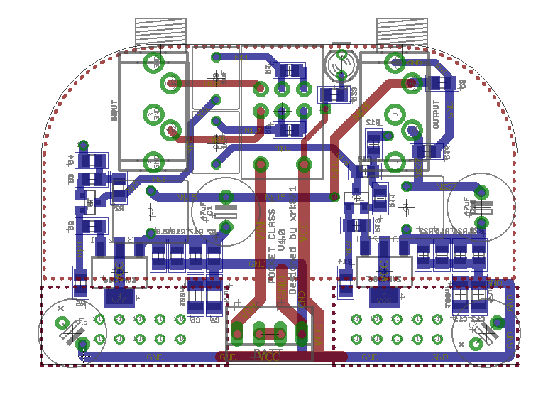

This is the layout for the actual board being sold for this GB:
594826d1485450543-bf862-based-se-class-headamp-without-heat-pocket-class-gb-layout.png
This is the associated schematic that goes with this layout:

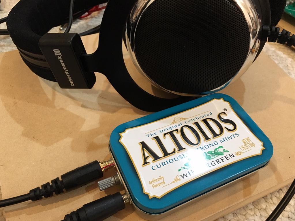

Many thanks to BabyDontHertzMe (BDHM) for making the layout and to Agdr for providing the initial Altoids footprint Eagle file.

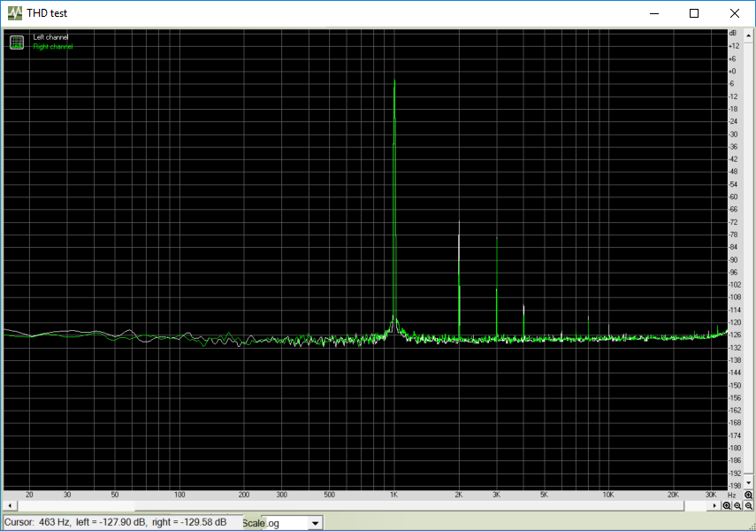

Here is the measured HD using Focusrite Solo 2nd gen at 96kHz and 24bit:
The HD measured using a UCA202 at 16bits and 48kHz looks like this:
Edit Feb. 18, 2017 - Here is the latest measured frequency response and THD from the GB PCB:
Edit Feb. 18, 2017 - Here is the latest measured FFT from the GB PCB measured for 1kHz excitation at 700mV into a 270ohm load:

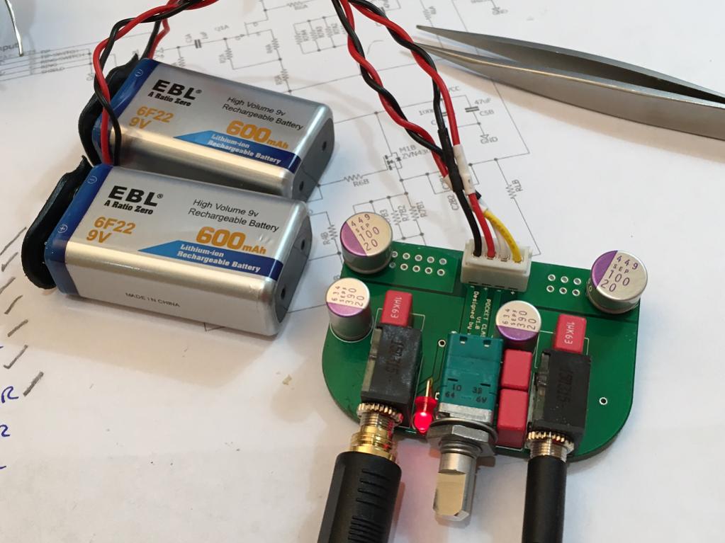

Edit - Jan 9, 2017: The GB PCB works! Sounds fantastic.

Please note, I found a typo in the BOM:
SMT resistors should have qnty 4 x 270R and qnty 8 x 470R. Also from previous errata the 100nF X7R caps should be 1206 - but I think if you have 0805, they could be fitted in the same pads.
Sorry I will post schematic soon. The 470R are the qnty 4 in parallel power resistors to give 118ohms or close to 120R. I do this to spread the heat load over a wider surface area to dissipate heat and four 0805 resistors are cheap compared to a larger SMT power resistor.
If you look at the layout you will see four in parallel from mosfet output to ground.
