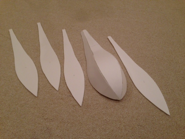

Such a BLH can be a fun way to play with smaller FR drivers, here, have a look at something I've done just over a year ago:
http://www.diyaudio.com/forums/full-range/222798-little-diy-back-load-horn-ff85wk.html
I mostly wanted to check how the build would come out compared to Hornresp simulations, which was not too bad IIRC. It could probably be bettered upon easily by a designer more experienced than me in this type of enclosure.
Good luck!

I could answer 'yes', but then again my expectations were not sky-high. The "horn" works in the sense that baffle-step is compensated for, but in a rough kind of way. I think if one is not going to go for a large enough mouth to really have some useful horn-loading going on, the implementation of modern TL techniques such as driver offset and mass-loading would likely give a superior result. Like I mentioned, my basic design is probably not as good as it could be anyway, within its own paradigm - I'm pretty sure something quite enjoyable could be made with this more old-school approach.
IG
