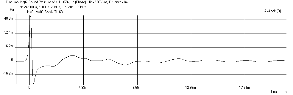

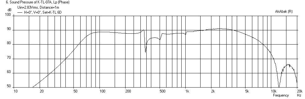

4FE32 in 0.4X scale Karlsonator
Here is what I think I single 4FE32 will sound like in a 0.4X scale Karlsonator. That is a 12 in tall x 6 in wide box - quite compact and very bookshelf or desktop size.
Freq Response:
Impulse Response:
Looks like it might be worth trying...
Freq Response:
Impulse Response:
I was checking out this driver and its ferrite counterpart as well. They look like finely-made drivers with very good specifications. The Karlsonator model data look very promising...

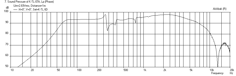

This even looks more fun as a dual driver 4FE32 in a 0.53X scale (same as the ones I built for the dual Vifa's). Great 94dB efficiency and smooth response.
