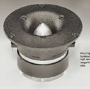

can I use a tweeter for better highs? I got B&C D32s laying around which goes up to 18-19Khz with 107db/w/m

I would go for a tweeter as the high range of any 8" driver beams a lot. Look on the danish page on how he Equed and crossed over to get inspiration.
