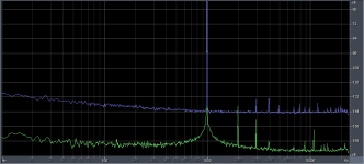

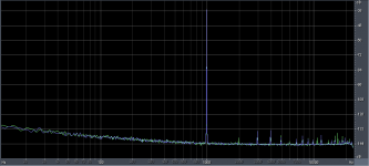

A good question. I'd say that for subjective excellence its necessary to pay attention to noise, and noise floor modulation in particular. For objective excellence the attention turns to distortion (THD+N). Subjectively, low-level performance (-30dBfs and below) needs to be optimized because music signals aren't pure sinewaves - rather superpositions of hundreds of small sinewaves. Objectively, the attention goes to performance at full output with a single tone as stimulus.
If you look at how the noise varies for your suggested ES9018 DAC, you can measure something like this. A test tone of around 1kHz is applied, the two colours differ by just 1dB in level but check out the huge shift in the noisefloor. The levels of the two tones are -36dBfs and -35dBfs.

Picture is too fuzzy to make out scales. What can been seen in white trace is terrible IMD. Could be test setup, could be software, could be poor electronics. Likely aliasing problem combined with power supply issues.
Here's an example of well behaved test set up, with well behaved soundcard. A full scale 1kHz sine is generated and used as test signal. Signal is digitally attenuated to -35dB for 1st recording, and -36dB for second recording:
For comparison, 0dBFS signal is recorded, and plotted with -36dB offset with overlay of result obtained recording at -36dB:
From above it is clear that DAC, and ADC for capture have excellent linearity.

Here's a bigger plot where I can make out the scales
