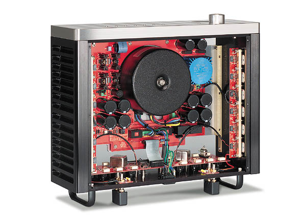

Just for reference, how much does that cost? I mean with about $60 worth of LM chips, I guess $250
