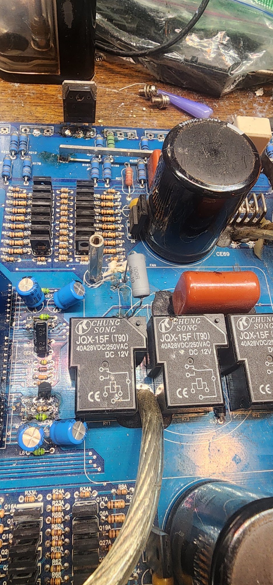

How is that resistor being used? Directly across the output? In series with the cap and both across the output?

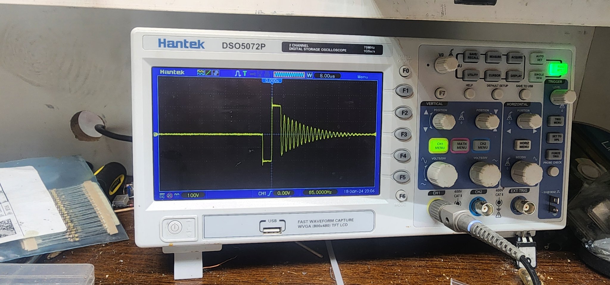

What signal do you see on the terminals of the resistor?

It is connected to the speaker negative and final output inductor.
Using the common ground as a reference I get neg rail on the inductor side and 0v on the speaker neg side.
Yes it's connected to the capacitors

Do you know for a fact that the resistor should be a 100 ohm? If it's connected as you stated, I'd expect it to be more in the range of 2.2k to 2.7k.
If you have negative rail on the inductor, the driver board isn't working as it should.
Do you see pulses from any of the outputs of the driver board?
