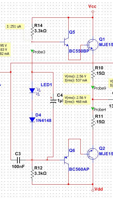

2V4 zeners have a very soft "knee", leaking a lot below the nominal voltage and poor regulation above the knee. A forward biased green LED can give a sharper reference
