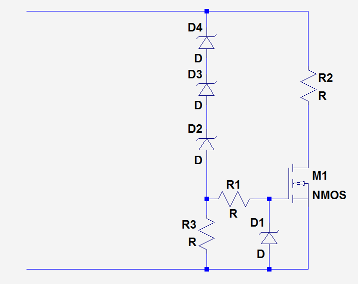

I do not like very much the idea of dissipating power in silicon, but transistors can be combined with power resistors and zeners to get the best of the three worlds.
Here is what I mean: R1 and D1 just serve as a protection for the MOS (a MOS is practically unavoidable thanks to its ~square SOA)
D2 to 4 is your zener string, minus the Vth of the MOS (in principle negligible), R3 defines the current in the string, and R2 is the equivalent of your load, just a bit lower (in ohmic terms) to remain on the safe side. It will have to carry the brunt of the dissipation.
The MOS has to be rated for the maximum power to be dissipated in the load (in theory a quarter of that, but let's remain on the safe side), and it has to be bolted to a slab of metal (not actually an heatsink) having a sufficient thermal capacity for the whole duration of the "event".

I've used both techniques (string of zeners, and power FET style zener) for choke input supplies - as the difference between start-up and idle voltage rail is much more than just a cap input supply. The concern with a string of zeners especially is that some may not appreciate the substantial derating needed for the zener device dissipation when simply soldered end-on-end. A "3 Watt" zener will only survive close to 3W (and that is for max junction tmp operation which should never really be approached in practise) if in 25C ambient with the requisite lead heatsinking. In practise, the leads provide effectively no heatsinking when soldered end-on-end. Similar to when a power FET device is used with no heatsinking as Elvee alerts, although this is managed in the shown example circuit by aiming to dissipate most of the load power in R2 (most people appreciate resistor power loss issues a bit better).

with a 5k Ohm resistor and no load (no tubes) the power supply runs at 474 vdc, but as I quickly found out my calculation for power draw was way way off. It was drawing 90ma not 9ma 😱 so the power dissipation is 40 watts not 4 as I erroneously calculated. This error was brought to my attention via a smoking 10w resistor. Without the 5K resistor and with all tubes up and running hot plate voltage was 434v with the 5U4GB running cathode bias at about 20w per tube.
With a GZ34 the plate voltage bit on the high side (470v), but not so out of whack that I wouldn't think of using it. With the 5U4GB it was at a nice 434v on the plates but warm up is the problem.
I think the safe solution is to scrap the zener idea and replace a couple of the hv caps with the proper 500v models and even with the 525v cold start voltage it's well within the surge range of 550v, and if I do want to use a GZ34 these caps also will be fine.
Sometimes it seems the simple solution is to just do the right thing 🙂
