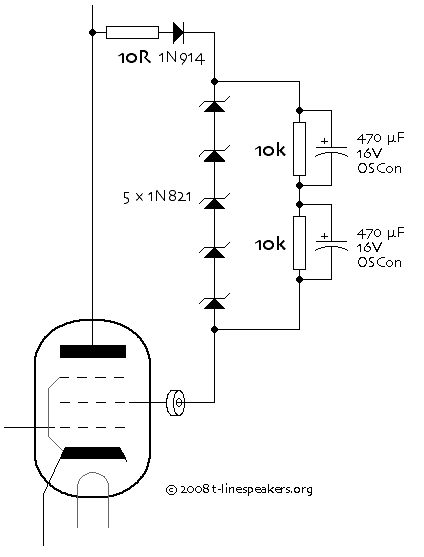

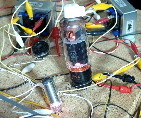

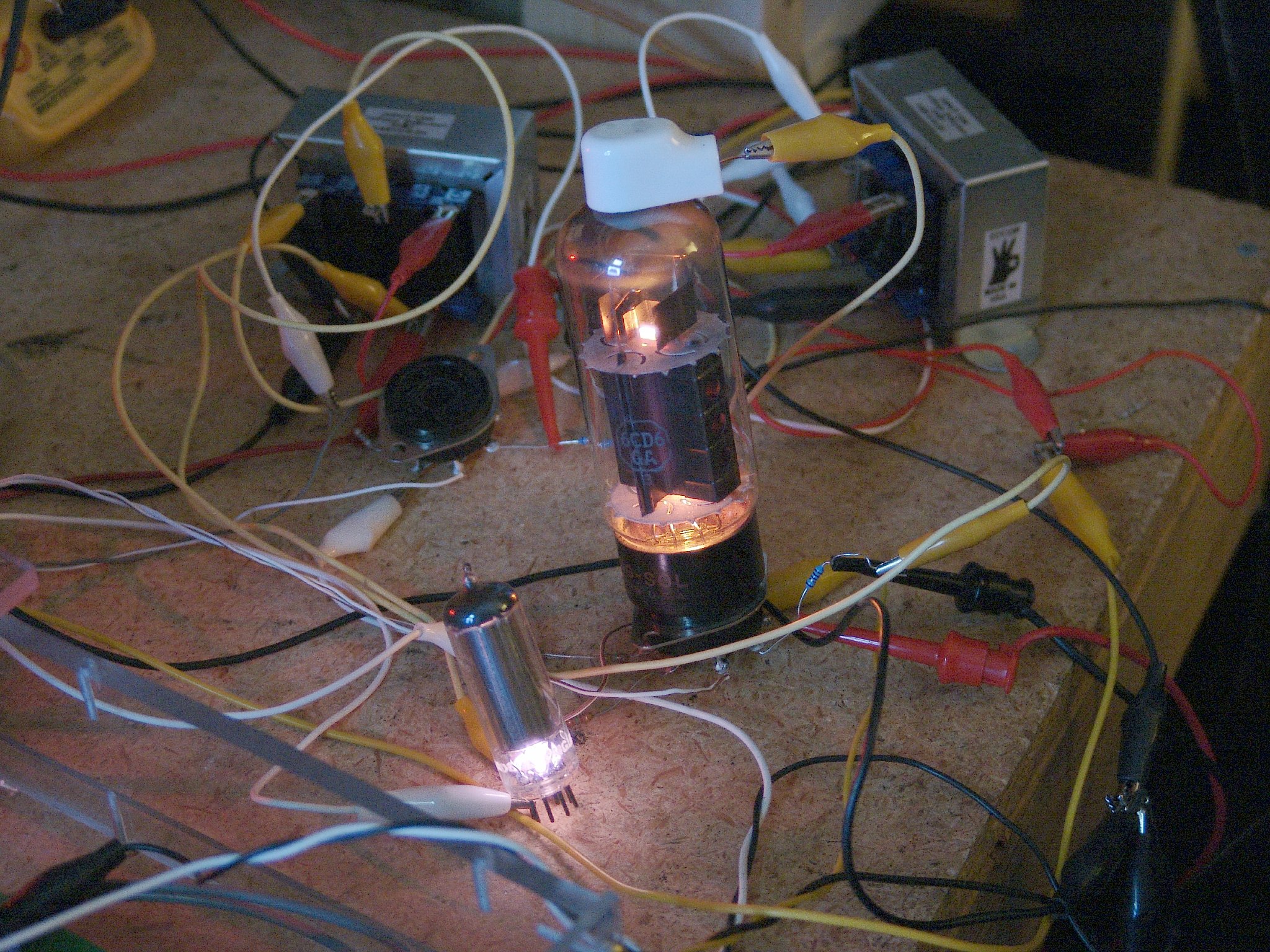

I have used a zener, or a VR tube in series with the UL tap. I have also used a mosfet buffer fed by a resistive divider to provide for a variable UL tap to feed the screen. All experiments used a 6CD6GA tube because I had lots of them at the time and they did NOT like running in UL from the OPT tap. Works OK at full power output, but the tube fries at idle eventually leading to melted screen grid or red plate runaway due to gas and mobile ions from the glowing screen grid.
I came to the conclusion that pentode mode with cathode feedback with a fixed screen grid voltage gave similar power and distortion numbers, but didn't blow up. All experiments were done about 20 years ago so the details were lost. Resistor to ground to keep VR tube lit is needed due to difference in strike and run voltages.

Thanks George, what’s the reason of this behaviour? Here I plan to lower screens around 50V.

This leaves little margin for driving the screen grid, and rules out conventional UL designs. As previously stated simply adding a fixed offset with Zeners or VR tubes can impose too much voltage swing creating nonlinearity or even cutoff conditions in a class A SE amp. If I cranked the 6CD6 - VR tube thing in post 11 the VR tube would blink off and on resulting in severe distortion.
