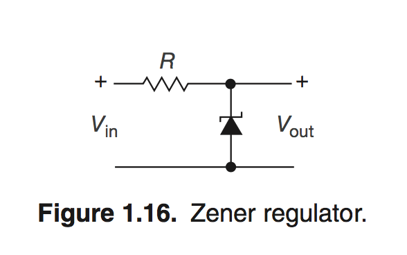

While measuring Rz of 1N5248B zener I am getting the value much greater than the specs.
The circuit is very simple (attached). Here are my measurements @ R = 600 Ohm:
Vin = 22, 23, 24, 25 V
Vout = 18.01, 18.16, 18.32, 18.47 V
Iz = 6.7, 8.1, 9.46, 10.85 mA
Calculations:
dVin = 3V
dVout = 0.46V

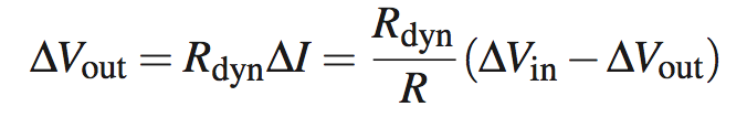

Rz = R x dVout / (dVin - dVout)
Rz = 600 x 0.46 / (3 - 0.46) = 276 / 2.54 = 108.6 Ohm
The specs says Rz is 21 Ohm at 7mA
Now, before you say the reason for the discrepancy is that my Iz is over 7mA, here is Rz value as measured for 22-23V change (where the current is very close to 7mA):
Rz = 600 x 0.15 / (1 - 0.15) = 90 / 0.85 = 105.9 Ohm
What am I doing wrong?

Seems to me you've done nothing wrong.

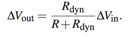

Rdynamic is the slope of the I-vs-V curve: Rdynamic = dV/dI
Plugging in your values, Rdynamic = (18.47 - 18.01) / (0.01085 - 0.0067) = 110.8 ohms
Nowhere near 21 ohms. Maybe you accidentally purchased counterfeit parts from a sketchy seller on a super low priced foreign website.

This might shed some light on the issue:
https://www.vishay.com/docs/84117/84117.pdf
I had understood that these measurements need to be performed on a dynamic basis to avoid heating the junction which results in some errors.
I did notice the current go down and voltage go up in my measurements and I always recorded the value after the diode thermally stabilizes. Here is a new set of measurements, this time I recorded the very first value I could see on my DMM after connecting the zener:
Vin = 20, 21, 22, 23V
Vout = 17.38, 17.44, 17.48, 17.56V
Iz = 4.42, 5.96 7.56, 9.09mA
Plugging in these numbers I get a value much closer to the specs:
Rz = 600 x 0.16 / (3 - 0.18) = 108 / 2.82 = 38.29 Ohm
I am still surprised that I cannot rely on the Rz in the specs for such a simple application as voltage regulator. The text book I am reading also mentions that "the dynamic resistance of a zener diode varies roughly in inverse proportion to current". Statement that makes little practical use given how much junction heat from higher current can influence Rz in the opposite direction.

I think you have got it backwards, you can trust the manufacturer specification and not the measurements you are doing, the problem you have is that you cannot verify the specification because you don't have the appropriate equipment nor experience to make this measurement. No reason to feel bad, I don't either and would undoubtedly get similar results to yours.
As I pointed out this is a dynamic measurement and needs to be done on the order of milliseconds in order to avoid heating the junction. Even in the second or so it took you to do the measurement I suspect an error of > 100% based on the way the parts are generally specified.
Fairchild was a very reputable semiconductor maker, and their successor OnSemi is as well. Mistakes happen but it's not that likely over this period of time on a commodity part that such an error would not have been corrected. Unlike the old days most semiconductor devices today are 100% tested during production. (By convention some parameters guaranteed by design are not tested)
I have worked for several ATE semiconductor test hardware companies and designed hardware to do these sorts of measurements, it is not as trivial as it seems.
I think a good measurement method would be to feed the zener with say 10mA DC with 1mA ac superimposed, through a series R.
Measuring the attenuation of the AC signal before and after the series R should give you Rdyn.
