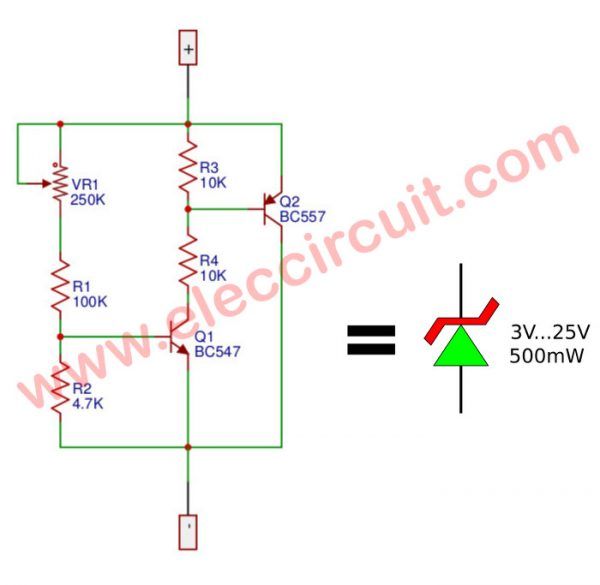

I have to replace 2 different zeners on an amp board and, replacements are hard to find. The originals were: WZ-280 and WZ-197
Found NTE5034A and NTE5029A but even those are hard to find!.
I always get stuff from Digikey Canada but, they have nothing like these in stock.
Any ideas???
Hello,
This setup can replace your zeners:
