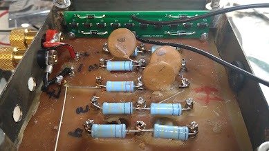

I have a question about rated power in a zerer-diode coupled in the protection unit in a esl57. I have seen several units with surface mount zeners but also seen its suitable with 5W rated zeners but only 1,25W available in surface mount like BZG03C220. Will it be ok? Or problem in a clipping situation with 10*1,25W= 12,5W terminated effect in treble unit?

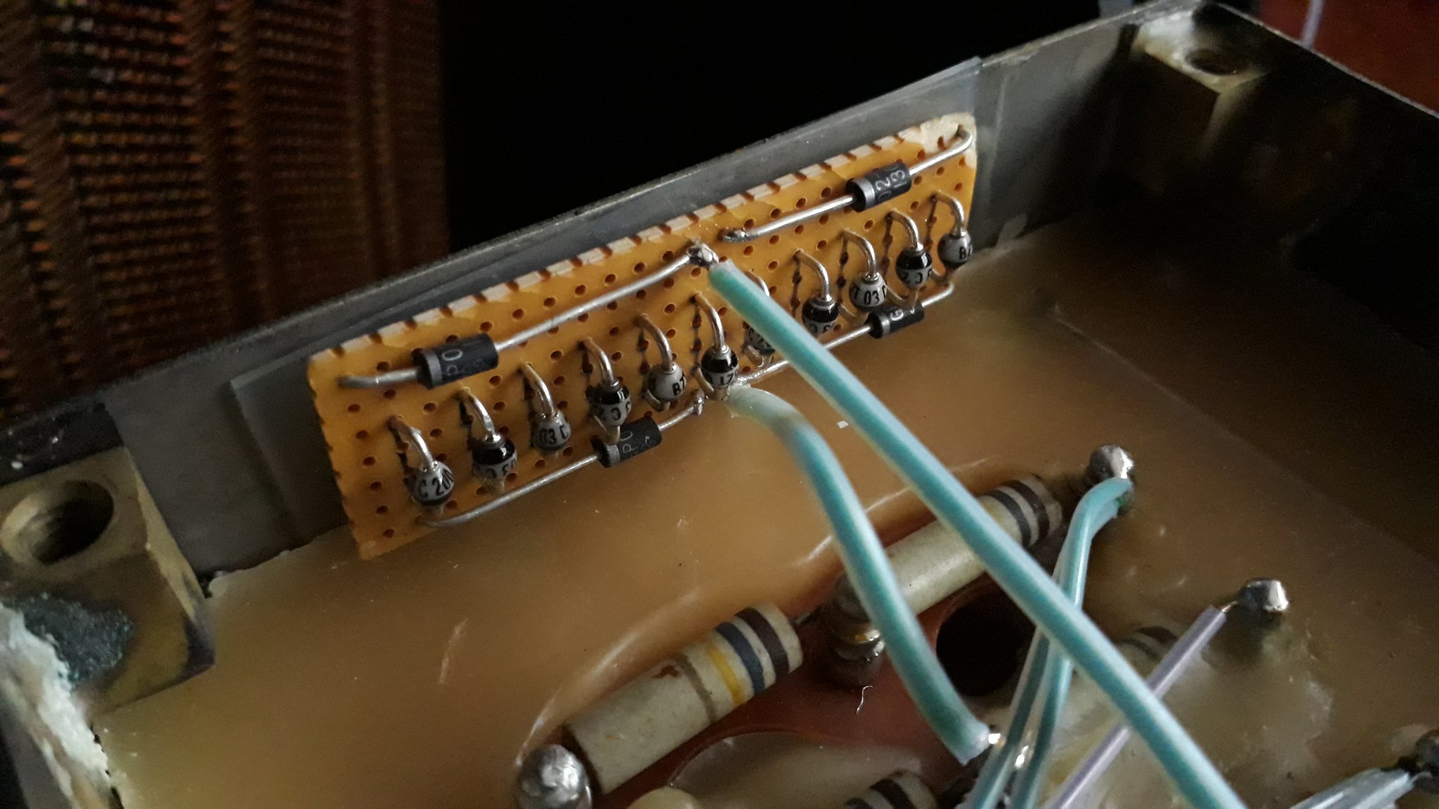

I created a similar protection with BZT03C200 zener diodes and GP02-40 high voltage diodes, but never pushed it to kick in.

Ok thanks, that is similar in power handling 1,3W (BZT03C200) and mine suggested is 1,25W (BZG03C220)so pretty similar. I did test it with 1KV 2,5KV and it certainly works (clips at 2,2KV) but can it handle the power when used correctly? I just noticed its in different Power dissipation and also in 3,25W and thats alot more... do I need it?See this thread:

Yes thanks. But do I need 5W power handling on each zener diode? Or is it okej with lower disipation capacity?
I use 1.25w surface mount diodes. That's a total of 12.5 watts across the string continuous rating. But thepulse handling is much higher, which is where the clamp typically operates. IF you pump a huge amount of power into it for a prolonged time, it will fry, but so will the 5w version. IT's all about keeping the junction temperature below about 150c. So if you have a super fast pulse, the string can take about 6000w, because the total energy is small due to the short time of the pulse.
It's your call, the 5w diode version would be 4 times more rugged, but still not foolproof. 1.25w diodes are much more readily available and cheap.
