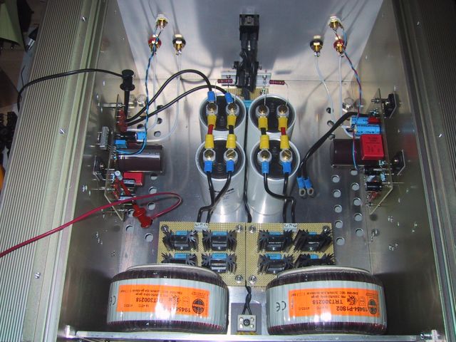

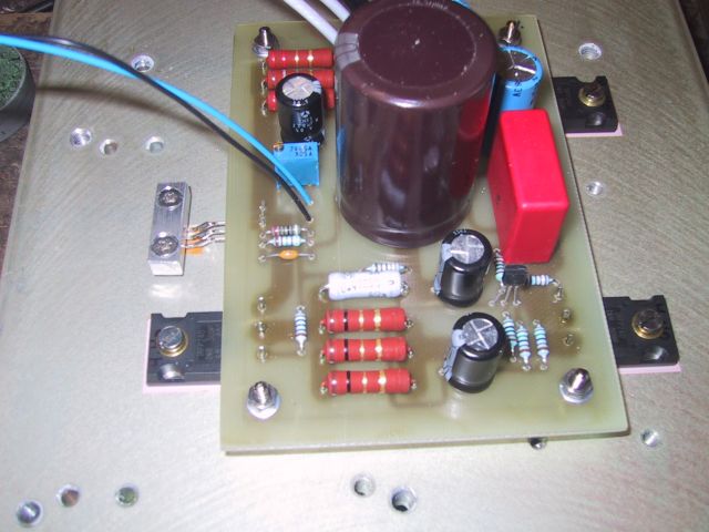

I finished the Zen V9 yesterday. Initial listening sessions, sounds really promising. I think this is the best sounding Zen amp, I have heard yet🙂 I used the PDDA boards, thanks for sharing the layout Peter Daniel and Veteran. Everything went smooth, both channels worked right away. I will note also that the grounding scheme on that layout is just right. There isnt any trace of hum or any other nasty things. Here is a picture of the internals, while adjusting the first channel. The trafos are 2 pcs of 300VA 2x18 volts followed by 2 DIY rectifierboards using 30A Stealth diodes, snuppered with small Rifa's. Smoothing caps are 4x 15.000uF Rifa's. The amplifierboards are like Veterans schematic. I wanted the amp to have the F-amp look, hence the horisontal fins. I am very pleased with the sound of this amp. The top-end is really smooth, detailed and "airy", better than I have heard before from a Zenamp. Thanks Nelson, for giving us this fine circuit 🙂

Congratulations!
Thanks Bas🙂 I am looking forward to hear some of you guys oppinion about this amp, too. I was pretty surprised to realise how good it sounds, even though I expected it to be good, from NP's writings😎

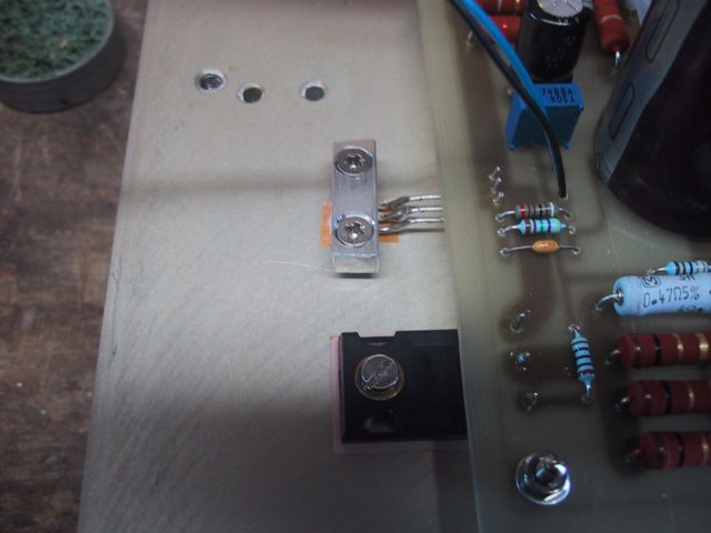

Here is a closeup of the way the J-fets are mounted with the legs extended with solid 1mm copper wire.

Really neat Steen, that case shines as good as a First Watt.😎 😎 😎
An best of all it sounds as it should, best of Zens?
There seem to be other contenders for the title though, Carpenter’s ZV7T. Maybe John will make a ZV9 and report his findings. 🙂

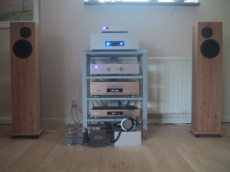

SMathews, I have a pair of DIY Proac Response 2.5 clones. (2.95 actually) I attached a picture of them (a little old). I also have a pair of Proac 1s clones.
Dennis, I etched a pair of boards from the PDF's that Acaudio pointed to. Using 3oz heavy copper pcb material.
Listening to the amp this afternoon, its fantastic🙂
