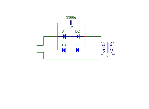

Toroids are very susceptible to crap on the AC line,
particularly DC imposed by lamp dimmer circuits and
such.
Try putting a couple of 10,000 uF caps back to back
(series) on the AC line to the primary to block DC and
see if that doesn't help.

mr. Nelson I agree - if there is DC component - trannie can get "overmagnetized" - don't know the expression - I mean - B(H) charachteristic and stuff conected with all that ...
Series of 10.000uf caps between AC power cord and trannie if I understood you right?? Hmm - what about voltage of such capacitors?? 230V is quite high - I'm not sure if there are some 230V/10.000uF caps ... - I mean - am I missing something here or ... ?!?
till said:10000uF / 63V 4 times in series => 2500uF / 250V ??
Hmm - it can be clearly seen that it has been a long long day - and that I should allready be in bed for at least 2 hours ...
I've mixed up serial and paralel ....
Oh ... I feel so
I feel soooooooo stupid ...
I tried this weekend a DC trap with a 3300uF/25V cap and 4 diodes as in the figure. I noted that when I turned it up it was silent but then the transformer started to hum again.
