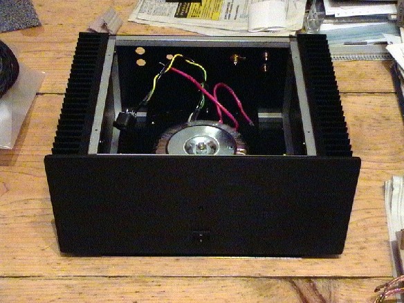

Finaly - after more than 4 months - Zen v4 got it's own home 😀
For today - 'cause it's too late here in SLO - we've stop the final assembly - but I assume tomorow will be the "D-day" ...
But nevertheless - I've allready have some photos - and I'm just so happy I feel I must show them to others!
Thanks for all past and future support to all of you and especially mr. Nelson!

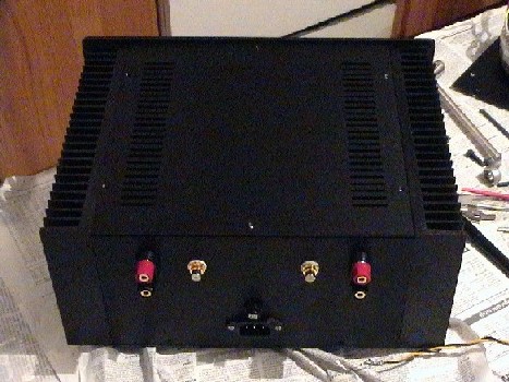

Some figures - the base between heatsinks is (250x250)mm2; heatsinks are Fisher's - HR250 - the height is 145mm - I've got them free of charge - so why not use them ...
The front plate is 5mm thick. Rest plates are 3mm ones ..
Nothing special used "inside" - standard stuff - Elco's are Jamicon; polypropilens are Wima MKS4; resistors standard ones; wiring will be Kimber 4PR ... BUT - the sound seemed quite superb! - when the ampa was tested - so I've decide to supply him with a good chassis .. He deserves it!

Can I ask, how did you get the vents cut into the top plate?
Frank
Stabist,
The amp looks great!
Frank
About those vent holes - they were done by machine.
As a matter of fast - this housing is "No2" - I tried to do the first one all by myself - but it didn't work out OK - so for this one - I decided to "call a help" - a friend of mine is a "machinist" (don't know the right expression) with a very good equiped workshop - and so those holes are a part of his work.

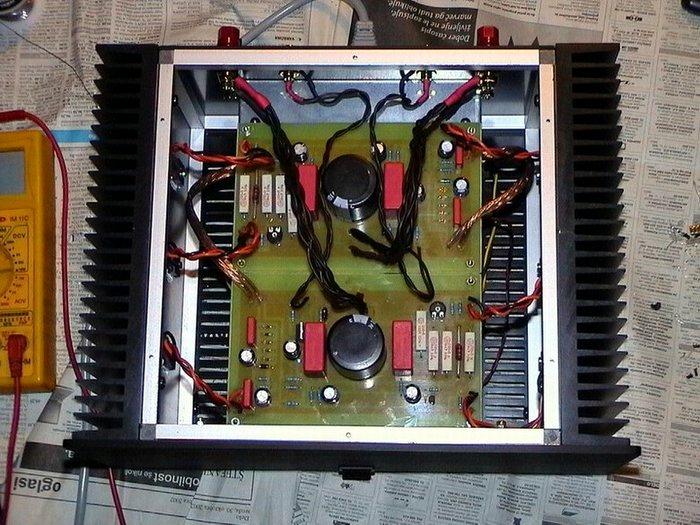

It's realy amaizing have good this chasis looks in reality. These pictures are not very good, I'll made better one today when Stabist and I will finished this 4 months project 🙂 Of course Stabist will send a discription and some photos on PassDIY and I hope so that will be published.
Today Zen V4 will be rewired and tested and then ....

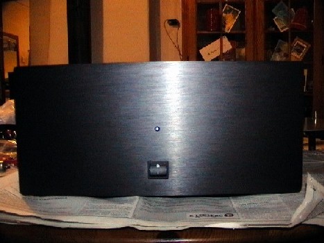

Thanks for encouraging words.
I must admit that it really came up much better looking as I thought at the start 😀
Hehe - yep - the LED is the "catch" for best possible sound 😀 😀

Pictures of finished Zen v4 will follow - but first it must be finished 😉 - I know we've thought that it would allready been done till now - but today's plan changed a lot - we've finnaly got our shipping of irf9620 - for our A5 ... So we decided to make boards for A5 today and Zen will be finished tomorow ...

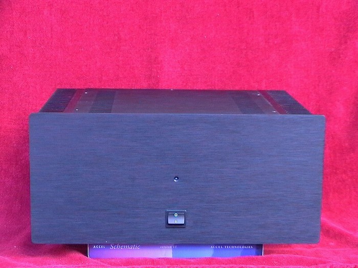

One more photo. Complete "story" and discription with pictures support will be sent to www.passdiy.com.
